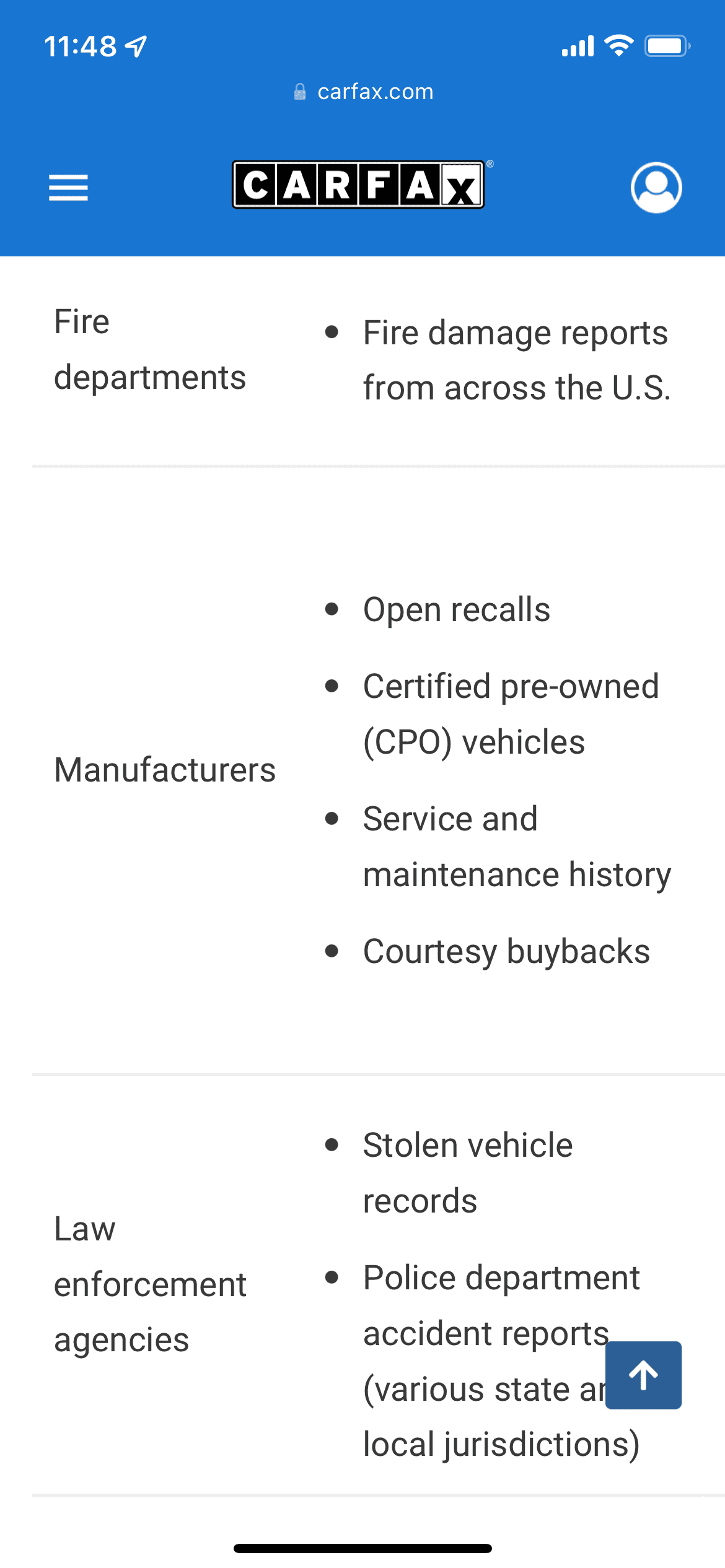

I would like to get a definite and factual answer on that.
Per Carfax:
I would think an engine replacement certainly qualifies as service history.
There’s absolutely nothing I can find on the Carfax website that indicates “warranty work” is not included in records history. Show me that and you’ll have me a little more satisfied

Some of you guys are gonna be real surprised when your engine replacement shows up on Carfax. “ But wait, the people on the forum said it wouldn’t show up”. Try taking that to the bank.
Aside from Carfax it will be in Ford’s network maintenance records. I could probably take it to any dealership in the United States to trade it in to which they have access to its history.
