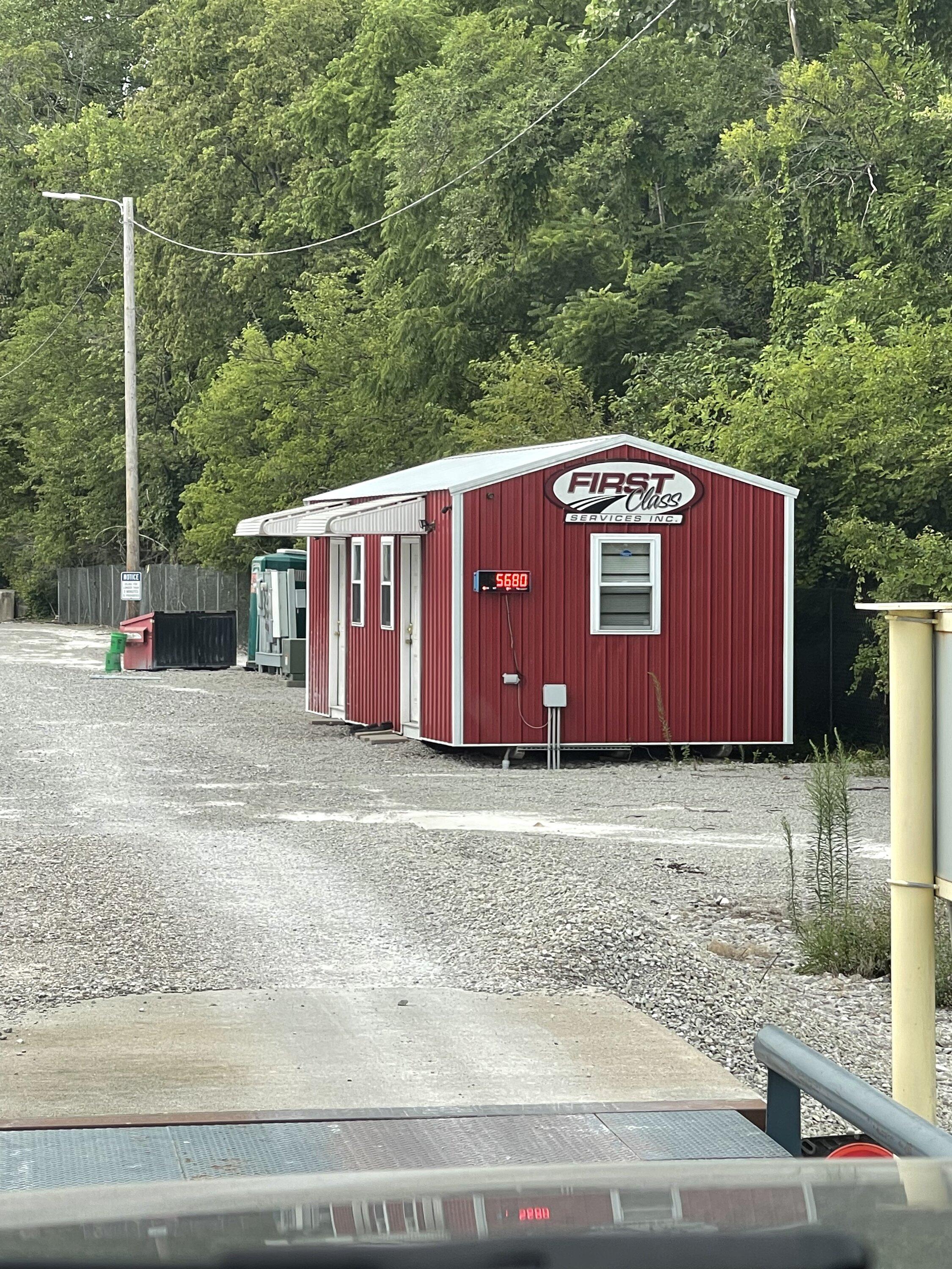

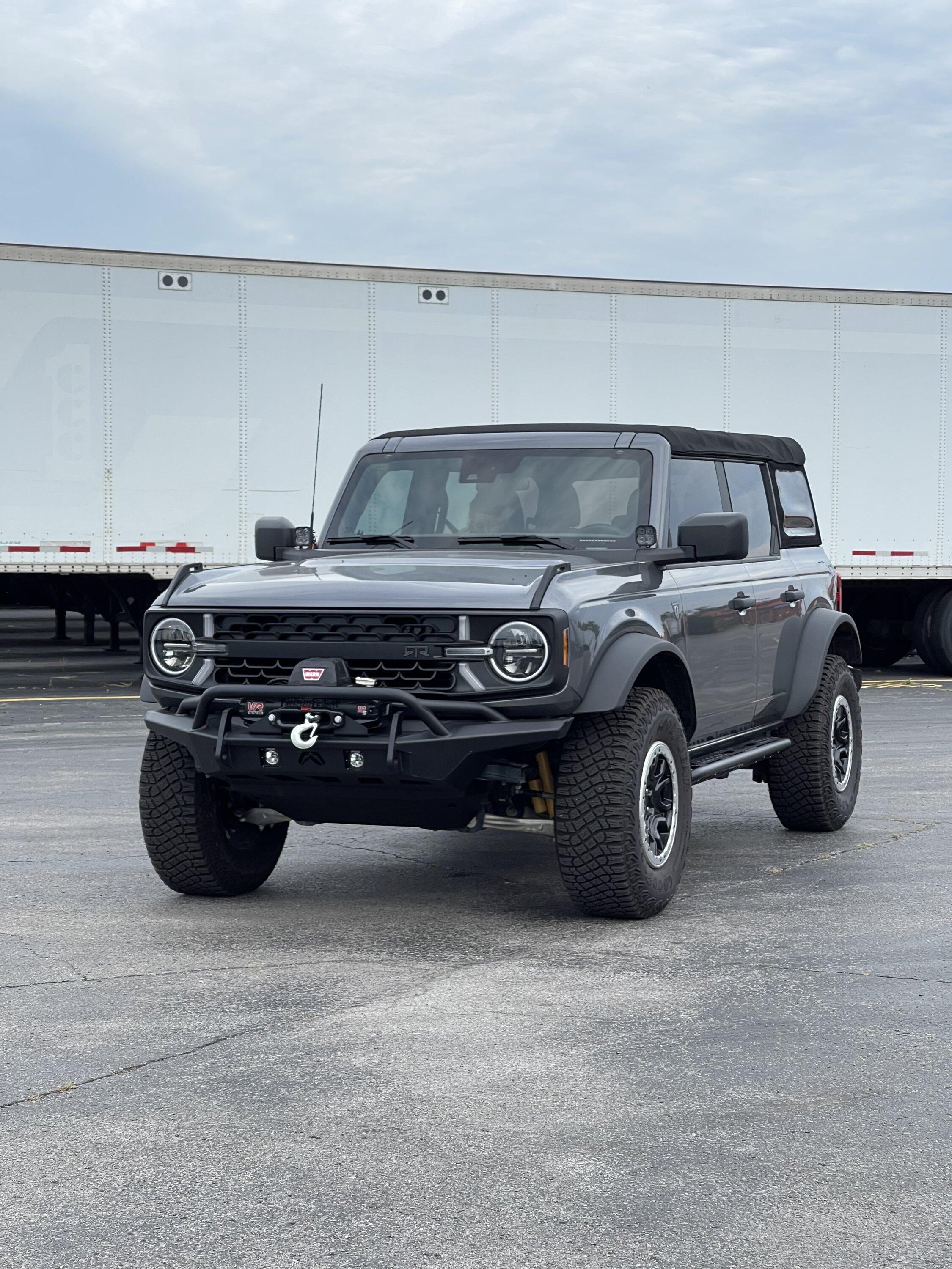

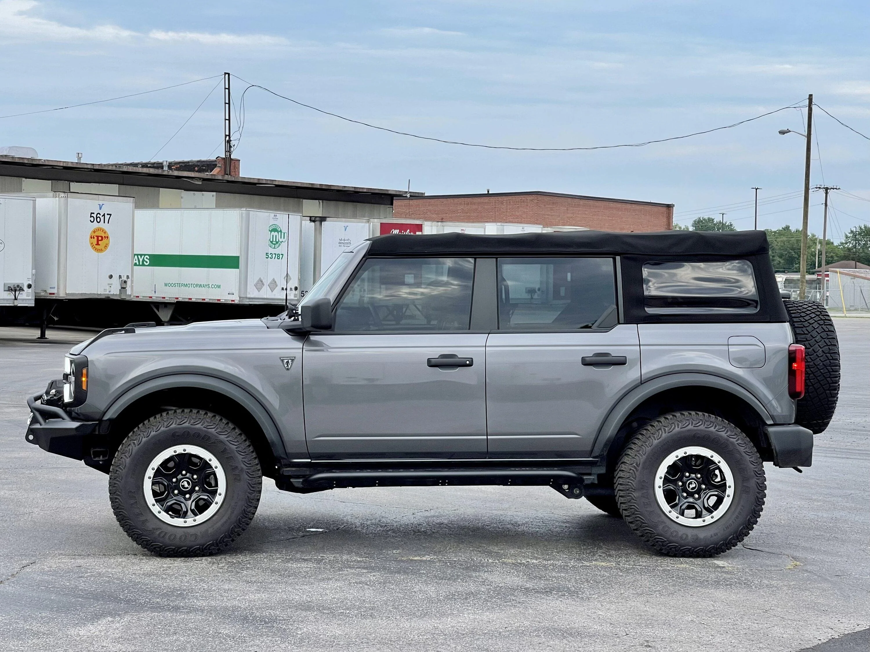

Here’s the 1.25 perch collars from wildhorses4x4.com. It’ll hold me over for now I should of measured first but I think I got 1” back and it did firm up the ride just enough that I don’t feel the weight on the nose much feels way better. I’ve only driven it about 6 miles and need to get off road and see how much more I hit the bump stops to know if I’m going to keep it or not. I do still plan to find someone who has the right equipment that’s not going to charge a arm and leg to install those OME coils. That’s the proper way it’s ashame I couldn’t get them on.
Last pic is my gross weight with almost a full tank and 2 adults.
