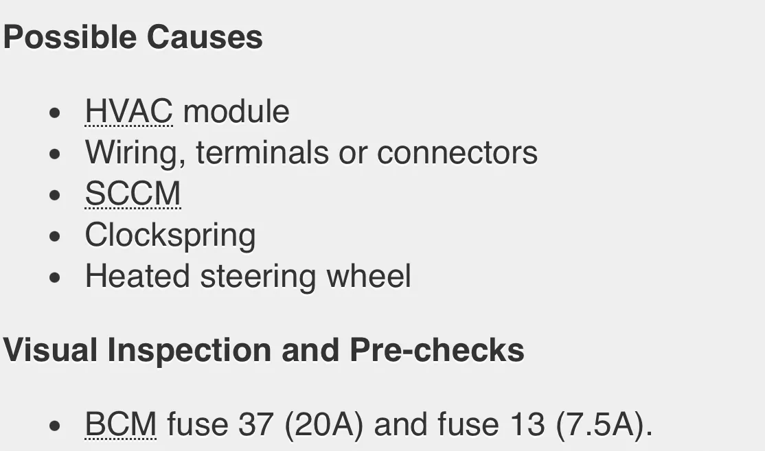

Anybody else had this happen or have any ideas?
Fuse?
It used to work and has stopped recently. The light says it is on, but nothing.
Honestly not a big deal in NC most of the year, but would like to get it fixed if it's something simple.
Ducati1098
10,021
23,306
Midwest
Fuse?
Difficult to say without diagnosis really. SCCM fuses would likely have other issues associated with it, but you can check them.
Ford Bronco Heated Steering Wheel NOT WORKING IMG_9620

Ours doesn't work at all either. Dealer diagnosed it and confirmed it wasn't operating. Turns out to be one of the control modules. Have an appointment to have it fixed next week. Sure would be nice to have it in these -20° F temps we have been experiencing.

Ours turned out to be the clock spring and the element.
