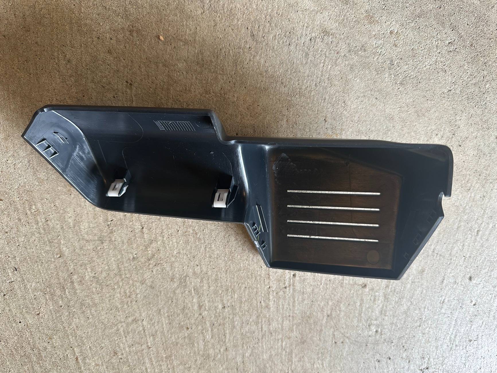

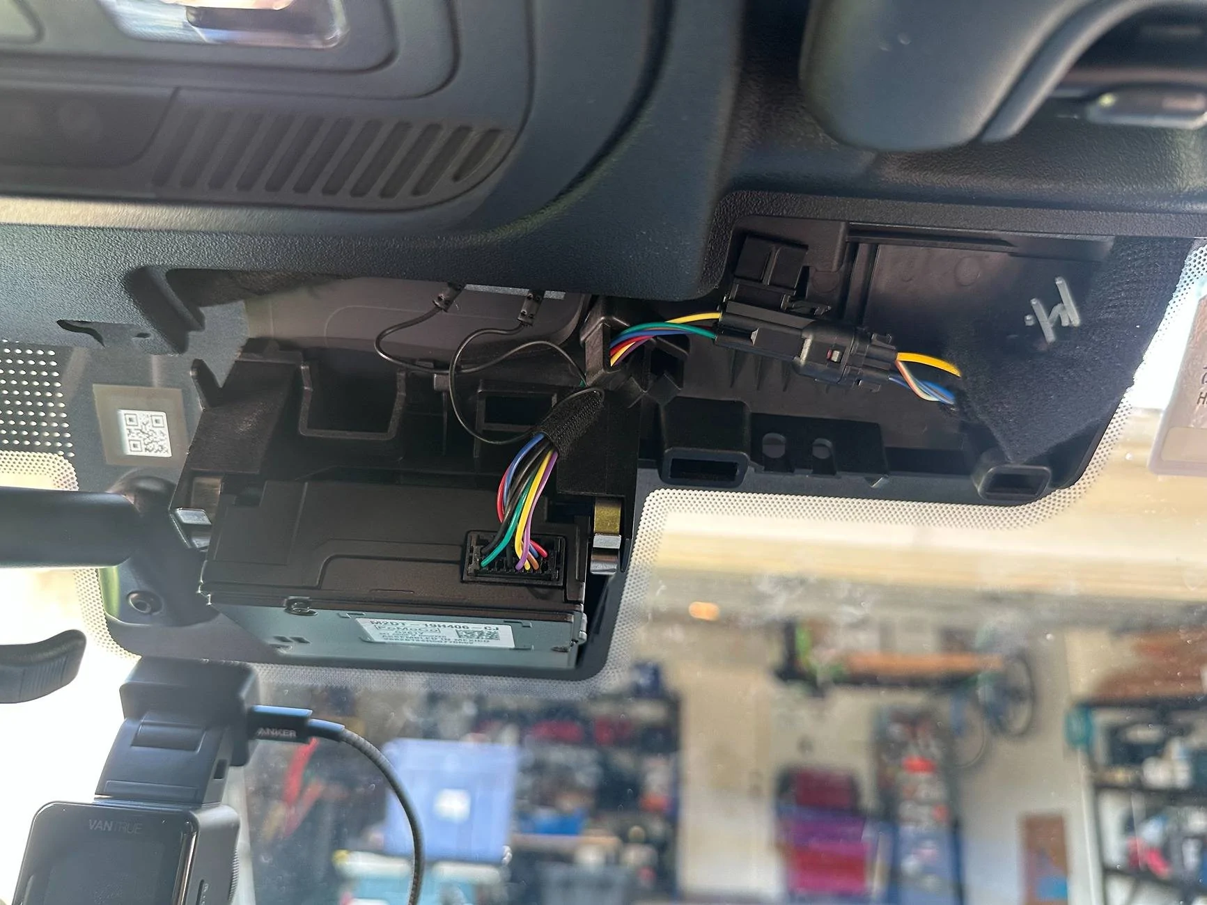

It's on there pretty good but I had some free time this weekend and opened it up. The additional part on the side is just a plastic holder for the cable. Pretty anticlimactic. I did get to cleanup the little defroster cables (I think) that were hanging out of it and annoying me.
Can't tell if a cable for the rearview mirror is preran or not, didn't have time or desire to tear apart the whole upper windshield trim to look. Big Bend /w Black Diamon Package for reference.
