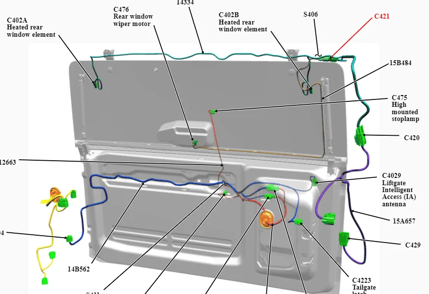

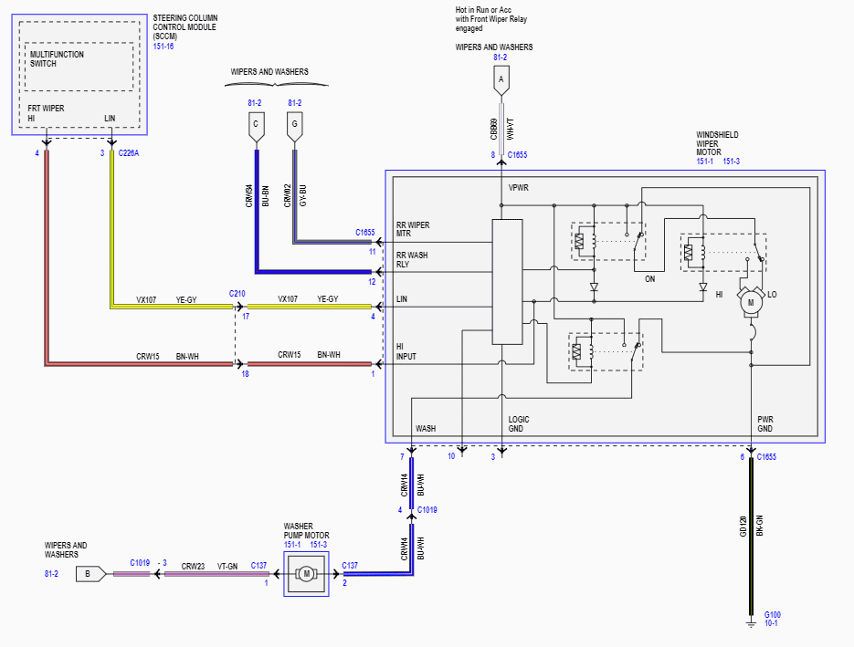

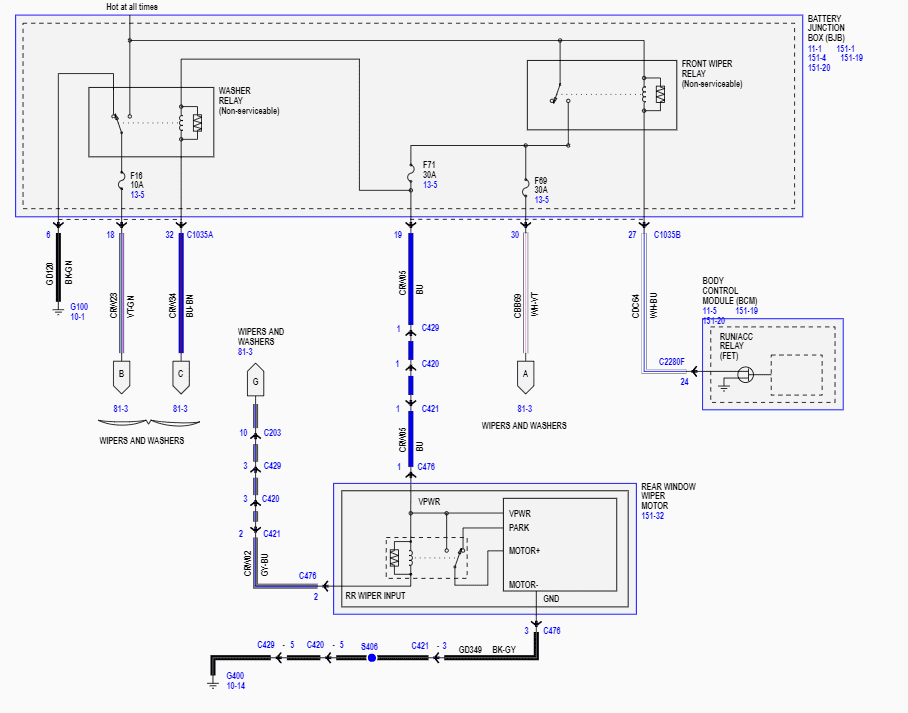

Was reading thread and looked in the wiring diagram to see if it differentiated between soft and hard tops which it doesn't. From what I can see it looks like the wiring will be back there.
Ford Bronco Hard top - rear electronics 1620994602992
Ford Bronco Hard top - rear electronics 1620994832654
Ford Bronco Hard top - rear electronics 1620994978708
Questions that will need to be answered. Will the steering column control module be configured the same for hard and soft tops? Will the wiper/turn signal switch be the same for both even if it came with soft top? If hard top is added later, will it be as simple as a short section of wiring for heated glass/wiper washer and run a washer hose if desired?
Looking at the diagram it looks like most of the electrical connections/functions are or should be there. Ford could modify these at some point if there is a difference between soft and hard but my initial thought is it's possible based on what I'm seeing. The big items are switch? Ability to turn on rear wipe/wash in SCCM through IDS/FDRS/Forscan and washer hose or washer pump.
To be fair, I used the VIN from a 4 door soft top FE to pull the diagram. They are the same for a 2 door soft top and 4 door hard top. If they didn't make this a simple plug and play for hard top, someone needs to take the walk of shame from GOT.
