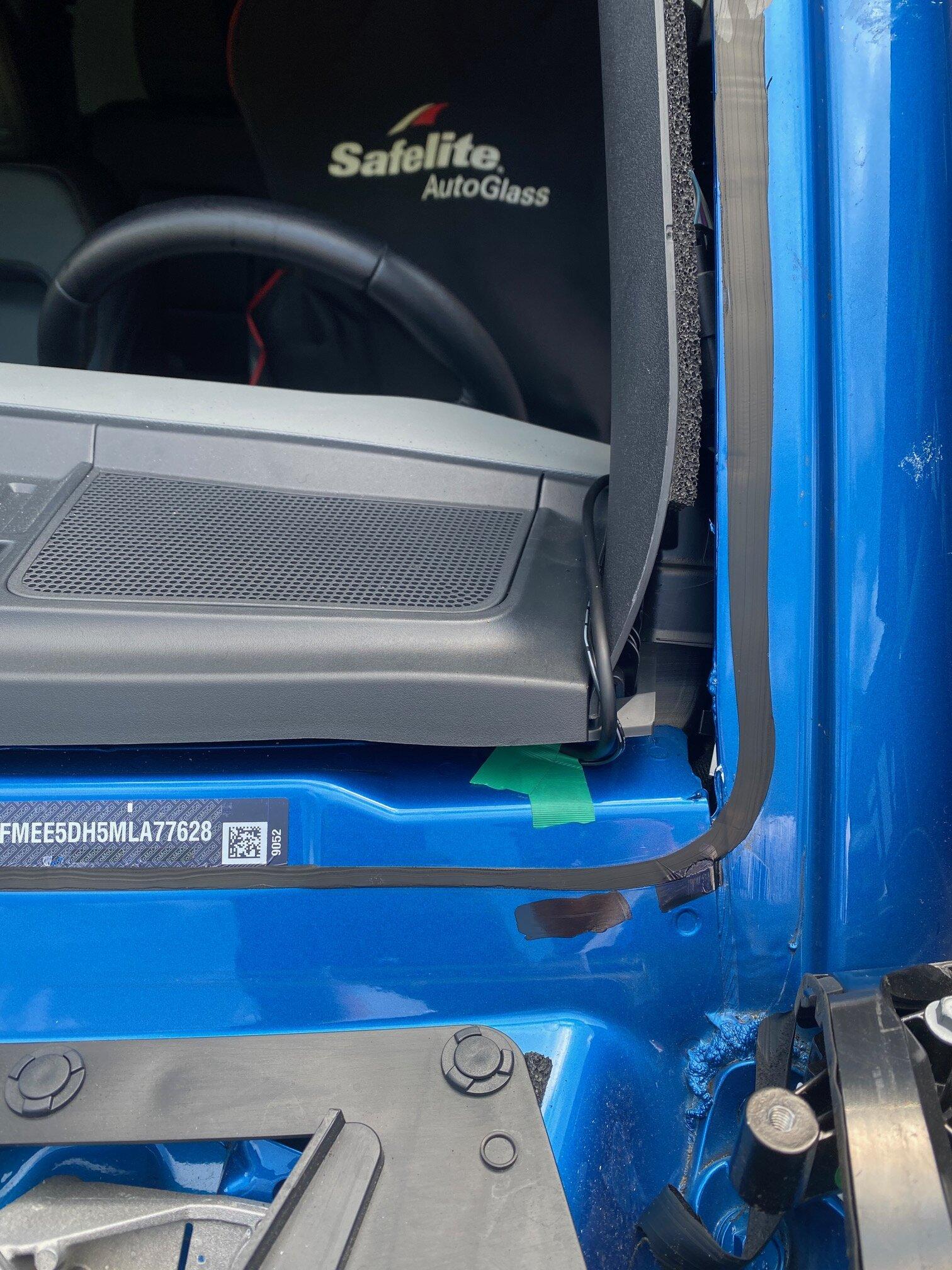

I'm wondering about the wire routing for how you setup the head unit and speaker below:
Looks like you ran the cables along the bottom of the windshield, over to the a-pillar and went down from there towards the door trim -- is that correct?

Thanks! Yes, along the base of the windshield (simply push it under the foam that fills the gap to the dashboard). I couldn't find a passage from there to under the dash, so just ran it around the base of the A pillar. From there I removed the handle and side trim and that gives access under the dash.
When my windshield was replaced (the 1st of 2...) I was able to evaluate the cable run, and I saw nothing that suggested a better way.

just a thought, but I think you can route your cables through here if you don’t mind cutting a notch for pass through in this little trim that would be hidden by your accessory rail

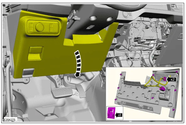

Hey, Dennis. No issues in ~7 months. No tools required - it just pivots down once the clips disengage. The clips are loud, but once you've done it once, it's trivial. In this pic from the service manual, all those purple spots on the back are the clips. I grab just to the left of the column and pull sharply toward the seat (not so much pulling down).
I know I am late to this but we just got our Bronco. How much steering wheel up/down adjustment range is lost? I normally have it full up but my bride typically has it lowered as far as it will go. Thank you for your time.
Zero change. The close edge is behind that rubber strip and the panel falls away from the radio from there, leaving plenty of room.
