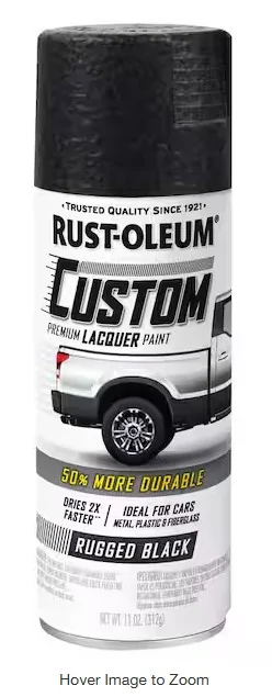

Yeah maybe look into some thinner coating options. I like this stuff, subtle texture and not too thick.
Ford Bronco Grill removal Screenshot 2024-11-09 184110

I can have them mask where fitment will be an issue. Thank you for mentioning that. I will make note of any place that a thick coating can be a problem. I am sure they can tailor the thickness for the application too.
I have 22 years experience with the durability of Line-X and would like to use it if possible. Rhino liner would probably be OK too but it is not quite as hard as Line-X. I have already talked with a Line-X applicator and they seem confident that they can apply a smoother texture that would be closer to the bumper texture.
