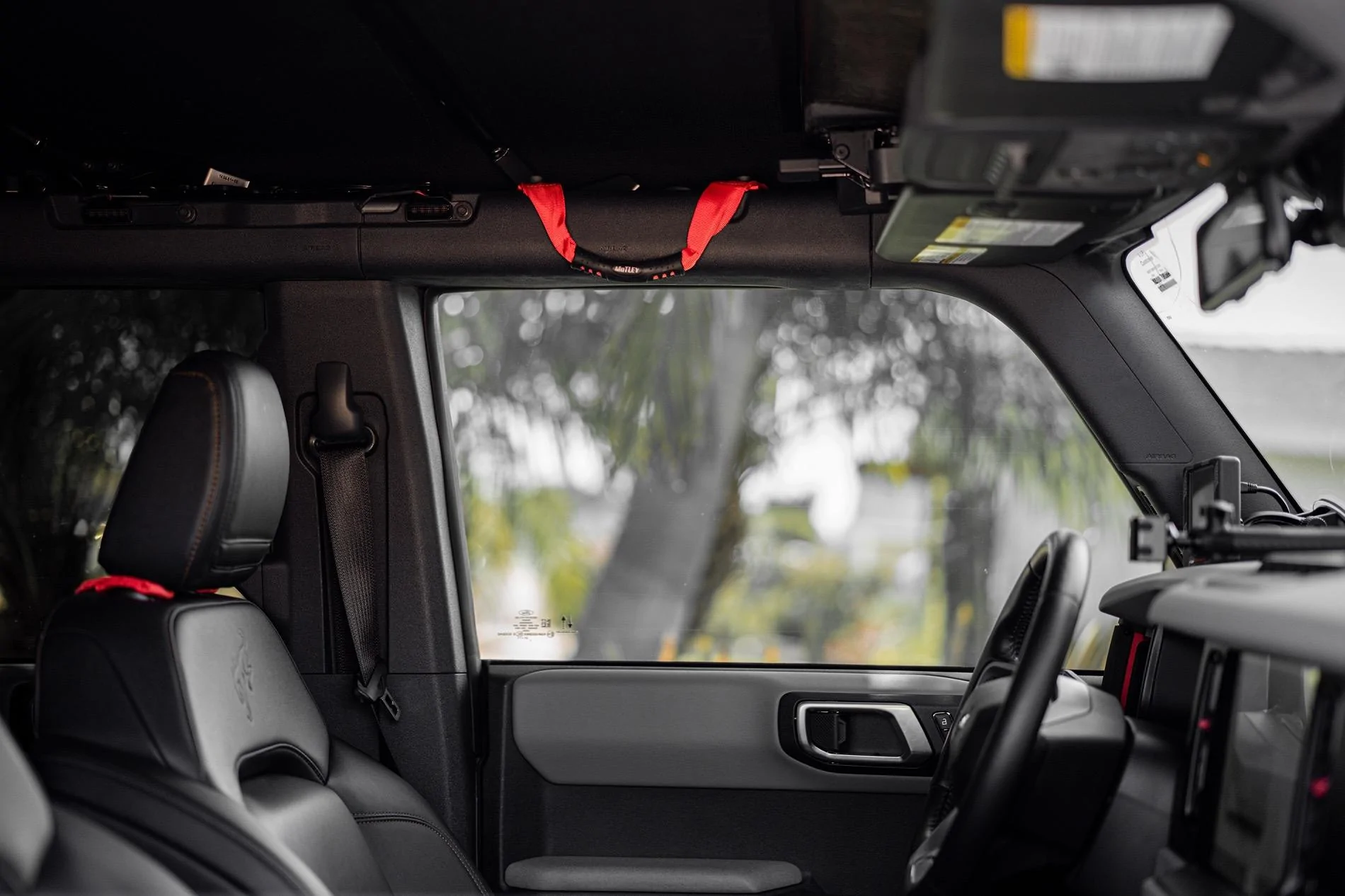

Picked up some Motley grab handles this week. The Mabett interior lights kinda interfered since they both use the same bolt. I ended up putting two M10 nutserts into two of the open holes in the roll bar. Ended up working perfect and keeps them tucked up higher so they don’t swing back and forth.
What M10 nutsert material do you recommend? Stainless, zinc etc. Do you recommend a certain rivet tool? This looks like a clean and more secure install than the existing bolts.
I used this kit from Amazon. Had it from some previous work and used the included zinc plated nutserts. Hoping the zinc helps reduce any chance of rust. Definitely feels more secure than the existing bolts.
