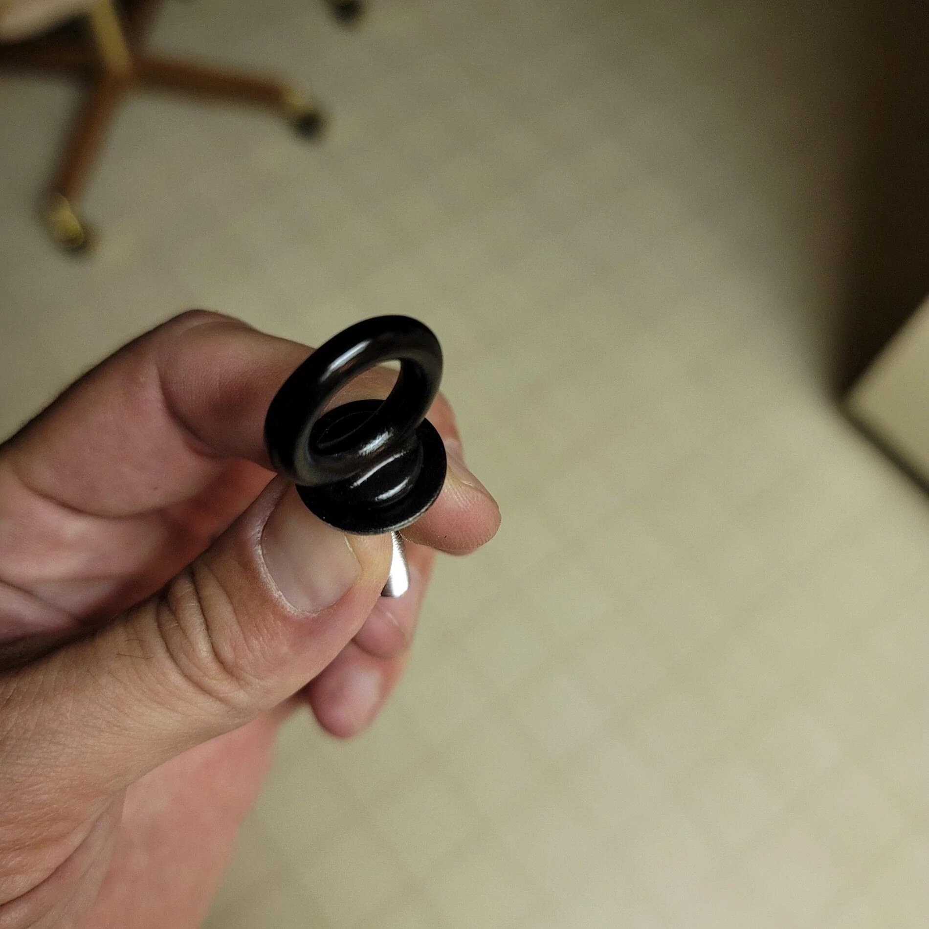

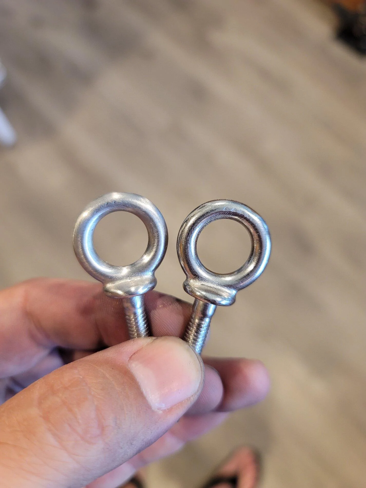

Rather than try to make the rubber handle/nylon webbing aftermarket grabs with mounting tabs work with the factory hex bolts (cap screws maybe if you're a hardware nerd) I decided to swap them with eyebolts and tie up my own paracord grabs between them.
The bolts are M6 and available on that big jungle Chinese-import-peddling site. I trimmed them to exact length with cutoff wheel (poking bolts too far into the roll frame at these locations is a BAD idea for multiple reasons, primarily that I don't know exactly where airbag modules or wiring live inside). Picked up I think 3/4 or 1" fender washers and drilled them out just slightly to fully seat on the eyebolt shoulders. Also roughed them up with 220grit and painted them semigloss black to hide.

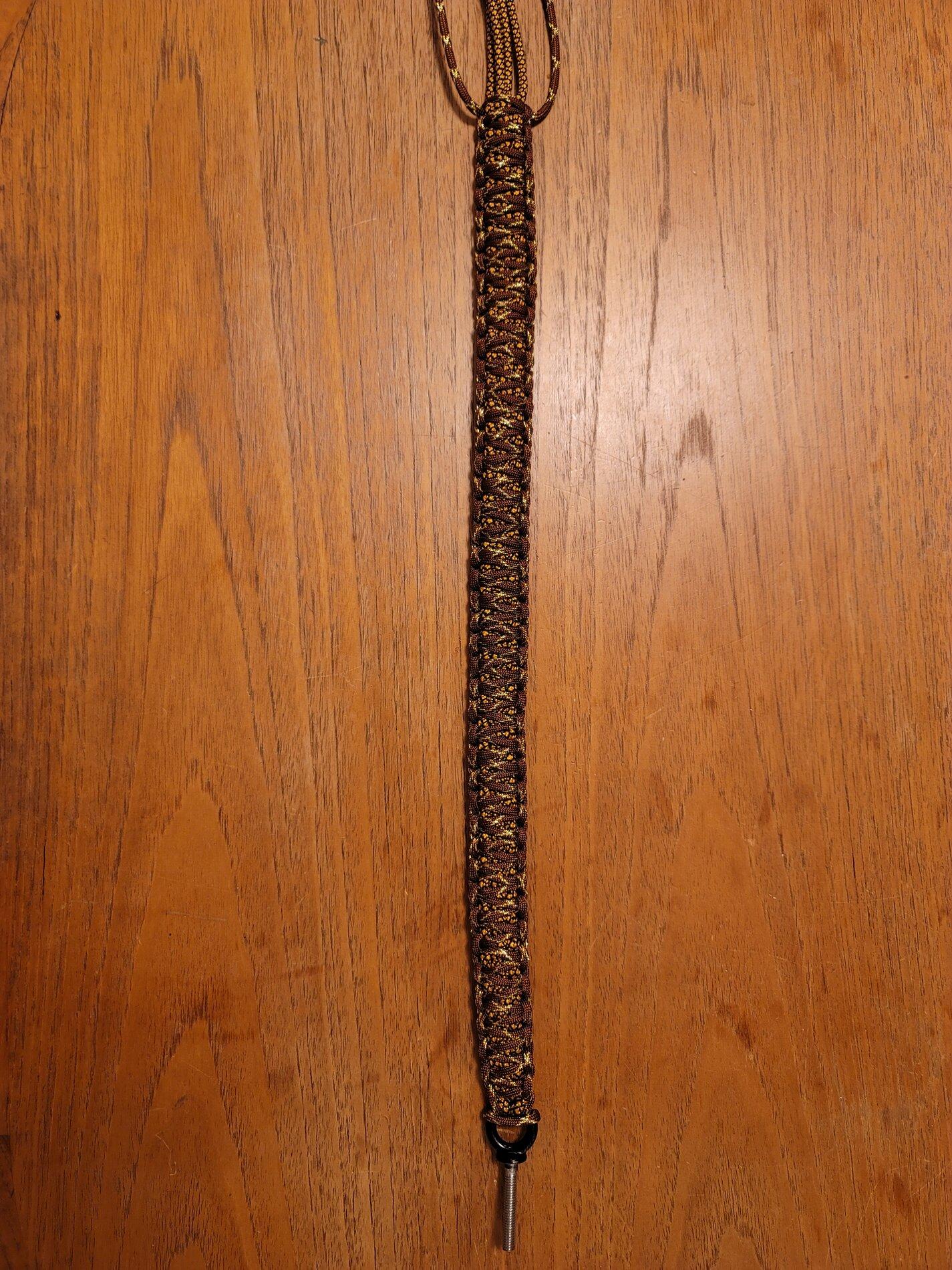

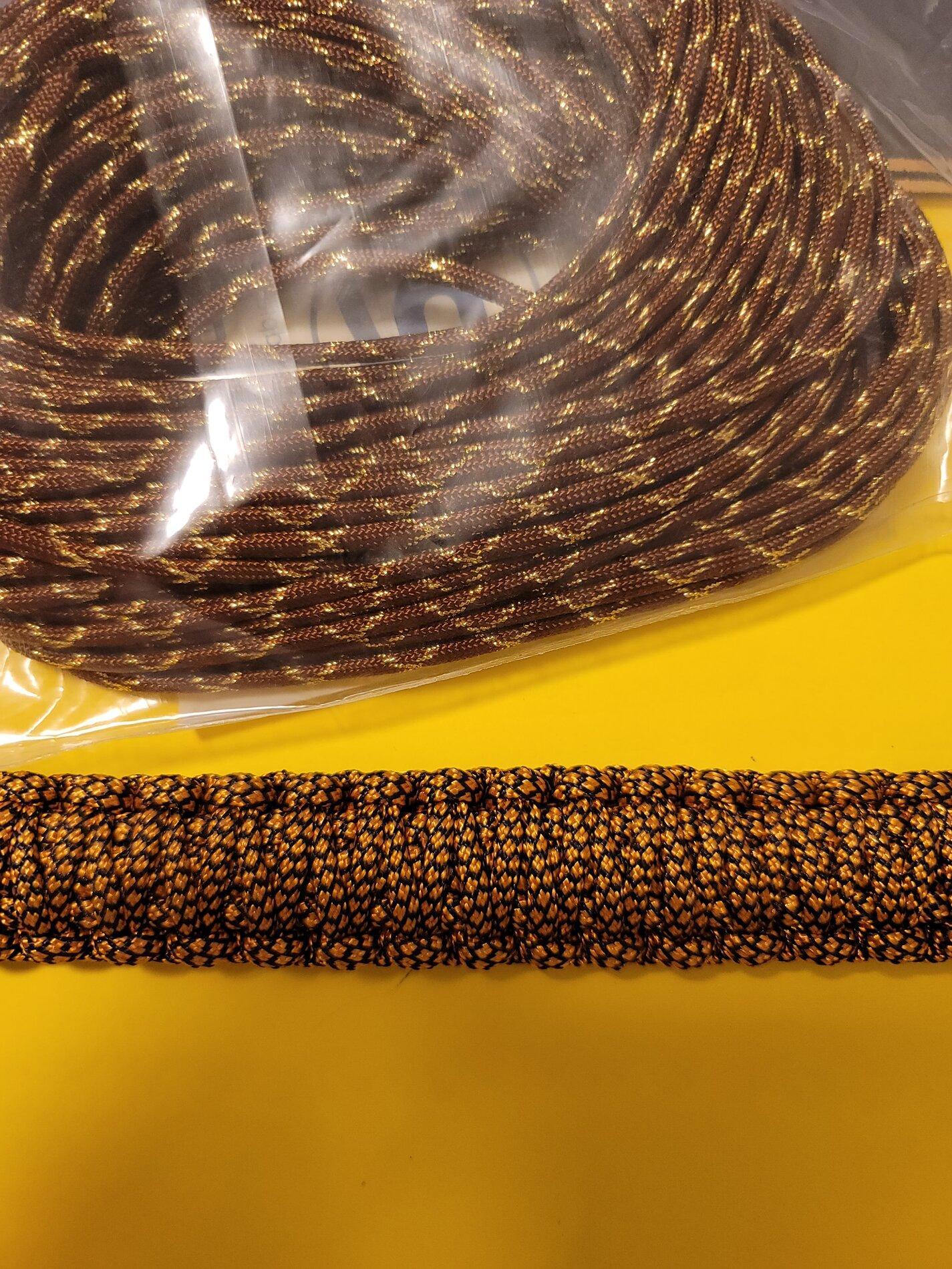

I went with the 'King cobra' paracord pattern (youtube) which is really just a double up of the standard cobra pattern ran back over itself to make the grab fatter. Tied up 90 'stitches' on the core to get the 'droop' I was after.
Played around with colors that I thought would combine to coordinate with my bronze wheels but not sure I pulled that off.

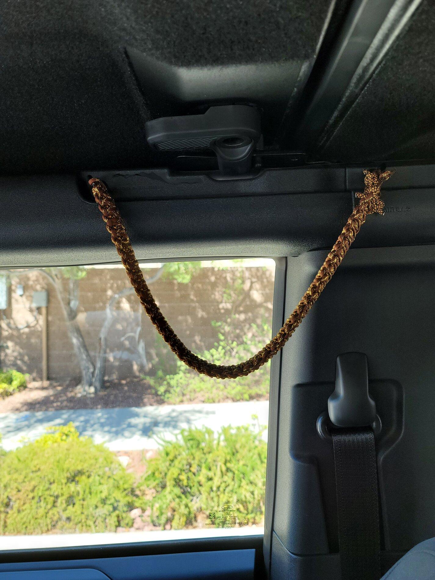

Installed eyebolts to hand tight plus between 1/2 to 1 full turn until angled toward the droop of the grab.
Tied loose ends to other eyebolt with bowline knots - any knot gurus with better recommendation on this choice, I'd appreciate the comments!
