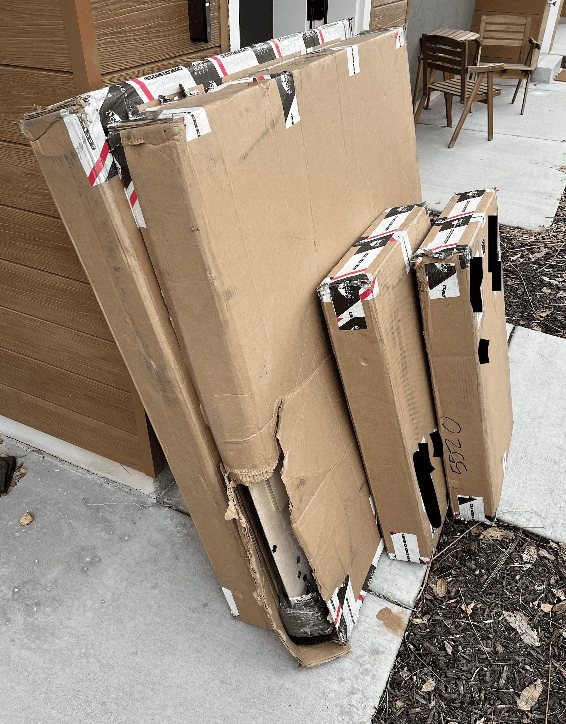

1) The packages arrived damaged. See picture 1. The content is not damaged but the hardware and keys are missing for the platform that was in the damaged box.

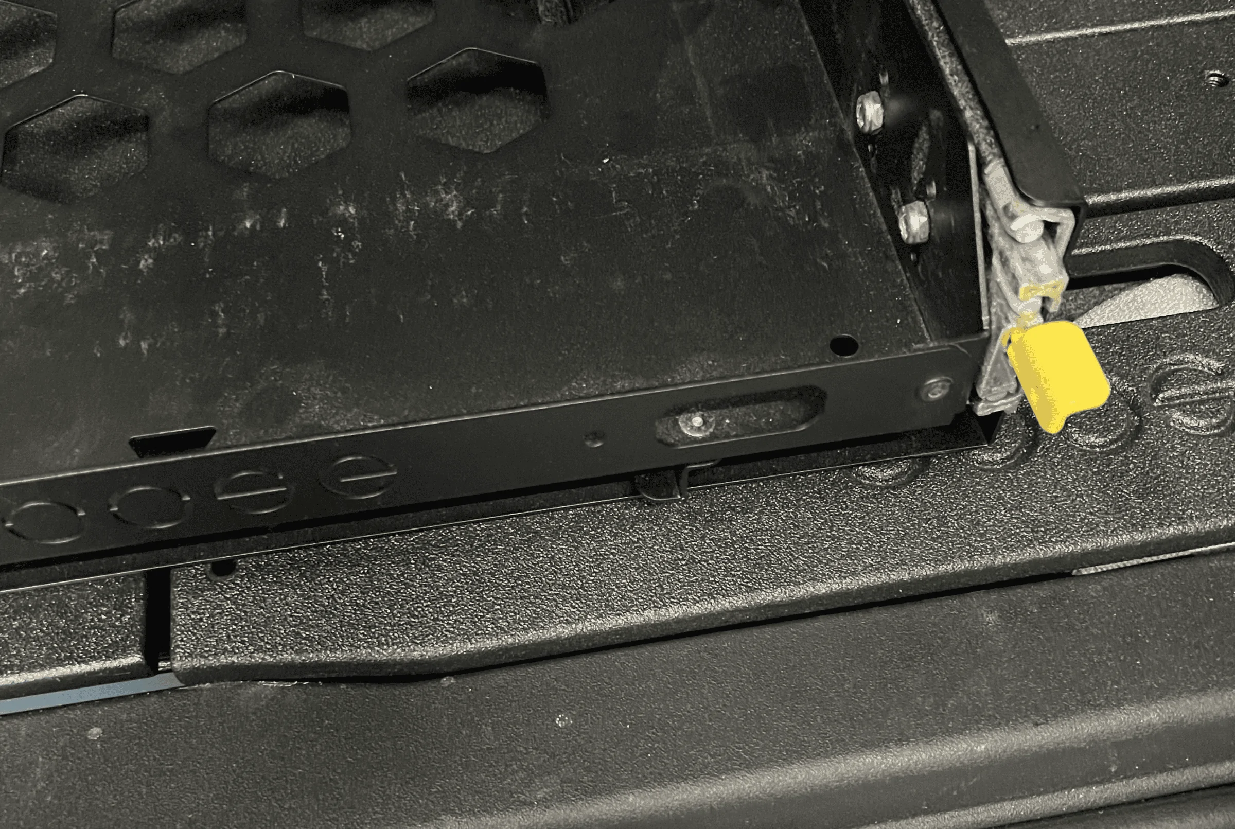

2) Upon opening both platforms boxes, we realized they are different. One platform has reinforced pieces of wood but the other platform does not have that. The one that is missing those reinforcements is the platform that was in the non opened, non damaged box so it came like this from the factory. See 2nd picture that shows the difference

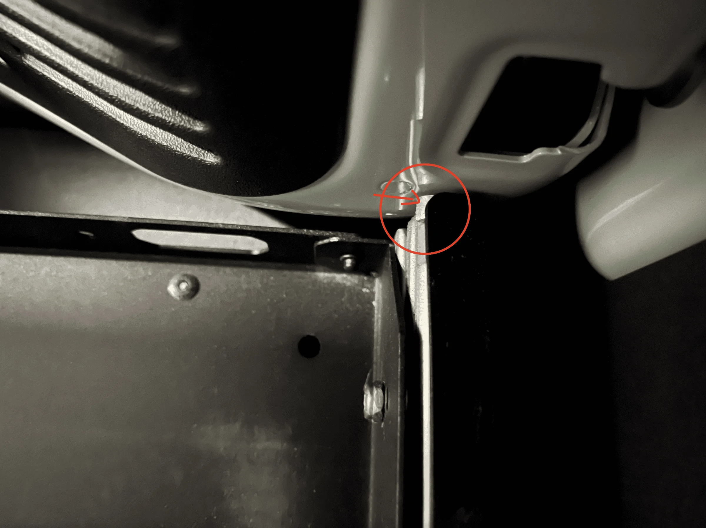

3) after installing the first platform with the only set of hardware we received, we installed the fridge slide on it. It’s impossible to close the door of the Bronco because there is not enough clearance and the Bronco tailgate will hit the fridge slide (with no fridge on it). See picture 3.

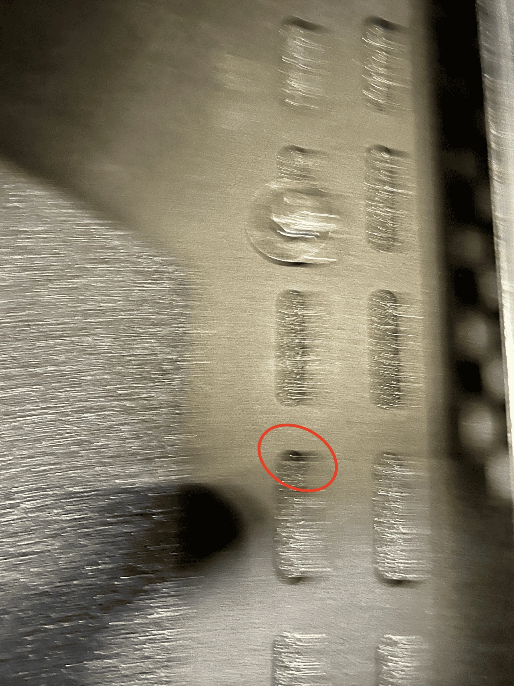

It is possible to push the fridge slide a little more so it’s flush with the rear seats, but in that case, the holes of the platform are covered by the slide metal in such a way that only 4 holes are accessible in total (see picture 4). It’s impossible to line-up everything so that the slide is pushed back enough for the door to clear, and that the 8 platform holes are not covered.
Moving the fridge slide 1 row sideway to the right does not help and it still interferes with the door.
The only way to make the product usable would be:
- use only 4 screws, which is probably a risk for the wood with a fully loaded fridge and the reason why Goose included 8 screws.
- drill additional holes in the metal of the slide so all of the 8 holes on the platform are accessible.

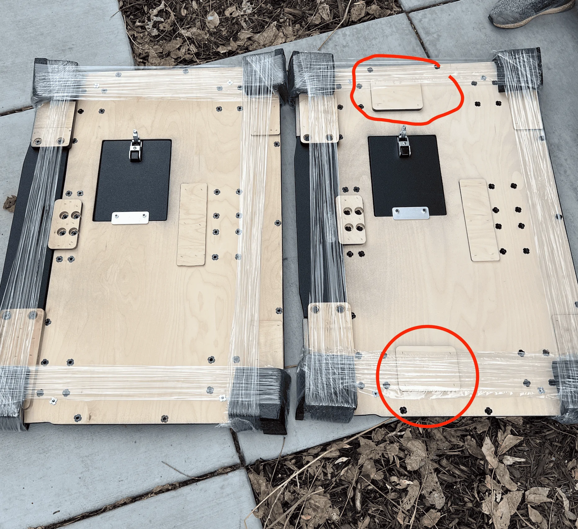

4) The fridge slide covers the Jack cover. Back in November, Goose Gear confirmed via e-mail that the jack compartment would still be accessible with the fridge slide on as long as the screws of the cover are removed before hand. The compartment is not accessible, it’s impossible to remove the cover with the fridge slide on even with all four screws removed. See picture 5.
