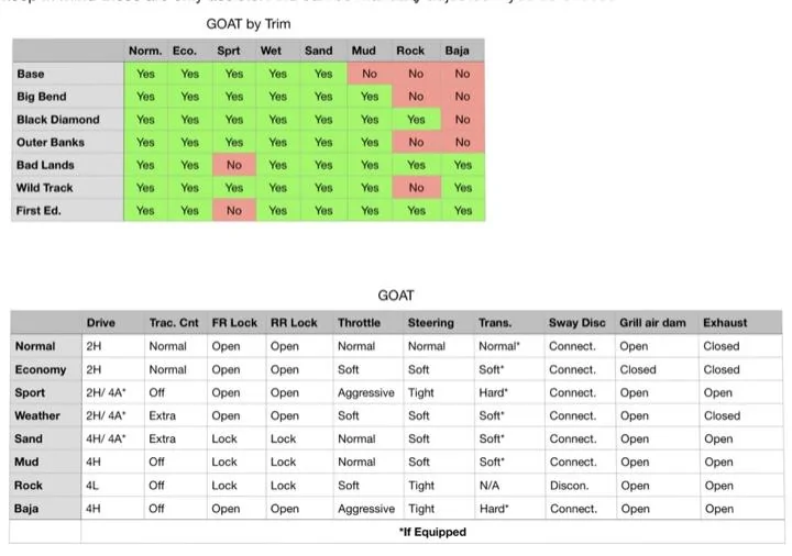

Here is a guess on the various GOAT modes. Following this logic there would be a handful of modes that would normally default to 2H, but if you have the advanced transfer case, would work in 4A.
This is *not* confirmed by Ford... only an example as to what *might* be the case.

Just noticed in the bottom grid for "Rock" is that the sway bar is "Disconnected". I am guessing that, since there is no "*" that the "Disconnected" is actually disconnected? Or could that bel a false positive? Meaning that the "Rock" mode doesn't touch the sway bar unless you are in a BL. I could see both sides of that argument. Just something I finally noticed while determining that "Rock" would also be my "Log pulling" GOAT mode. :alien: :alien:

That chart is just something someone made up back in July. It's not official and some of those things may not even be available on any Bronco (Adaptive steering and exhaust have never been mentioned, for example).
People should stop posting it.

Without 4A, or rear locker, most of that chart won't really be applicable. I'm guessing that maybe it will be 2H as default pavement modes, 4H for OR, and 4L for rock crawling.

Dude. I'm right here... I can hear you.
