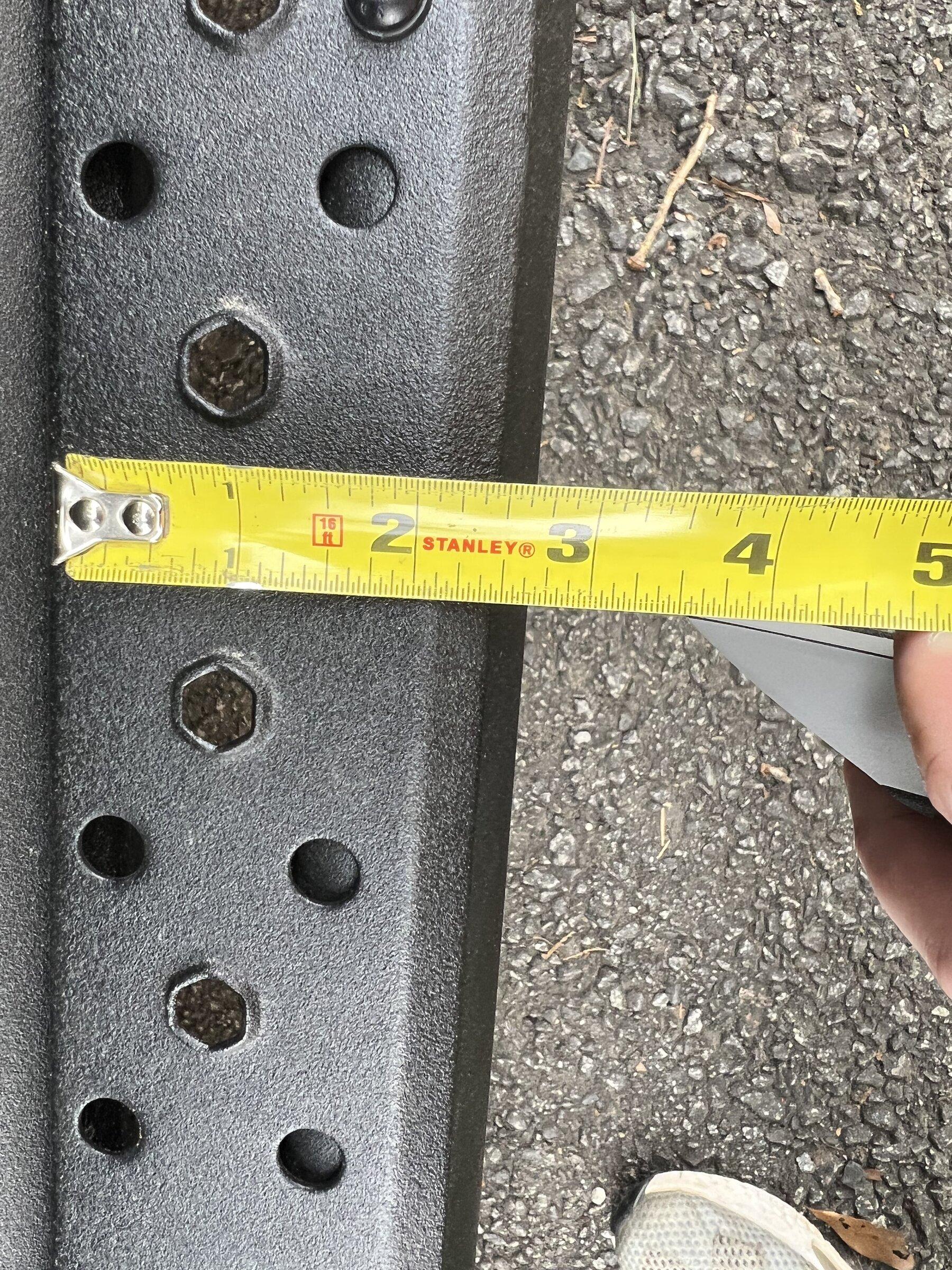

I’ll take an actual measurement but the DSS is supposed to be a 3.5” stepping surface. (The DS model is 2.5”)

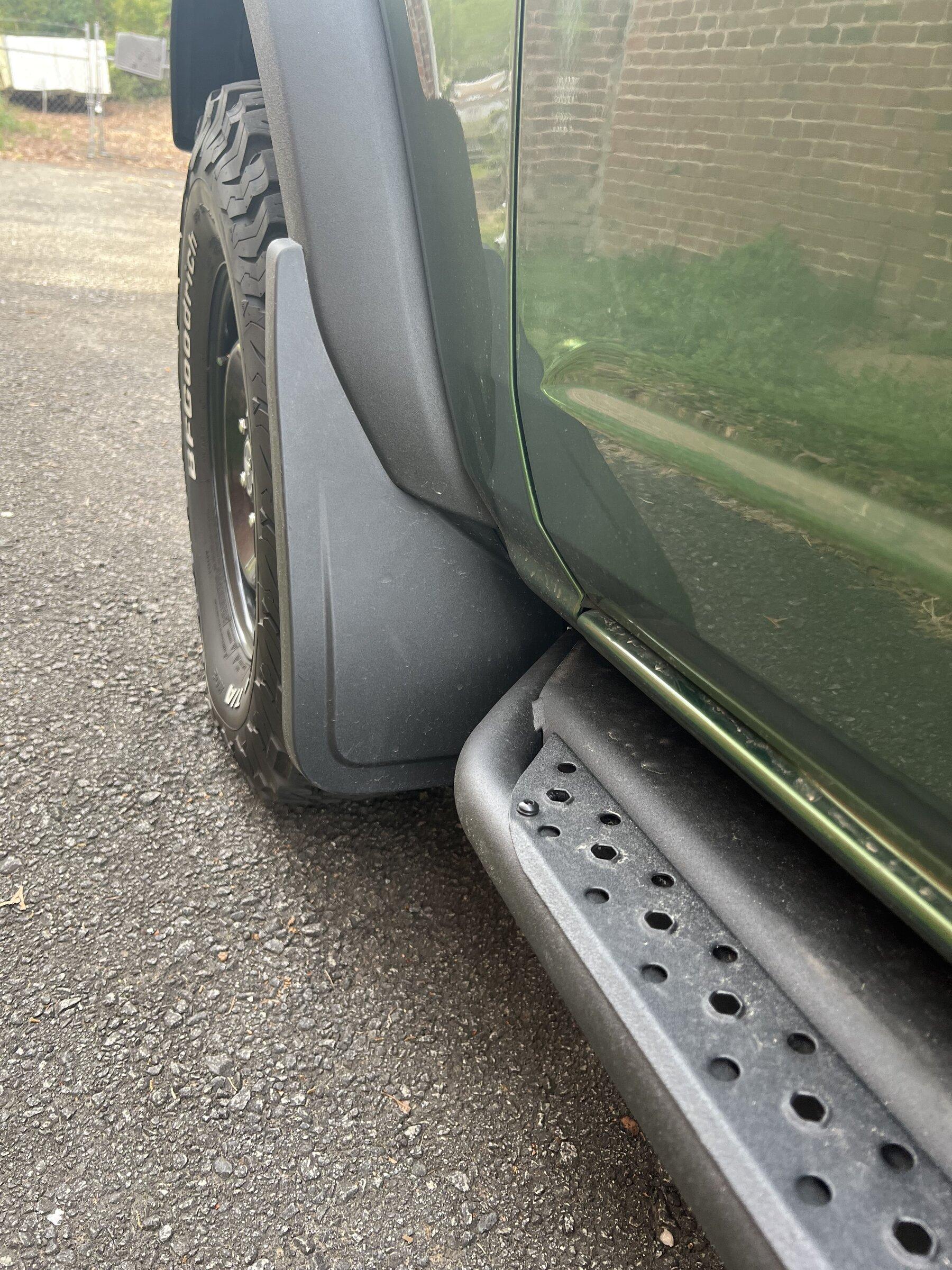

These look great and appear to be a good match for non-sas. How wide is the actual stepping surface, that's not underneath the door sill area? Is it 3.5" wide? Also, does it look like the cheap version of the Ford mud flaps would fit with the DSS? Thanks.

Yea it’s a 2.5” stepping surface
And those mud flaps definitely fit bc I put them on !

They look great. Do you think the width is enough to securely get your feet on them when getting in and out? From the pics and going by the 2.5" it seems like it's at the cusp. Also, did you have to drill anything to install the mud flaps? Thanks for insight as it's tough to make decisions without getting to see anything in person.

I think it’s plenty wide to step on. More than enough
the flaps call for drilling two holes in the fender that you then put plastic clips in but I skipped that step
to me the clips that hold It onto the fender plus the screw are enough

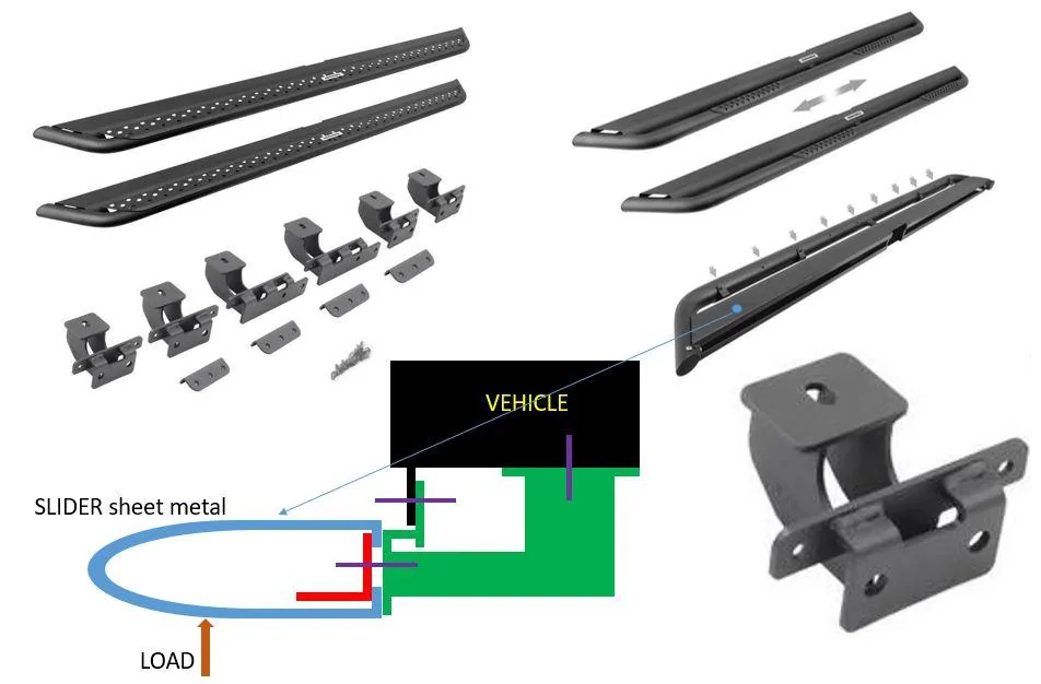

Don't get me wrong, these Go Rhino are my fav steps but as a true "rock slider" I'm just not sure the input load on the sheet metal could handle the load. I think the fasteners in the body are built to take the load, but you gotta transfer the load from the sheet metal into the angle bracket thru the first fastener and so on.
