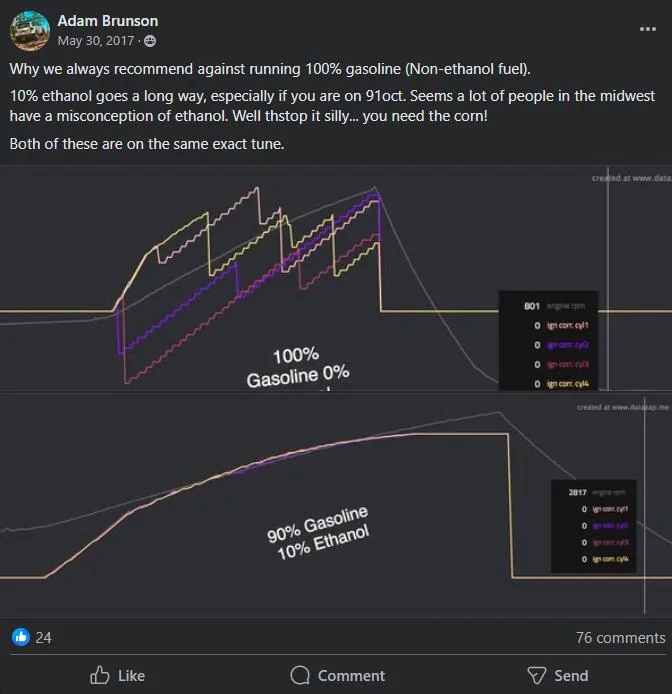

Seems like in the long run it could.
Here is the screenshot of the post. He is dealing with the Focus RS & ST cars. He says that non ethanol fuel causes more ignition corrections aka knock, as to where the fuel with 10% didn't cause any knock at all.
I fail to see how that’s going to hurt anything in the long run. Regular small knock corrections are normal. It’s doing exactly what it was designed to do. It’s not like it’s past the point of controlling it.
Will it run as good? Maybe not if you’re consistently beating on it. For regular driving you’d never notice a difference. It’s certainly not going to hurt the engine.
Ill keep running 87 in my Bronco. I'm not worried about non ethanol fuels. I'm not gonna go out of my way to find it or spend the extra money. I beat the crap out of my RS, Bronco and my old Ranger. gas is the least of my concern as long as its not contaminated or watered down.
I’m not trying to convince anyone to switch to non ethanol gas, I run E85 in my bronco lol
I’m just saying that using non-ethanol 87 isn’t going to harm the engine whatsoever.
