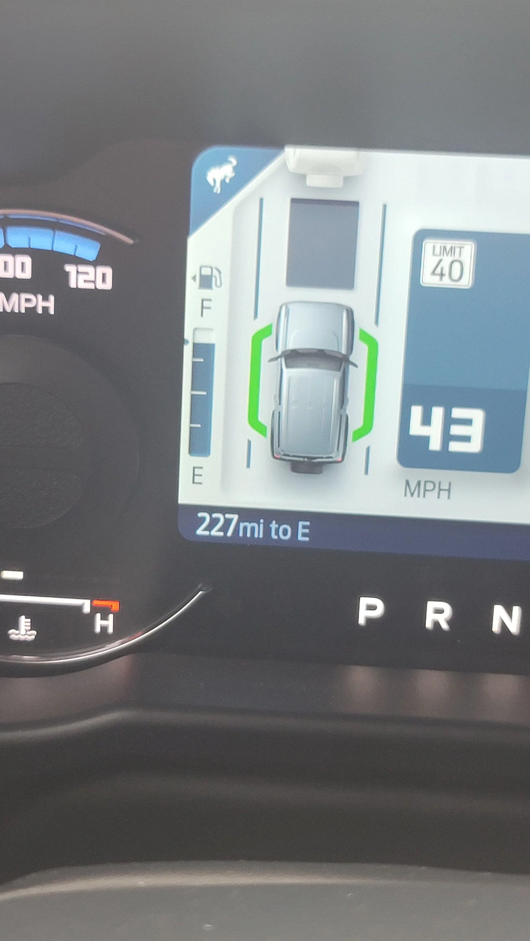

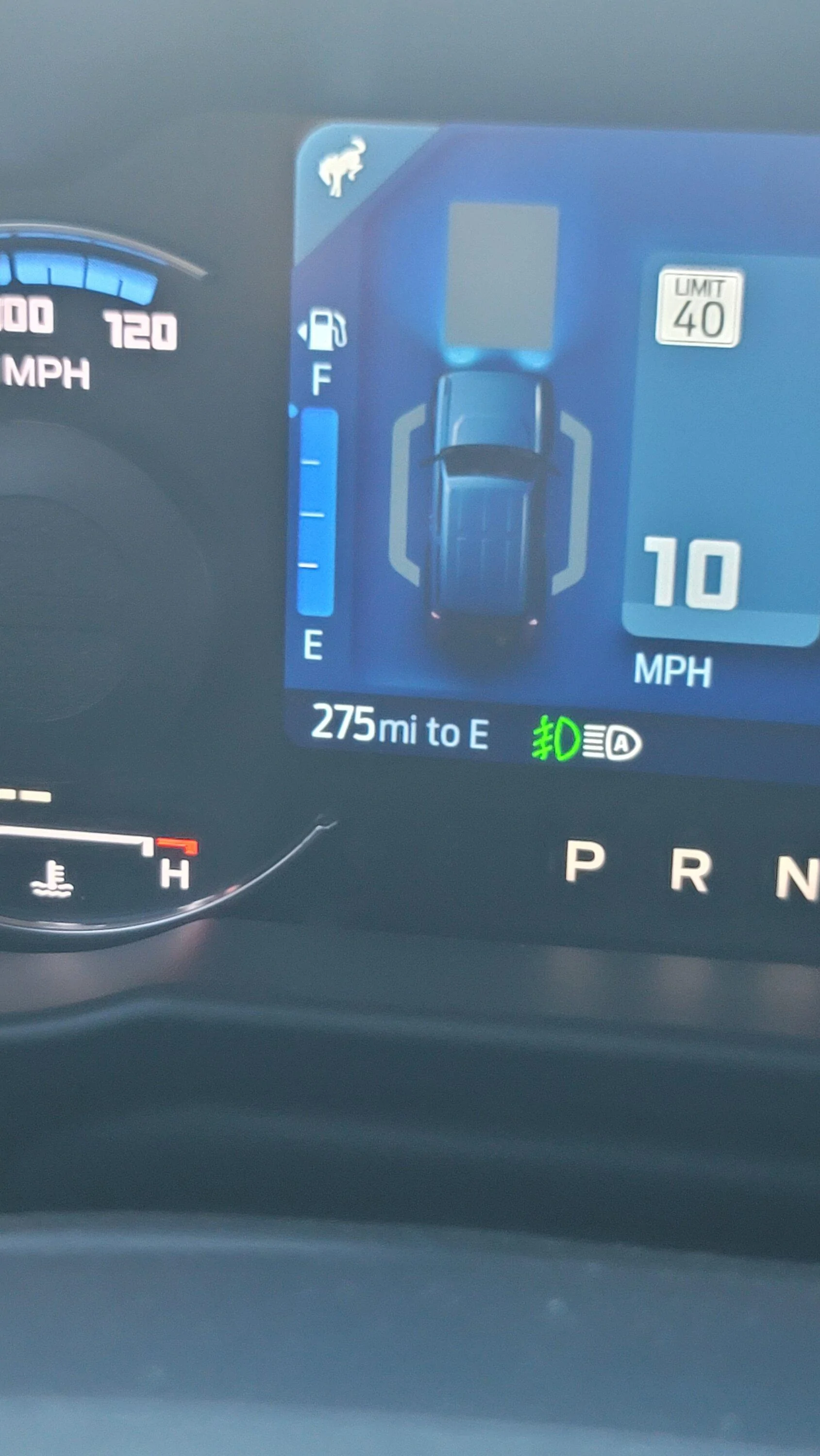

Hi all,
I have a 22' 4 door Badlands. I picked it up on April 29. Since then I have probably filled up with premium fuel at least 6 or more times. The first few fill ups showed approximately 355 miles until empty. The next few fill ups I decided to add gas after the pump stopped on its own. I then got approximately 376 miles until empty. Last week I filled up and the miles until empty said 288. My truck was at the service department this week for the windshield recall and I asked the advisor to look into this. He told me that the tech looked into the computer and didn't see anything wrong. The advisor said based on the gas mileage displayed, which was around 17mpg, 288 is what he's seen on Broncos. I quickly told him that my truck has a 20.8 gallon gas tank and 17x20.8=356 miles. The 288 would be what you would find on a 2 door with a 17 gallon tank. He said there is nothing for them to do. Has anyone else experienced this or heard about this happening? I know there is something wrong with the computer. Thanks in advance

There is nothing wrong with your Bronco. It formulates a miles to empty (MTE) estimate based on a shorter duration of real world data than what you are looking at with regard to a long term data expectation. You may be averaging 200 mpg overall but, the system computes MTE based on a much shorter distance/time traveled. Drive the freeway for an hour and your MTE may show 200. Then, drive in the city with stop and go for ten minutes and your mileage will show substantially less. This is by design so that your MTE will always be based on a shorter time/mileage estimate. This is why you may actually get to zero, or less, and still have gas in the tank.
