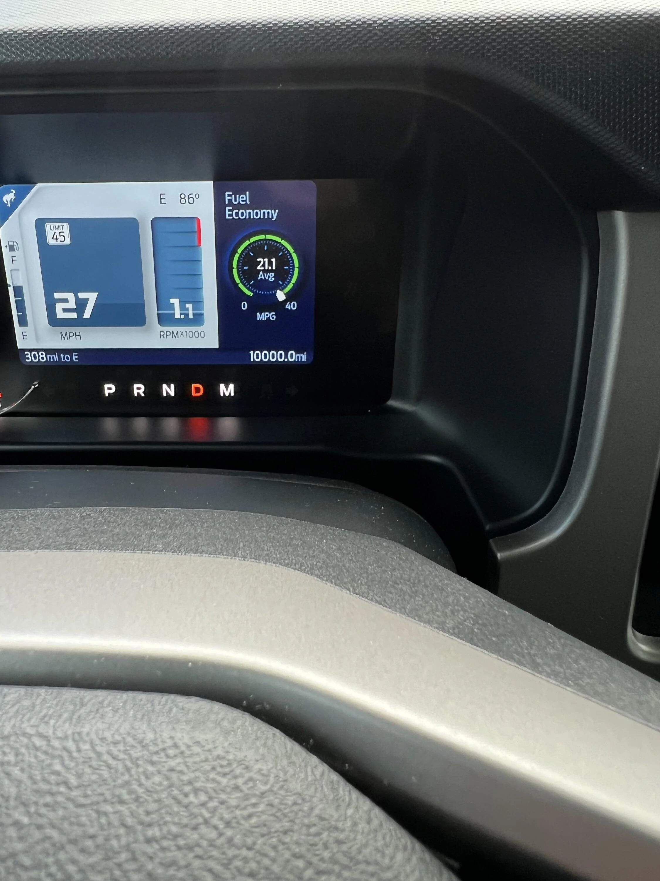

My 2022 2.3 10 Speed 2 door Bronco's milage has suddenly dropped. After driving almost 3000 miles with my Bronco getting 19/20 around town and 21/22 highway it has suddenly dropped on the last 3 fillups. It struggles to get 16 around town and 18 highway. My estimated range per tank went from around 320 to 280. I put Ranger Sport wheels and tires on but the size difference is negligible. Maybe it's the AC because of summer but that seems excessive.
Any thoughts?
