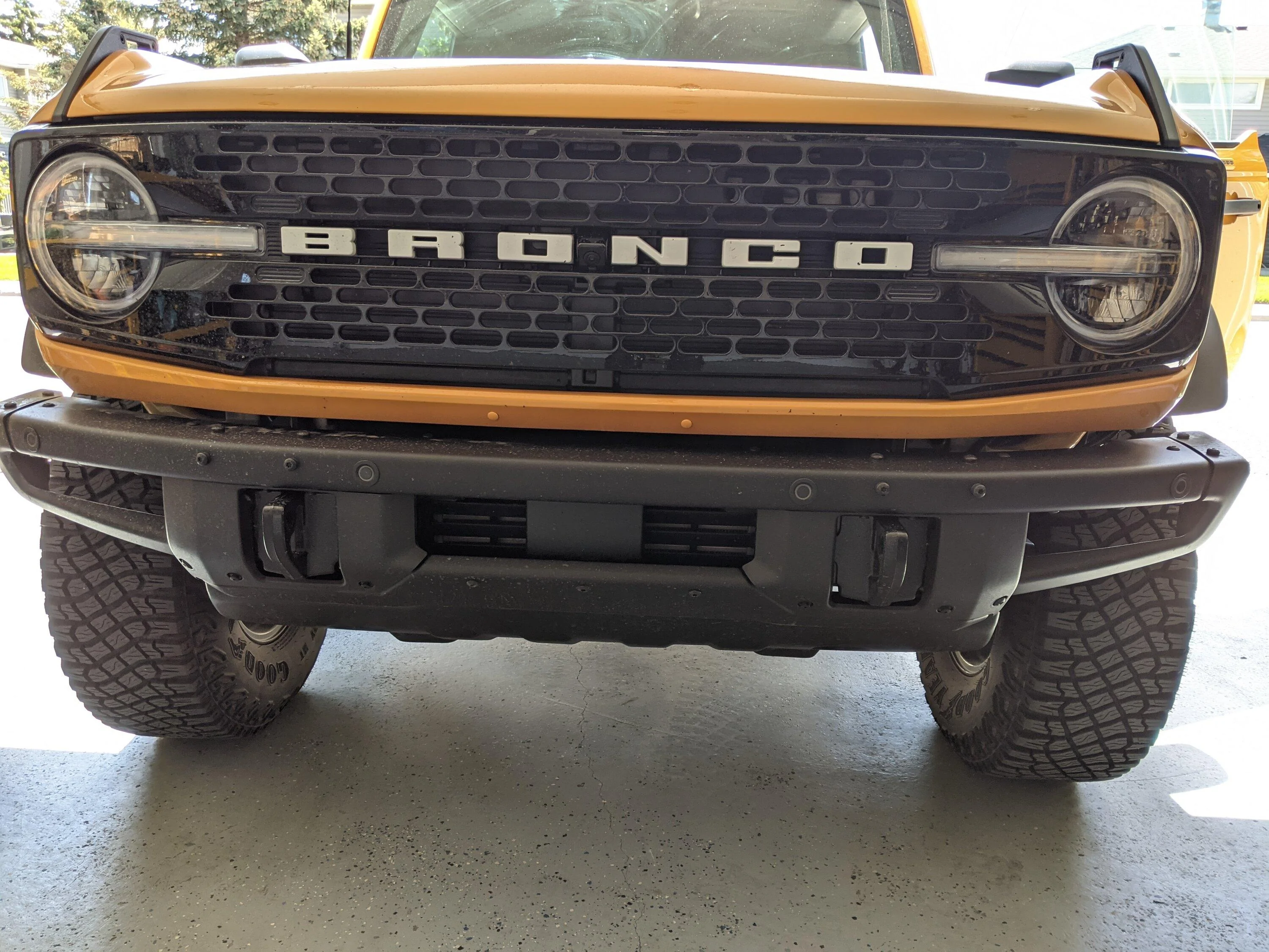

Yup they do. I had the same issue.
bumperplugs.com
I like them. No more stupid holes that the dealership stupidly drilled.

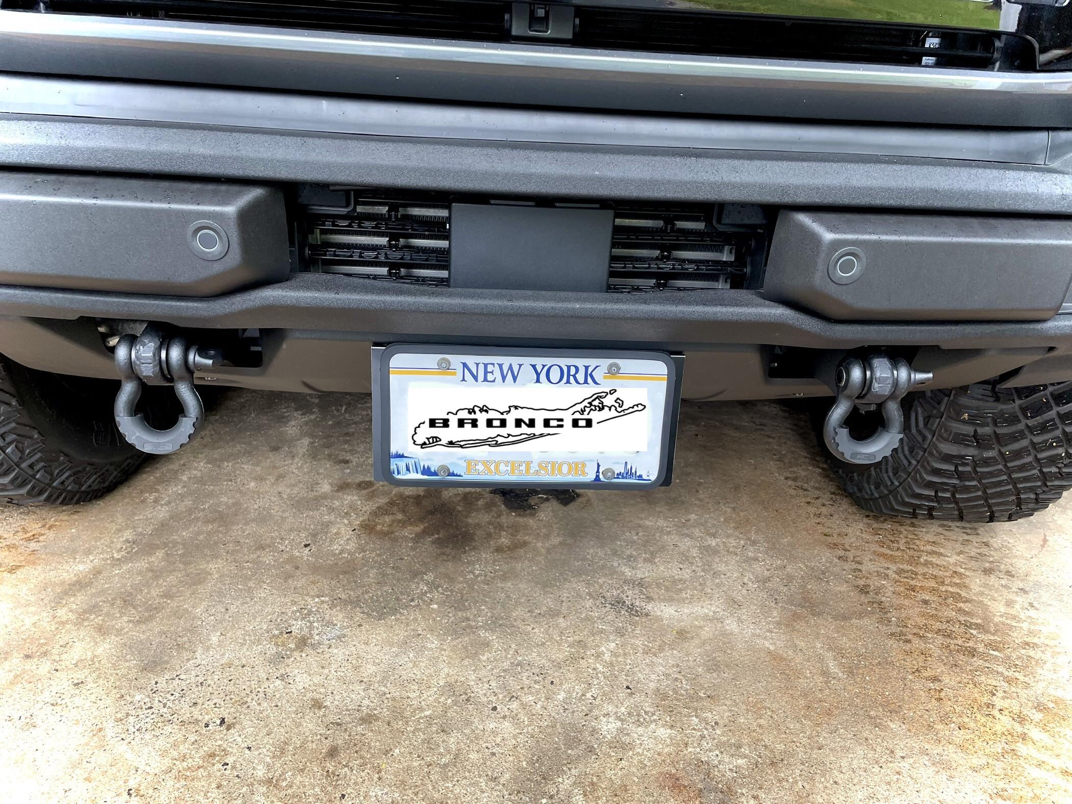

Here's what I ended up doing on my Standard Bumper. I removed the skid plate and drilled three small holes to install the @HBTFD plate option for the Modular bumper with stainless fasteners. (They have a different one for the Capable Bumper.) I'm very happy with the results:

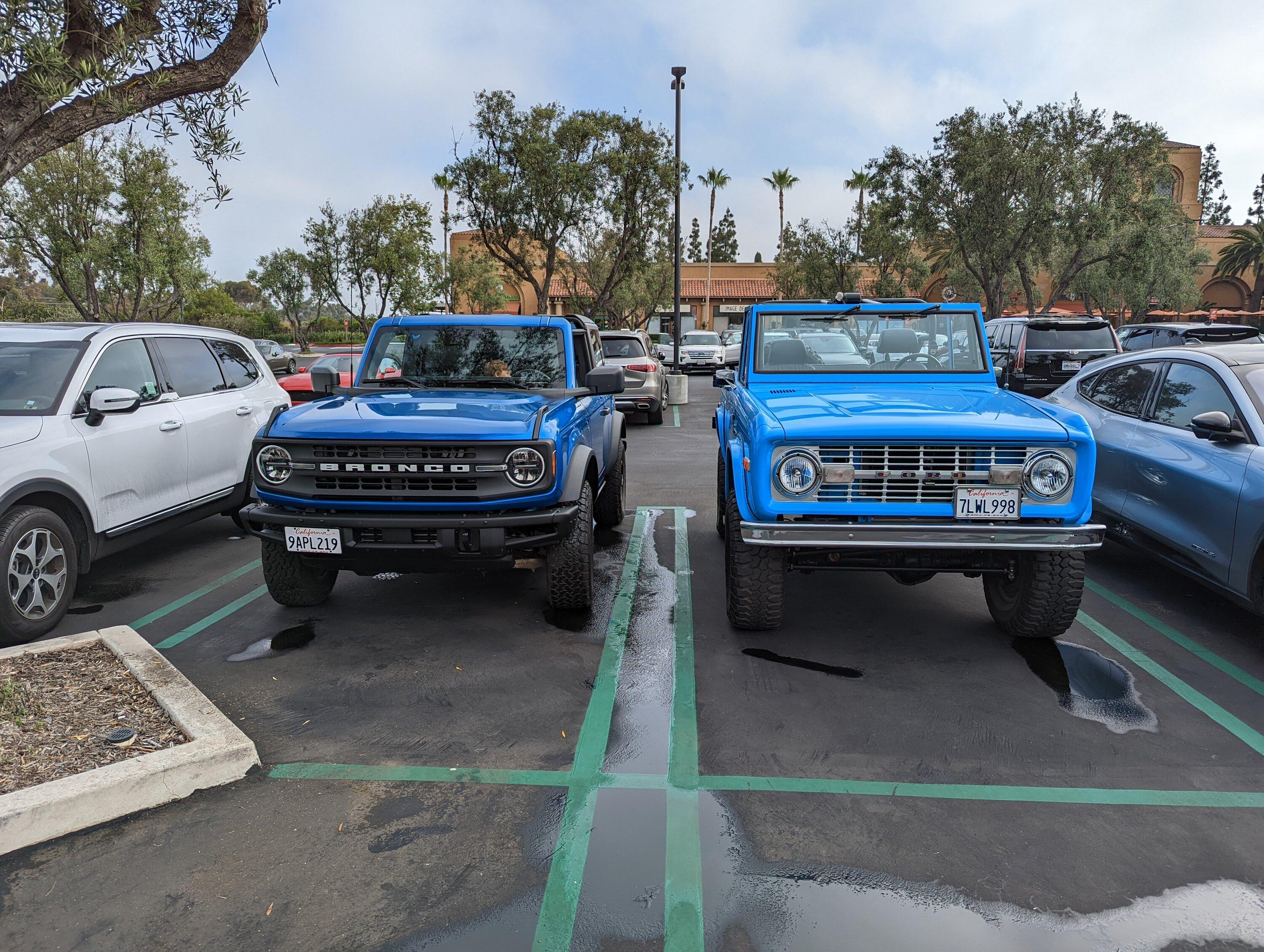

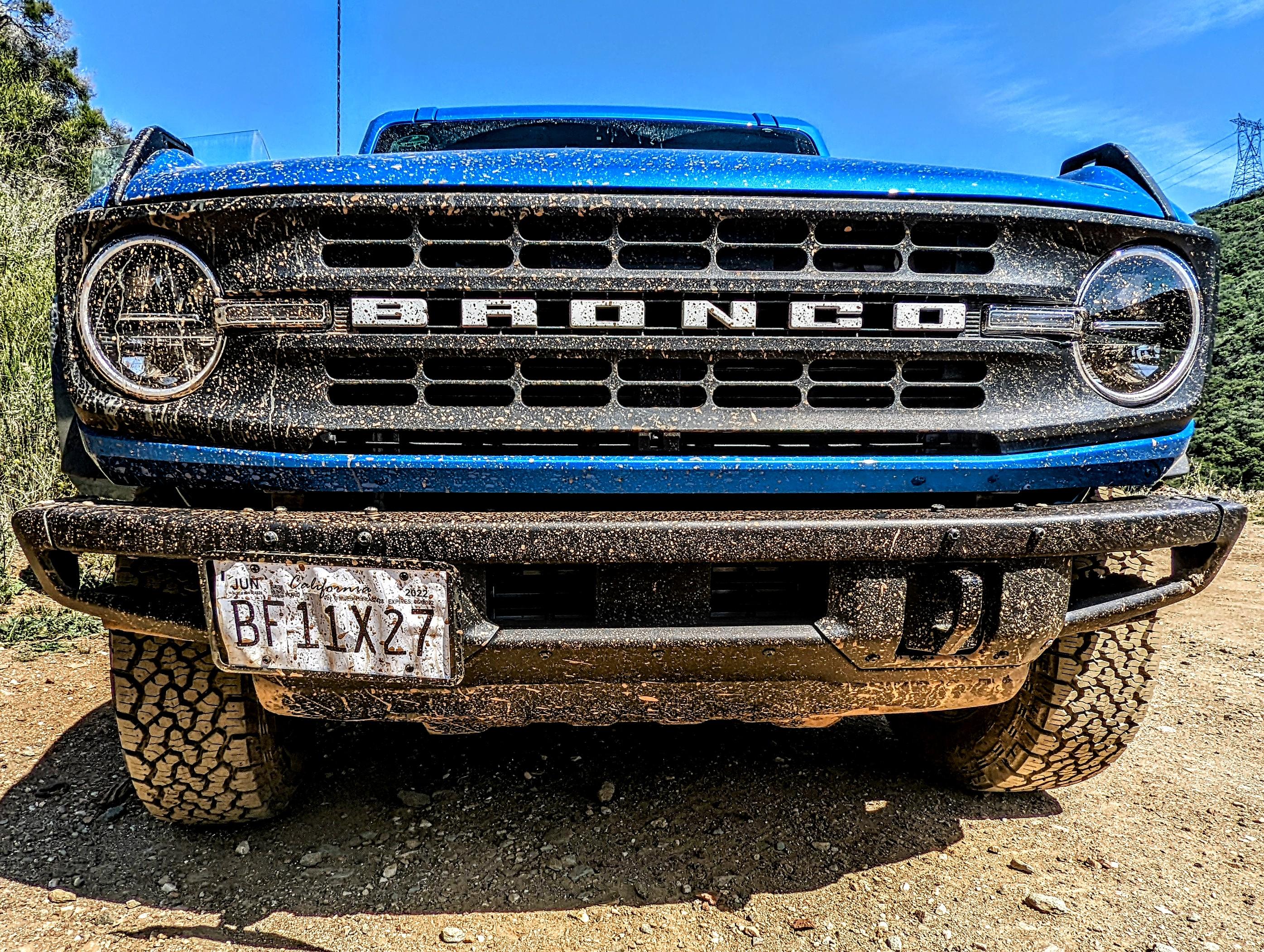

I like the tow hook mount. You can just take it off if you need the hook. Looks better off-center.

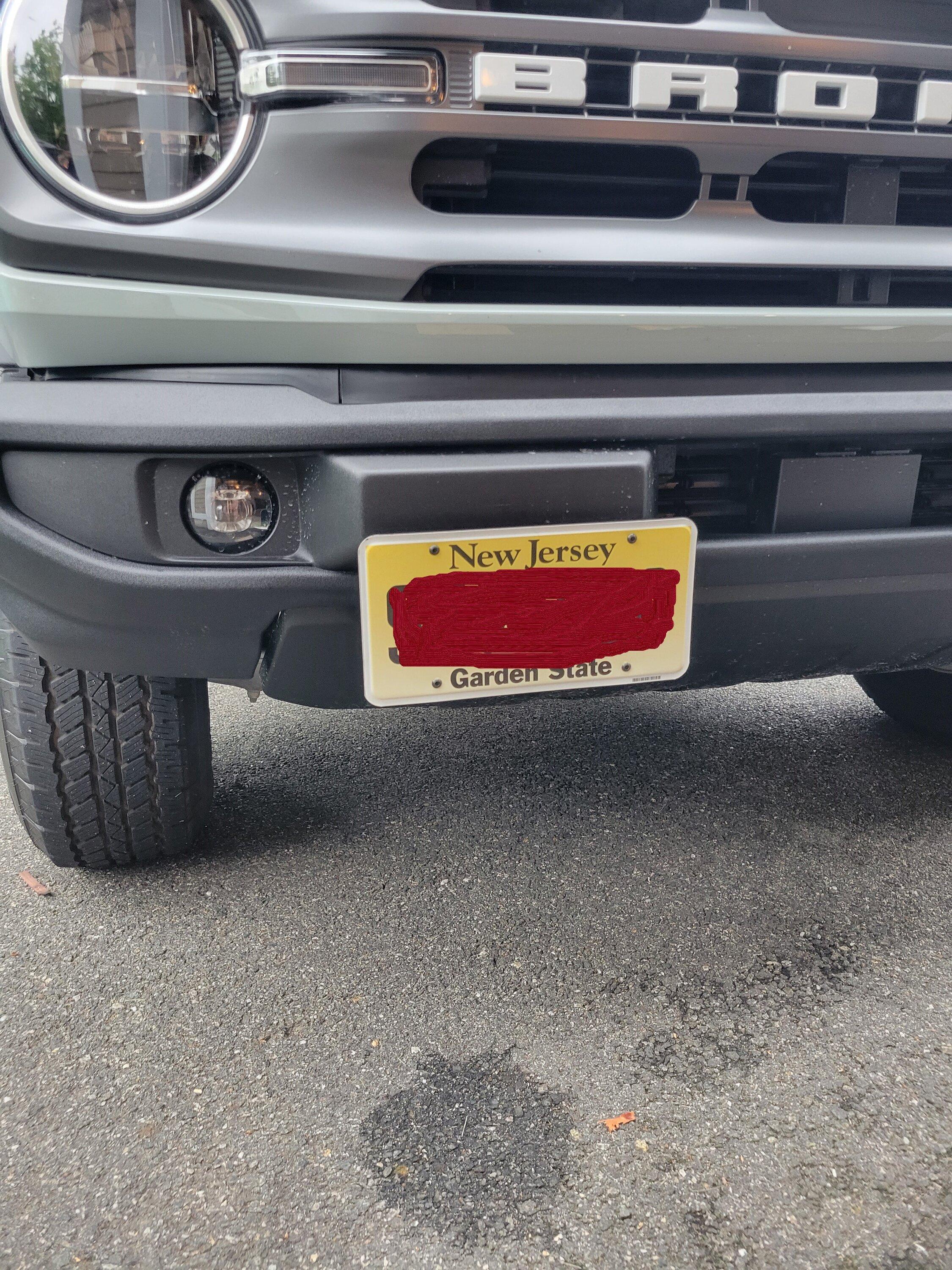

My dealer didn't even need to be told...when i mentioned it my sales guy said they had no intentions since most customers want to do something of their own. Here is my solution from builtright. Mounts to one of the existing bolts - you choose left or right

Great looking Bronco.

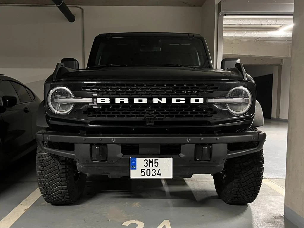

I am using the original front plate holder from Ford. What is STUPID is that you can see a small part ot the license plate in the image from the front camera all the time 🤷‍♂️

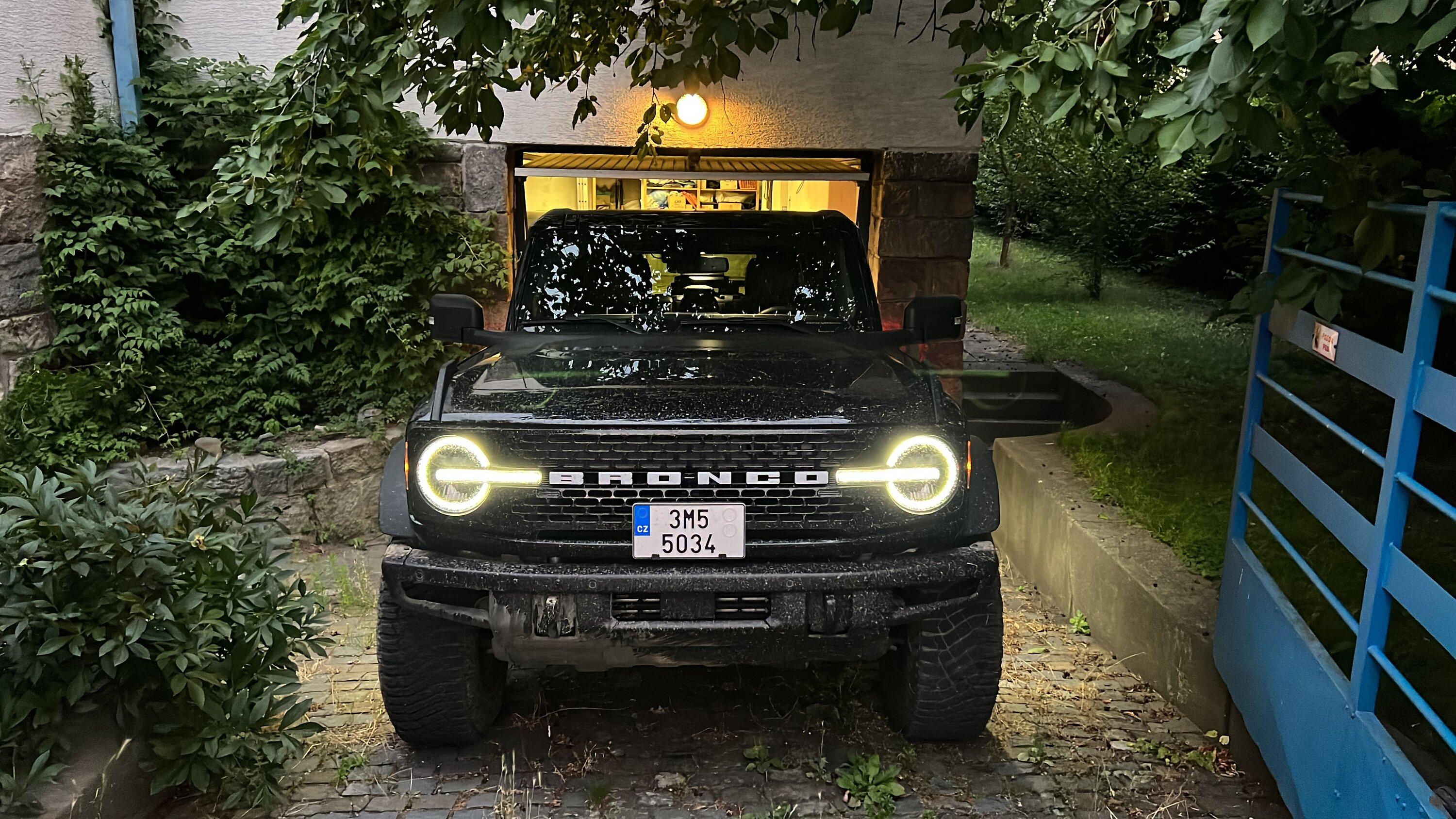

Solved the camera issue by moving the plate (and getting a better look!):
I did the same - I went with Built Right.
However the license plate can easily bend - so I added a steel plate behind the license plate. It works well with the Built Right bracket, you just need to use four screws to hold it together (Built Right only ships with 2). Place the steel plate on the bracket and the license plate on top of the steel plate.
Steel plate: https://www.amazon.com/gp/product/B07HLQ85W4/
Extra screws: https://www.amazon.com/dp/B00FTDIHSU
