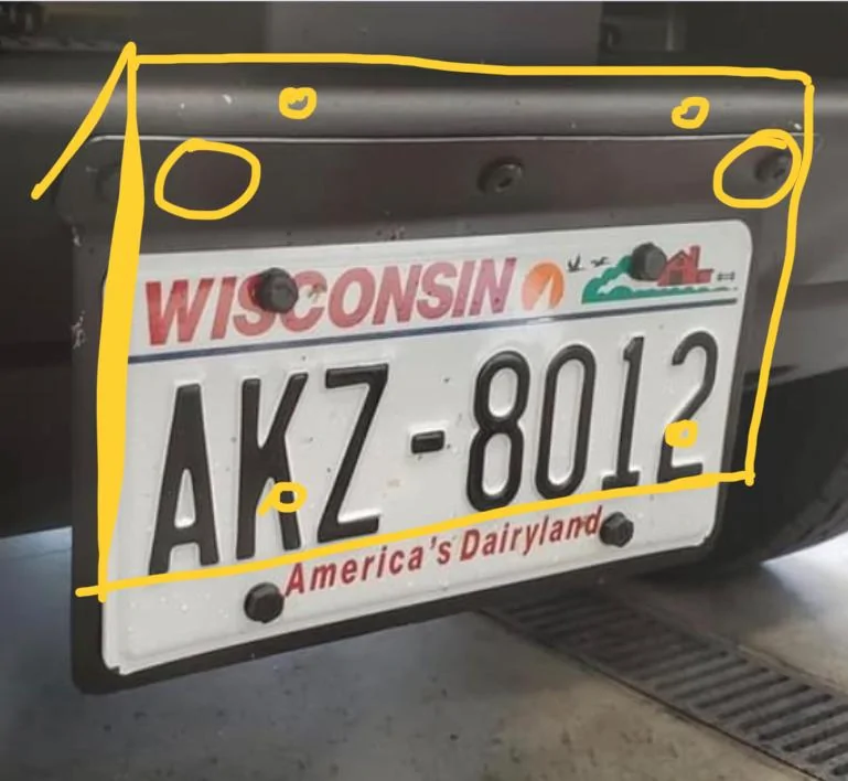

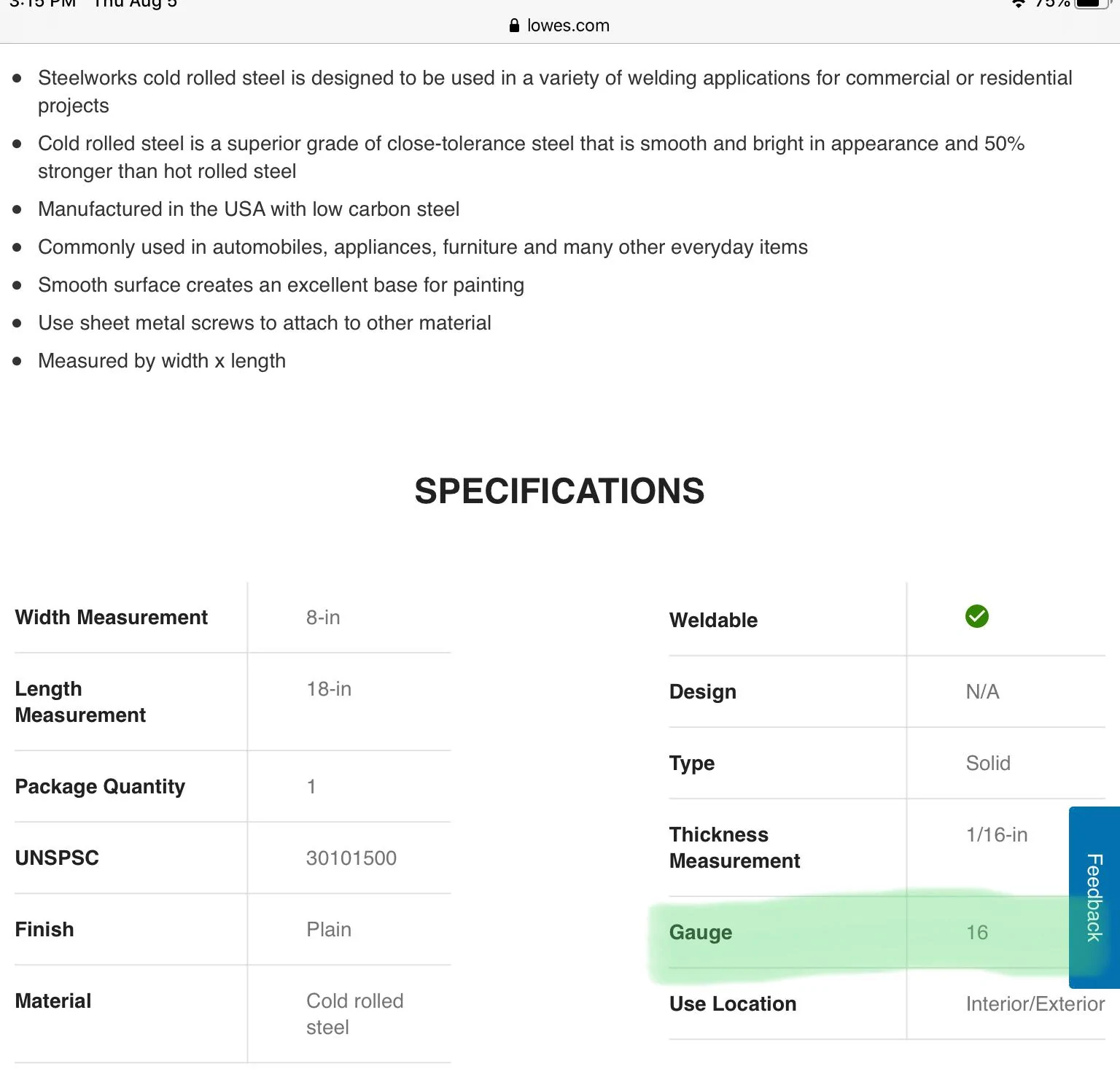

I’ll be using the Bronco bolts to attach my license plate to the front bash plate. There are various Bronco owners that have already done this. All you need is some 16 gauge metal and the ability to put a bend in it and drill some holes and you’re done. And anytime I do some heavy duty off roading I’ll just unbolt it.

Lowe’s and Home Depot sell it and if you ask nicely they may even cut it for you Or any small local shop would do it for you. Personally since I have a mechanics garage and all the accompanying tools for $12 and a half hour of my time I’ll be all set 😉

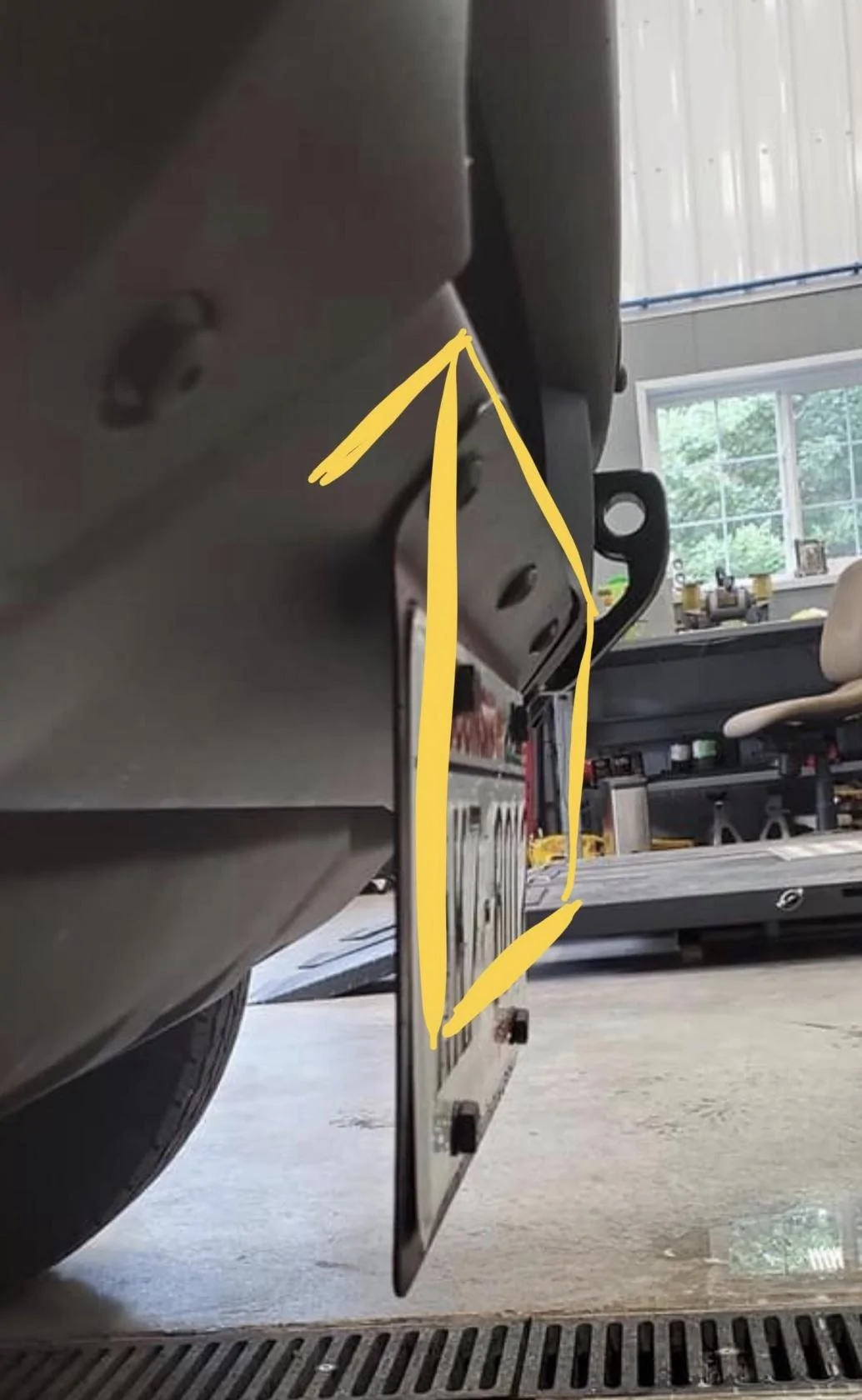

This post has me thinking that instead of putting a forward bend in the plate steel to match the angle of the Bronco’s bash plate I will put a reverse bend in it. This will serve two purposes. One it will give the plate a bit more give if I bash it into anything and more importantly with this type of mount I can place the license plate up higher, just below the inter cooler opening. I’ll just have to drill two larger access holes in the mounting plate so I have access to the bronco bolts holding it to the bash plate. Once the license plate is mounted it will cover up those access holes 😉
