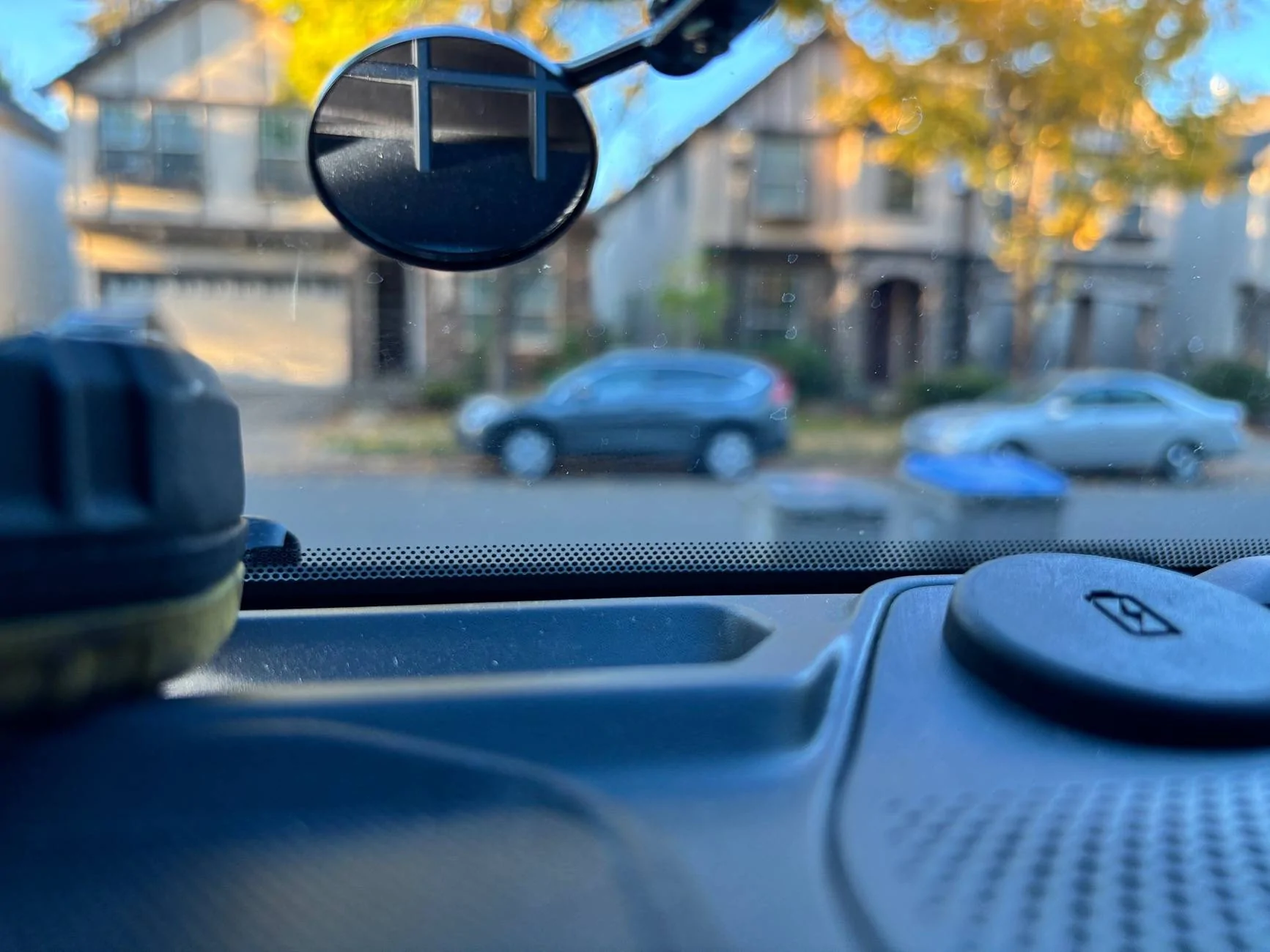

I can't help but think a thin stiff reed or stick with chewing gum on it might be a decent hail Mary.
Yeah certainly worth a shot

Yeah sorry, wish I had a better idea. Unfortunately that’s like a black hole. And a lot of work to retrieve anything in it.
Any chance the workshop manual has a section on replacing the HVAC? Or does it just say... good luck, pilgrim?

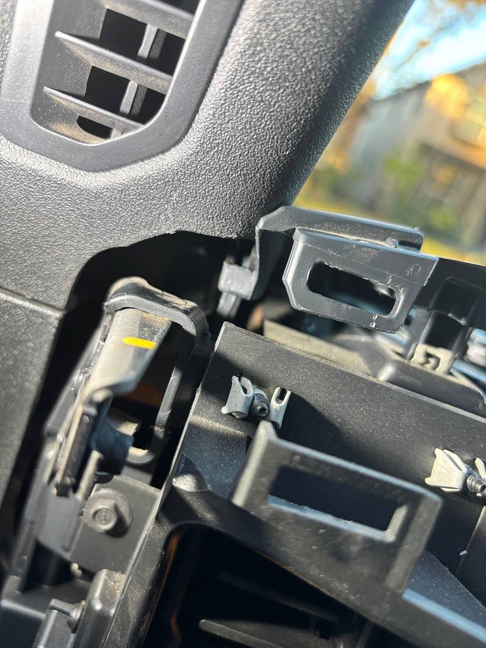

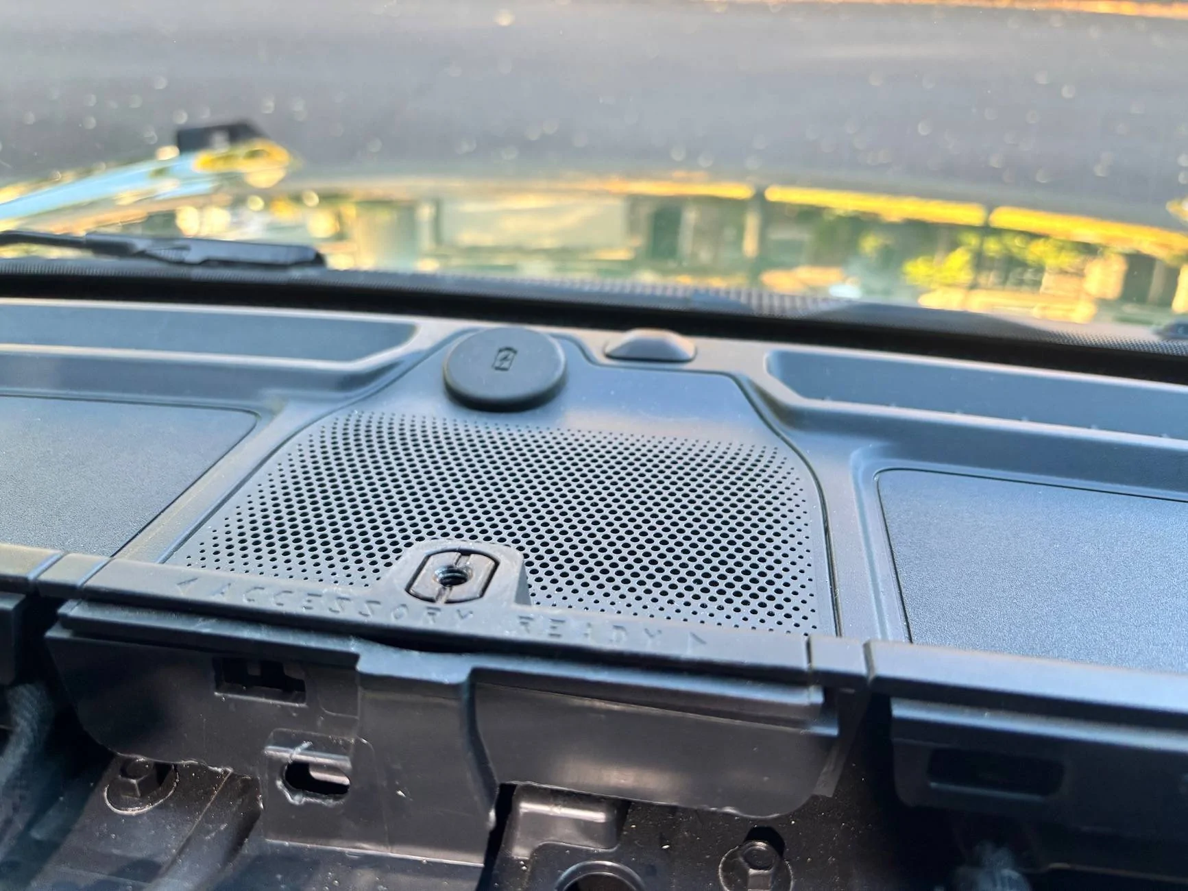

Is there a step missing to remove this center part? I’ve got all the screws out from the front but this doesn’t seem to want to move.
Did you get the 2 screws on both sides of that accessory ready location?

After that it’s just clips that hold it down.
