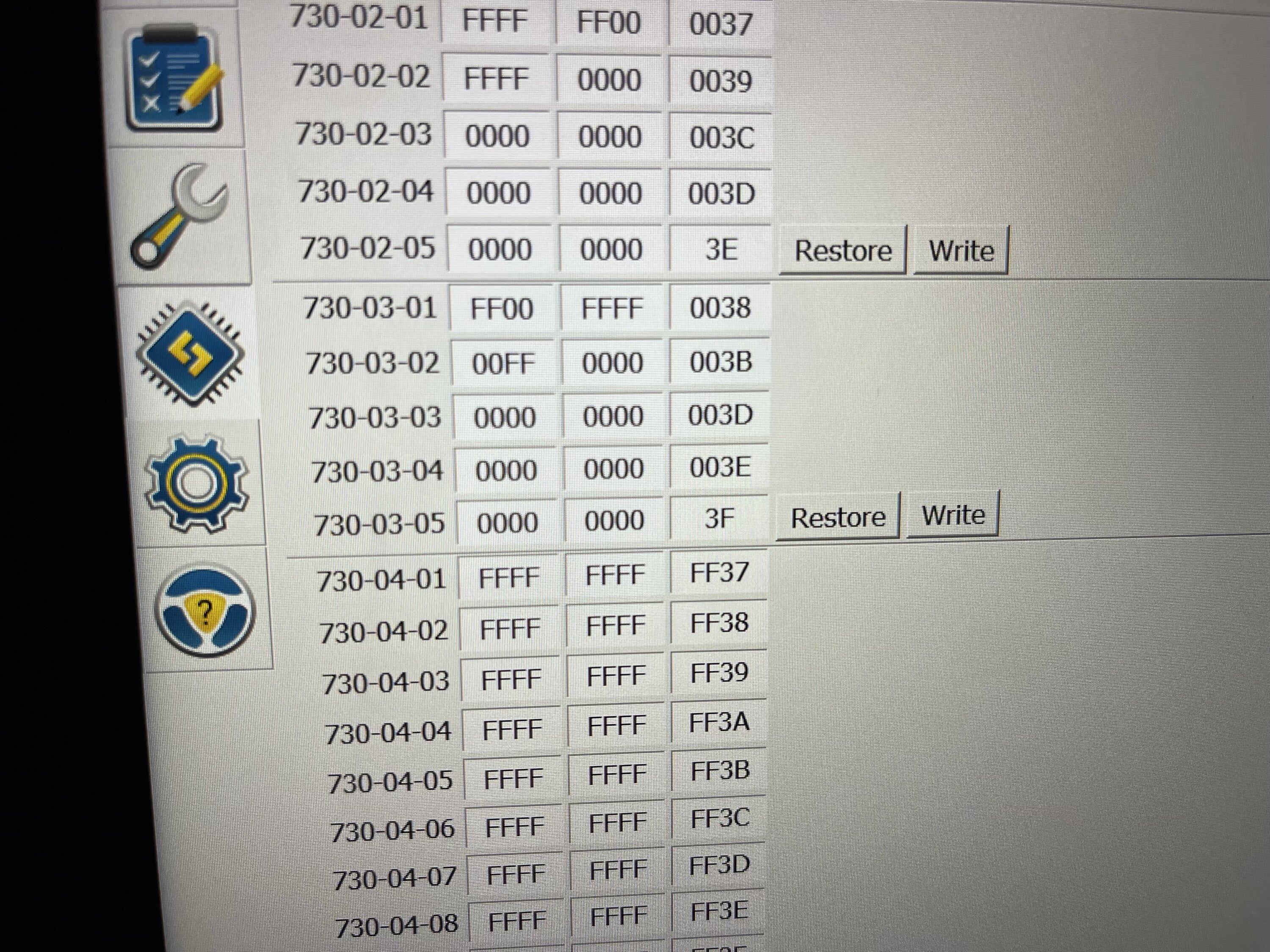

This is a picture of my FORScan page. I have accomplished a few items, but I am having trouble with the auto start/stop procedure. This is a written file. I went to 730-03-01 and on the third box put "00" in the start. The vehicle is still auto start/stopping. Can anyone help me with this? Thank you!
What year is your Bronco? If it is a 2023 Model this has been discussed multiple times and it seems to be pretty hit and miss if it works for you or not. The only for sure way to disable it on a 2023 Model is buy a physical Device if the ForScan doesn't work.

I have to agree with @BroncoLV. The install of the hardware solution is pretty straightforward and easily removable if you want to restore to factory. Works like a champ.
My experience with Forscan is mixed. I tried several times (on my '21) to set that and ended up getting a "Charging System" error that I had to get reset at the Dealer (which reset all my other settings). Since then, I've just set DRLs, Fog Lights and the Double Honk. No issues since.
My advice is just be careful and make sure that you backup each module carefully.
