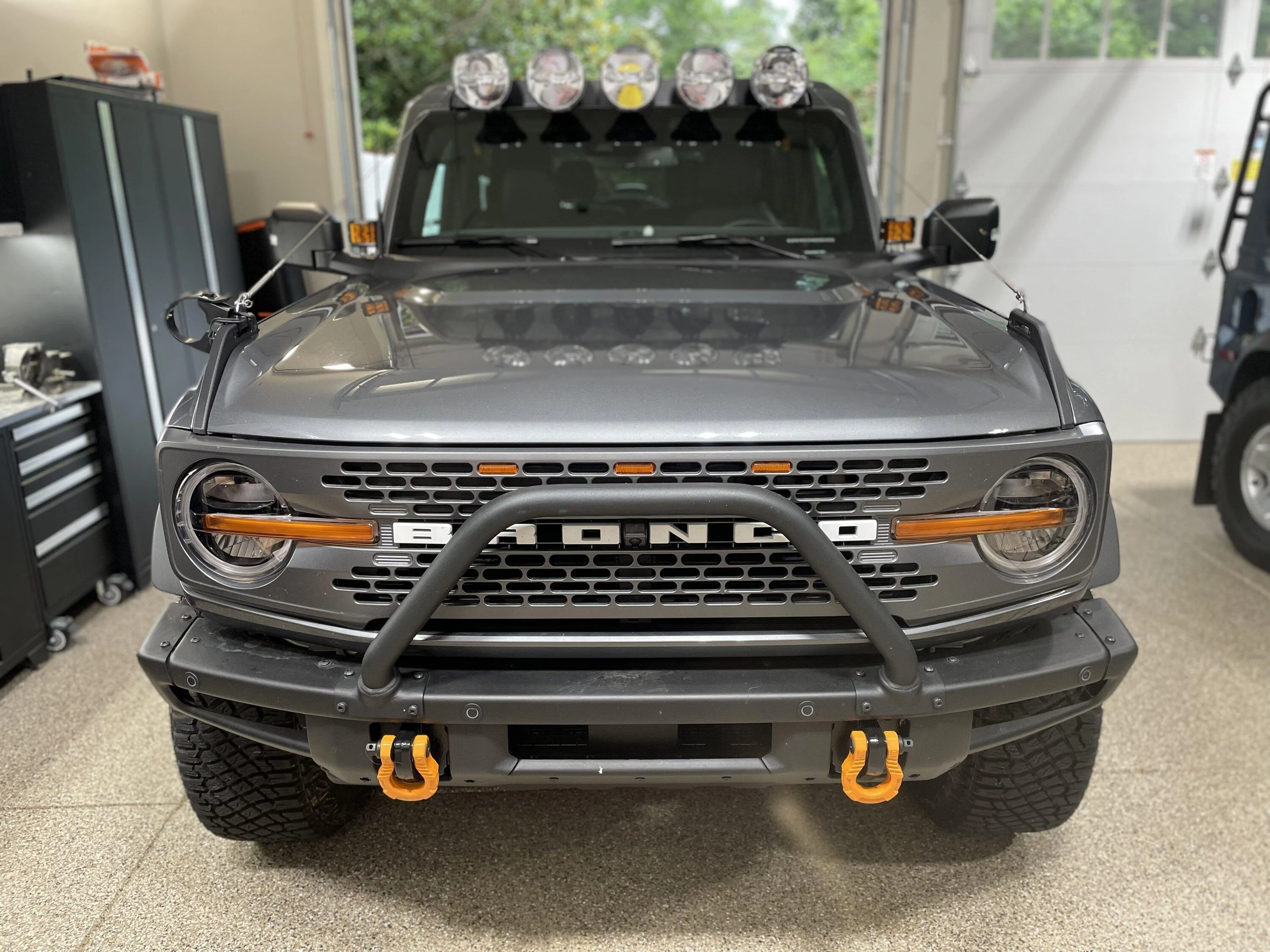

i ended up just using vynl, turned out pretty good in my opinion (see attached)
Ford Bronco ForScan horizontal light to amber mod A6910D2C-551D-4A88-A140-E7461079B737
