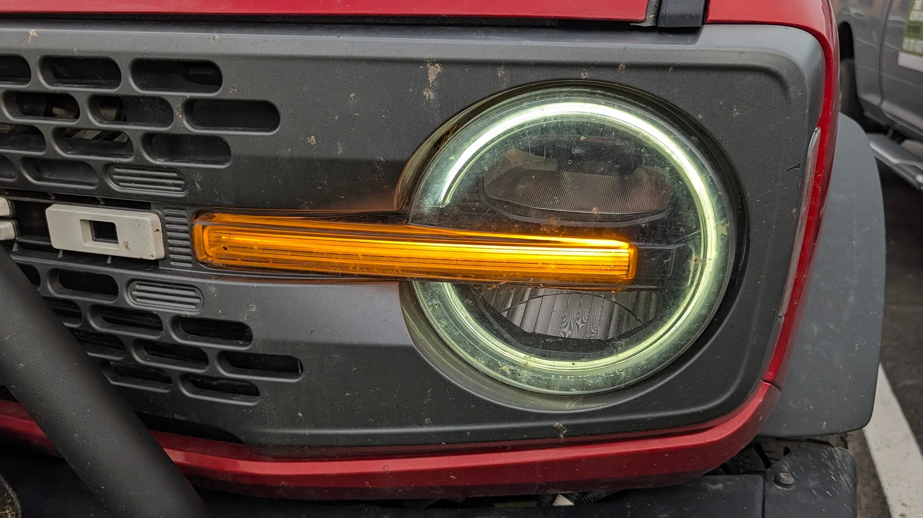

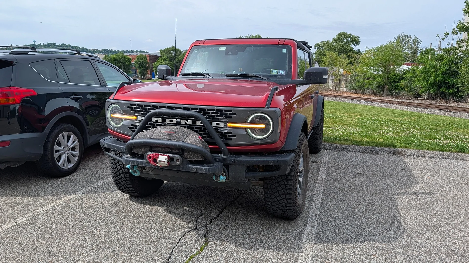

So did the whole switching the strips to amber with forscan. What i noticed was left side was working correctly, right side the strip was amber but the halo wasnt on at all. Reverted back to stock white and both sides worked correctly. Switched back to amber and once again right side halo was off and even when headlights kicked on everything turned white and right halo was back on. Ive seen one other person with this issue and never found a solution. Ended up reverting back to stock

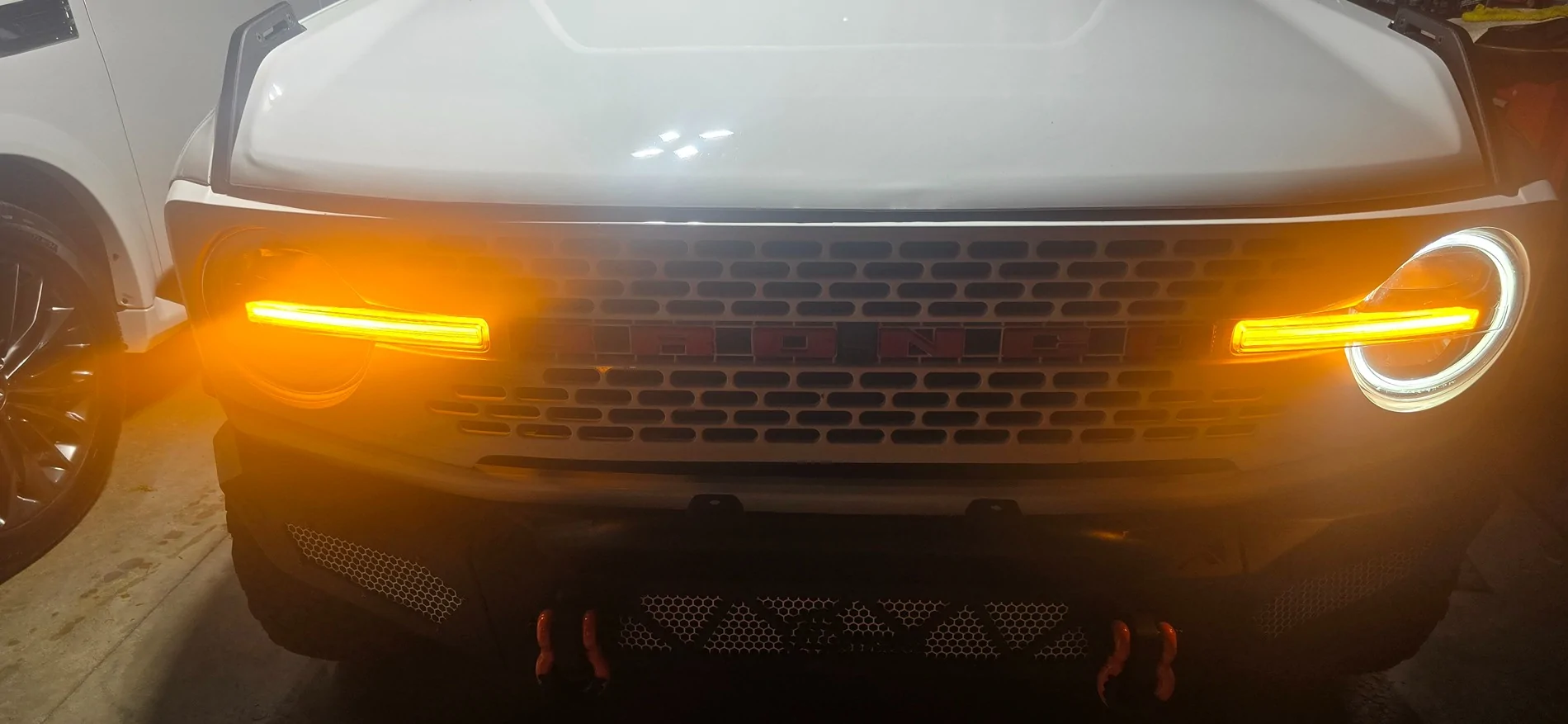

i have nothing constructive to offer ... but I wish there was a way to just run the amber bars and no halo. That would be a welcome mistake to make in forscan. good luck!

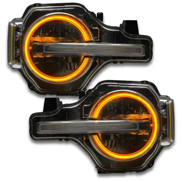

If those are the OE Signature Halogen headlights, we have a RGB+W halo kit upgrade option. Set it to amber or even red to match the grill colors.

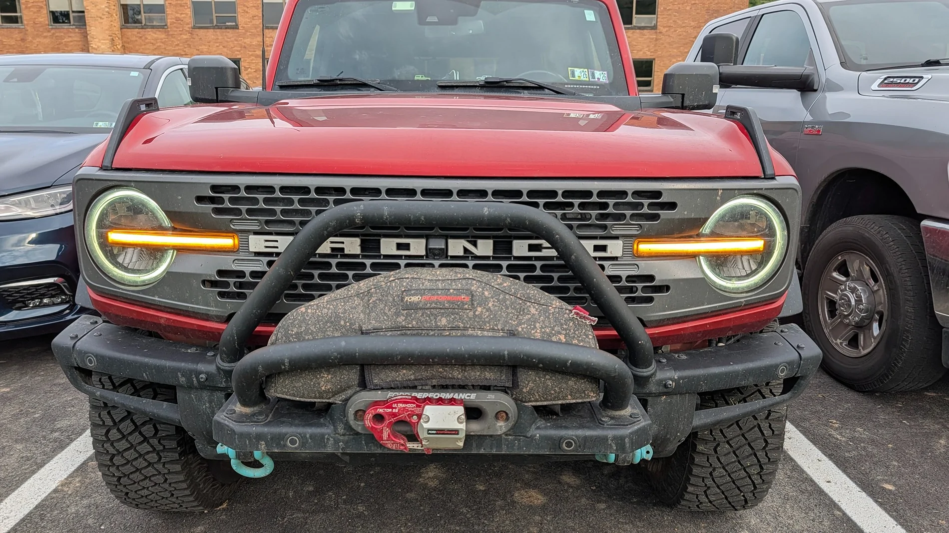

Just got mine working, had the same scare everyone else seemed to have (doing the job at night) once i got into daylight everything worked as expected, i think i swapped to 0101 instead of 0202
