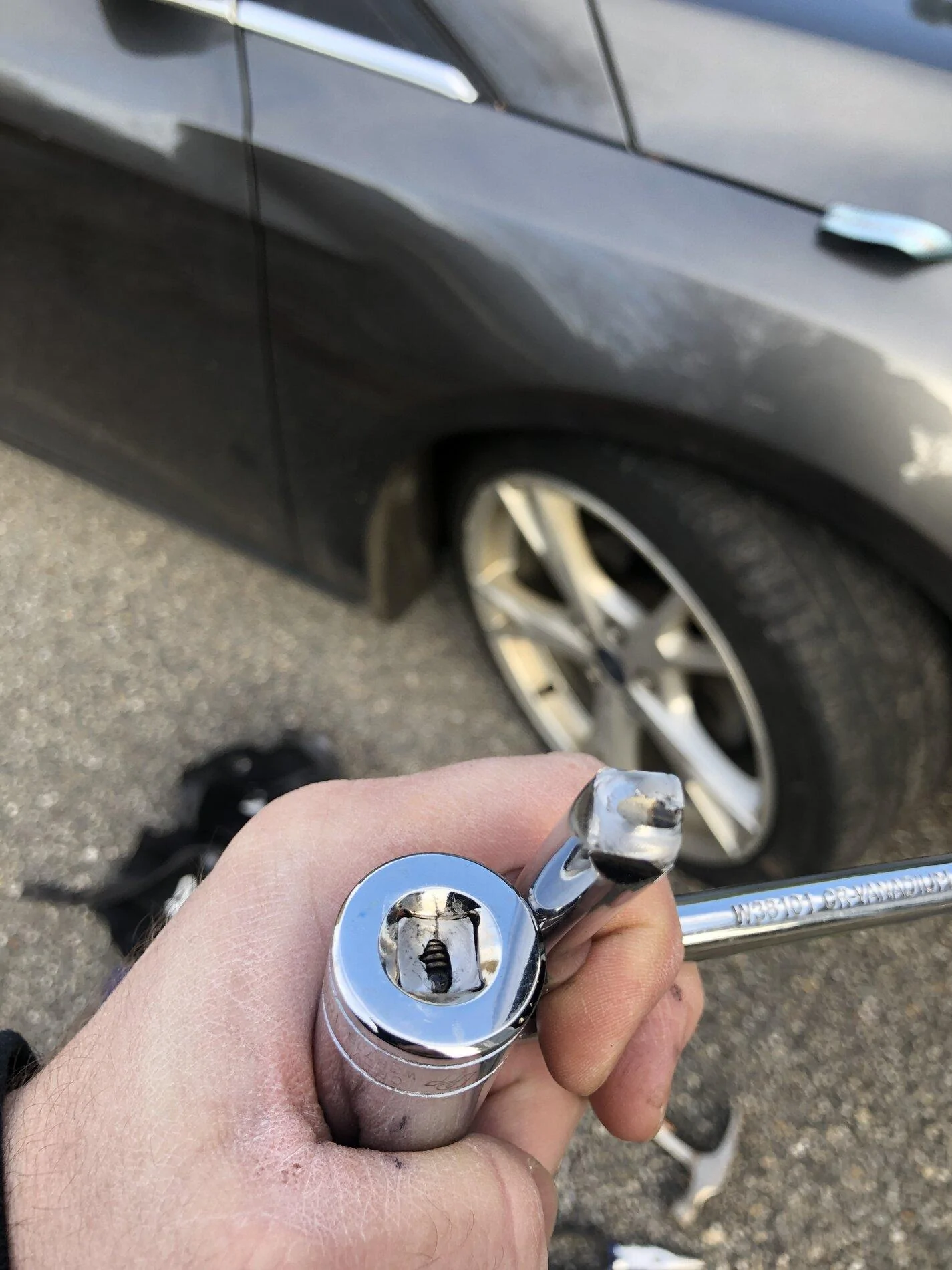

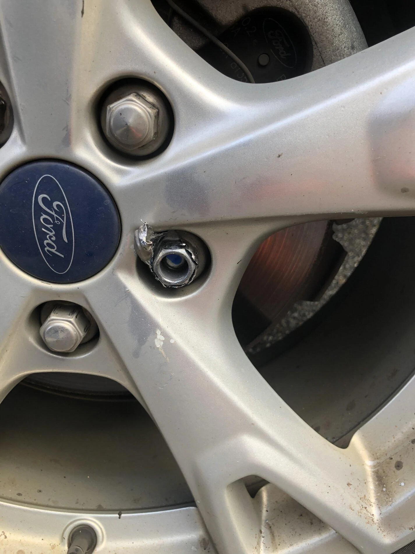

Hi all, I'm not sure if they announced it or if someone has any info (I'm not able to find any on here or the web) but will ford be using those horrible two piece lugnuts that swell after 3 years and become a PITA to take on and off? I recently replaced the ones on my focus after I could not get 7 of them on the studs with the socket wrench, even got out the impact gun. I am curious if anyone knows the sizes and seat types for the bronco, as I would like to replace them the day I bring my bronco home as a form of preventive maintenance. Also I am curious if anyone else on here has had bad experiences with ford lug nuts.
1) Had these on my '05 Mustang GT. Tire shop went to pull an old tire off and the impact gun just spun on one lug nut. Guy came to tell me that he thought that the lug had stripped in the hub and was just spinning! WTH? Took me into the shop and I told him that it looked like the cap on the nut had been torqued off the nut. And so it was. Whew!

I just had this happen on my jeep during inspection. They definitely used an impact gun and broke the cap off the acorn part of the lug nut.
I took a 1mm smaller 12 point socket and beat it on with my BFH and then was able to get it off.

I also had a terrible experience with those lug nuts. I had to chisel away some of the outer layers and hammer sockets on. Unfortunately there were like 4 I couldn't get so I had to get a half mm smaller special socket and hammer that on.
It took me like 4 days to get a fkn wheel off.
