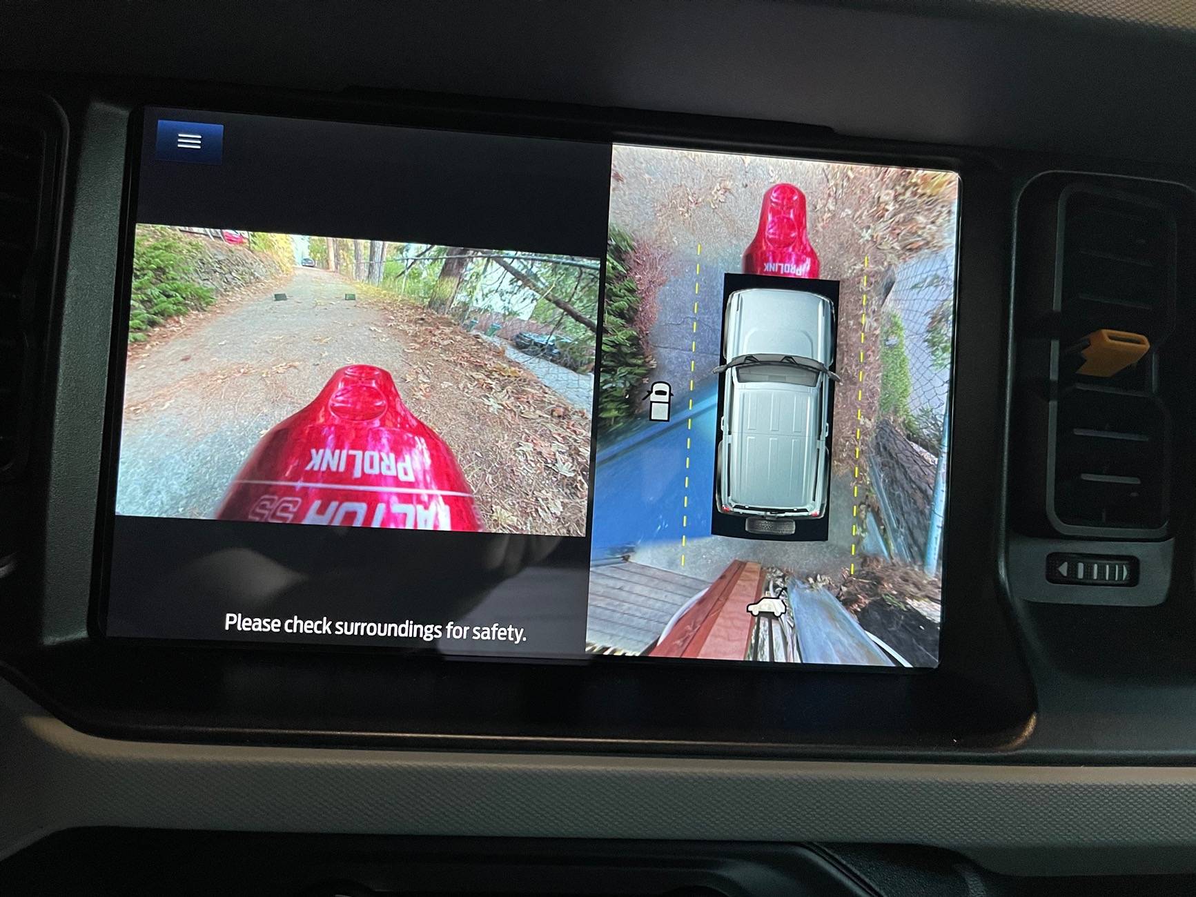

I just installed my Ford performance kit this weekend and used your video, it was extremely helpful. I appreciate you. I also stripped a recovery bolt hole and did what you did with a couple hardened nuts.
I installed camera relocation kit and a factor 55 shackle mount, but it looks a little ridiculous through my camera:crackup::crackup::crackup:, I might have to move the shackle mount to the side.
I had no idea those ProLinks were so massive! That thing must weigh at least as much as the bumper, if not more. :ROFLMAO:
Hey, I'm glad the video was helpful to you! That photo is funny! Cheers!

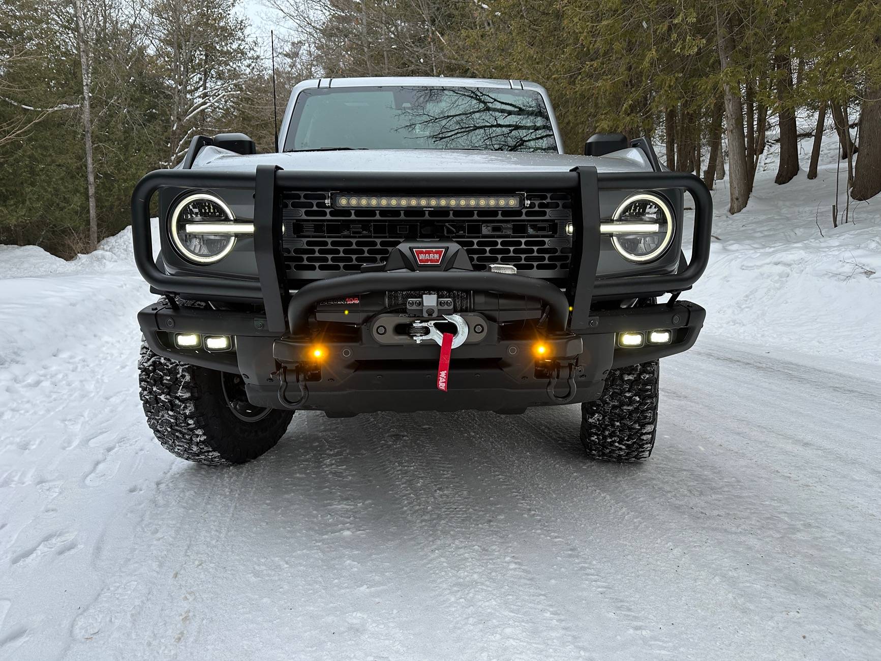

I followed the warn winch install kit instructions but the originators video put together helped out a lot. A lot.
