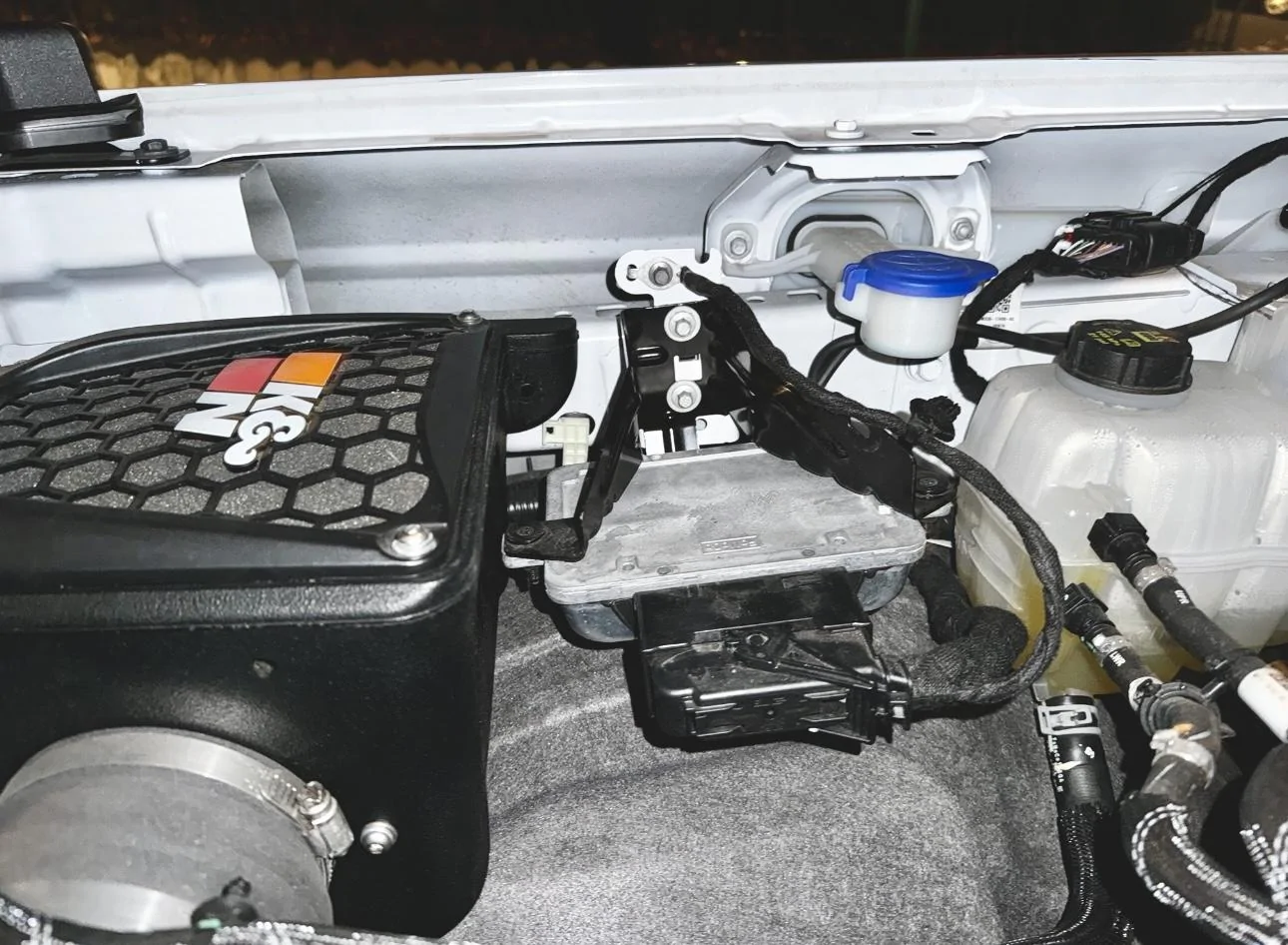

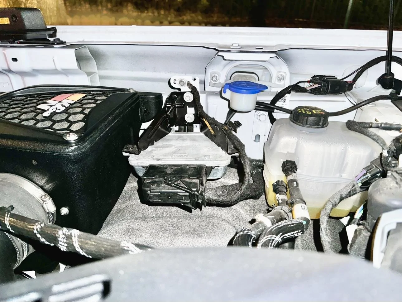

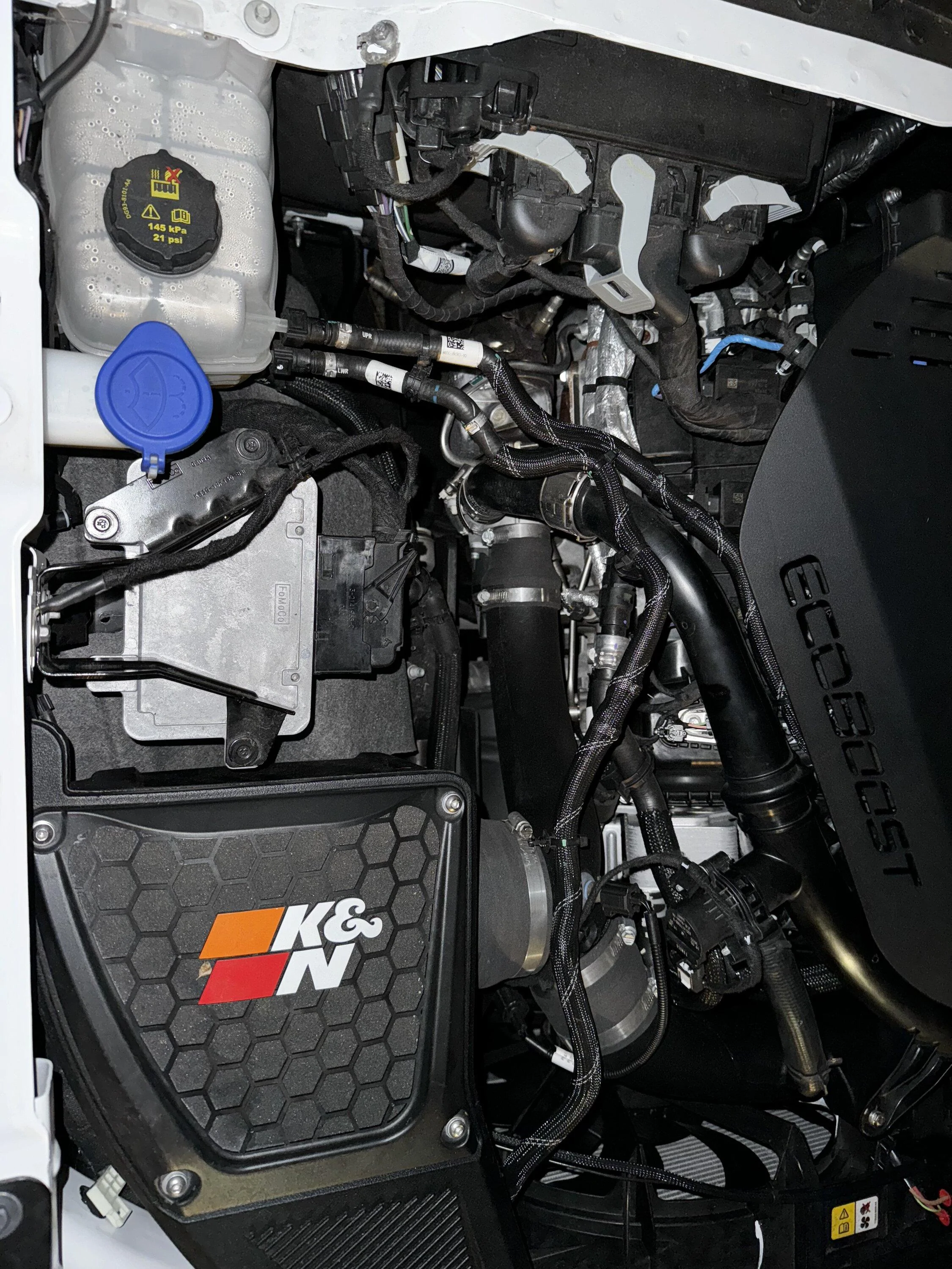

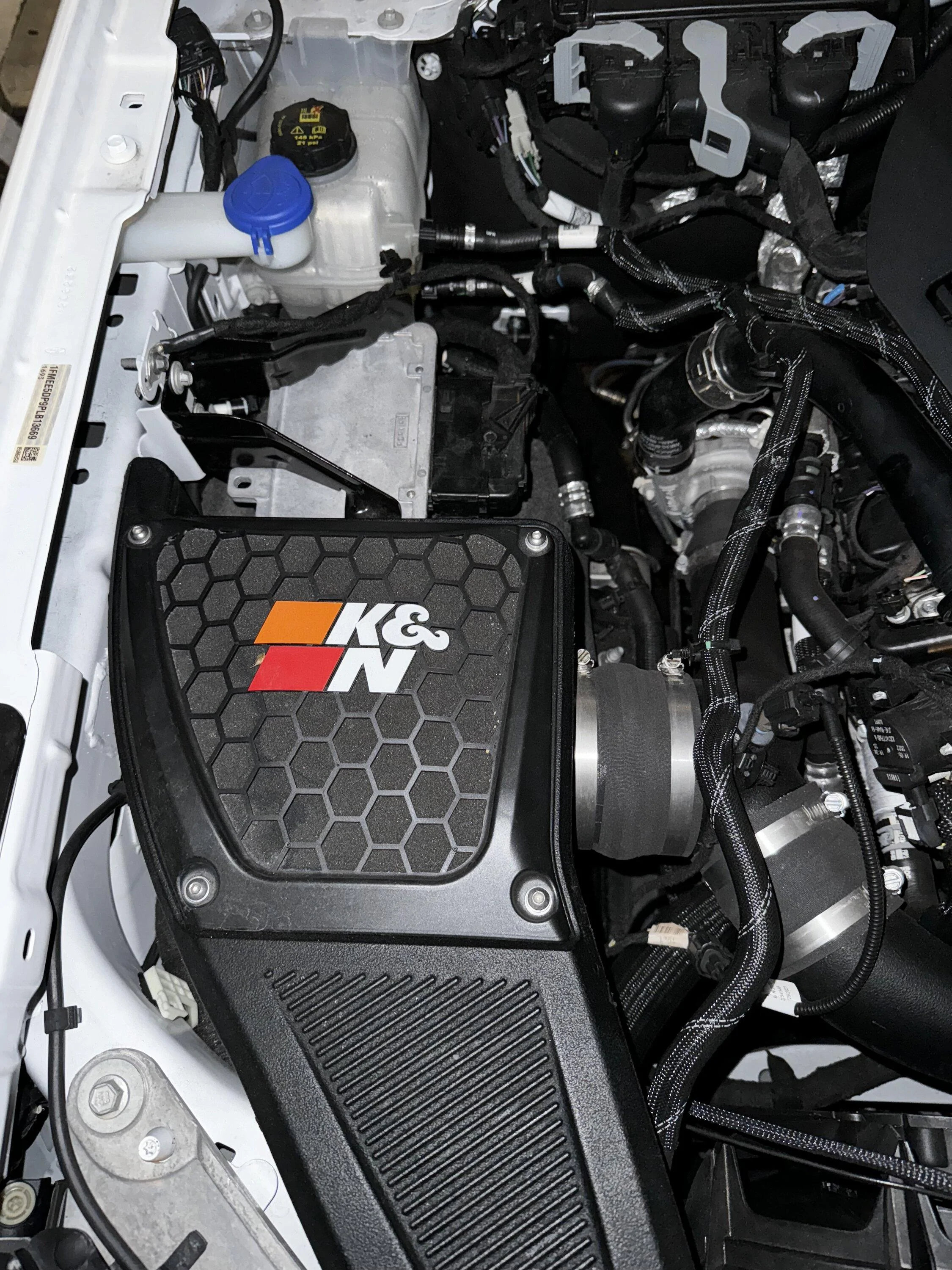

Yesterday I spent a few hours trying to install the Ford Performance Twin ARB Compressor mount because 4WP quoted me 6hours/$900 + for install. Long story short I found out the hard way that it does not fit... I have a K&N air intake and the intake box that houses the filter is bigger than the OEM so there is not enough space for the bracket that bolts on the inner fender frame next to the filter box.
I'm considering the AGS offroad tire carrier, I looked at the vertical mount by Grimm Offroad but it seems like its tight next to the OEM air box based on the Your tube videos I've seen of the install.
Any and all suggestions welcome!

Pics of the K&N
