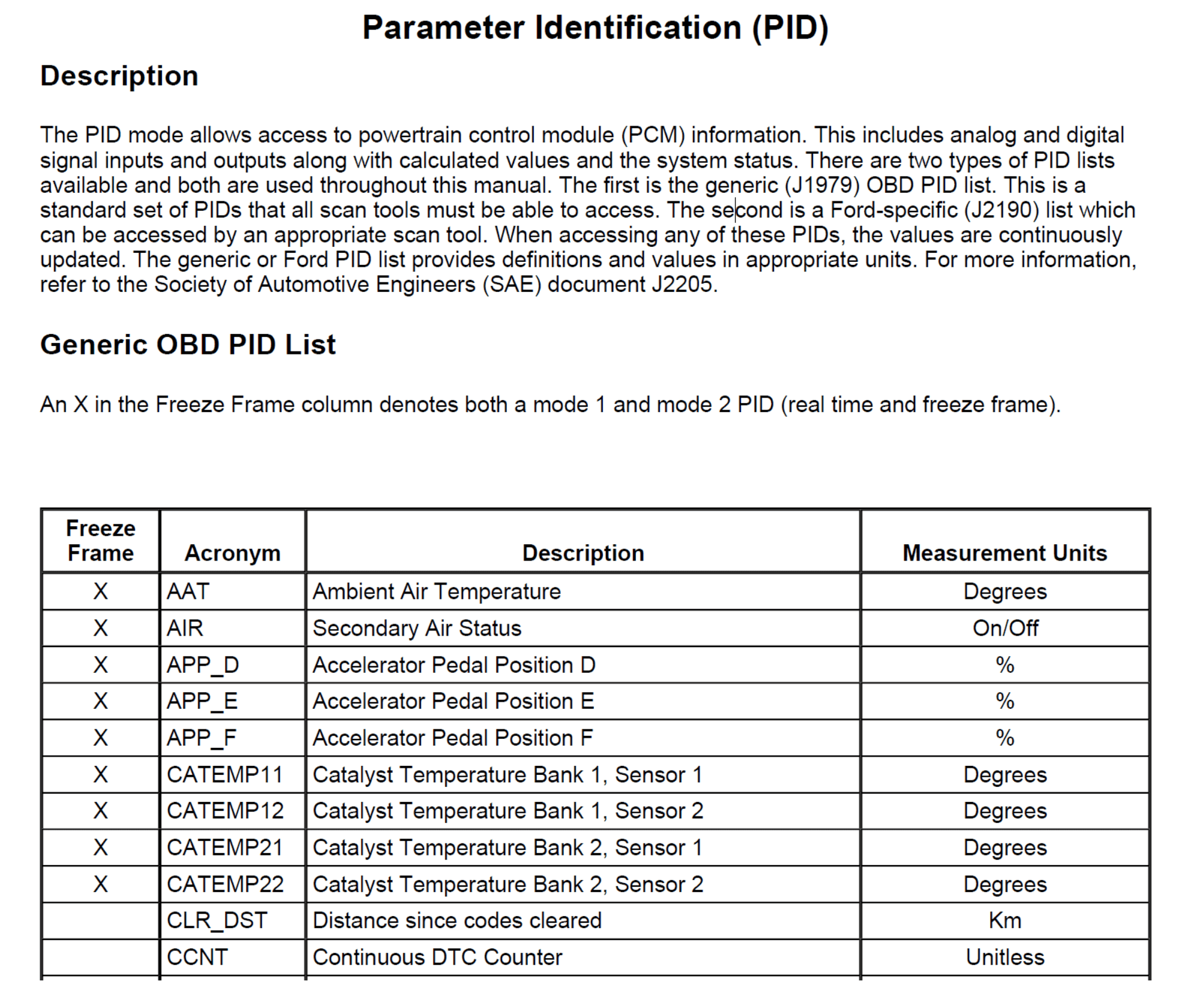

Try a search for FORD PIDs. There should be a list with the PID Identifier, the abbreviation, and a description. It appears that the Gauges options may be using those abbreviations.
For instance, it should look something like:
Ford Bronco Ford Performance Tune - gauge guide? 1687392038932
Attached, but it's old.

I'd like to know the same thing. For example, I wasn't sure what CHT temp was and after looking it up it turned out to be cylinder head temp.

Thanks @vicorjh - that’s what I was looking for. Seems that is still current.
Gonna go dork out now 🤓
