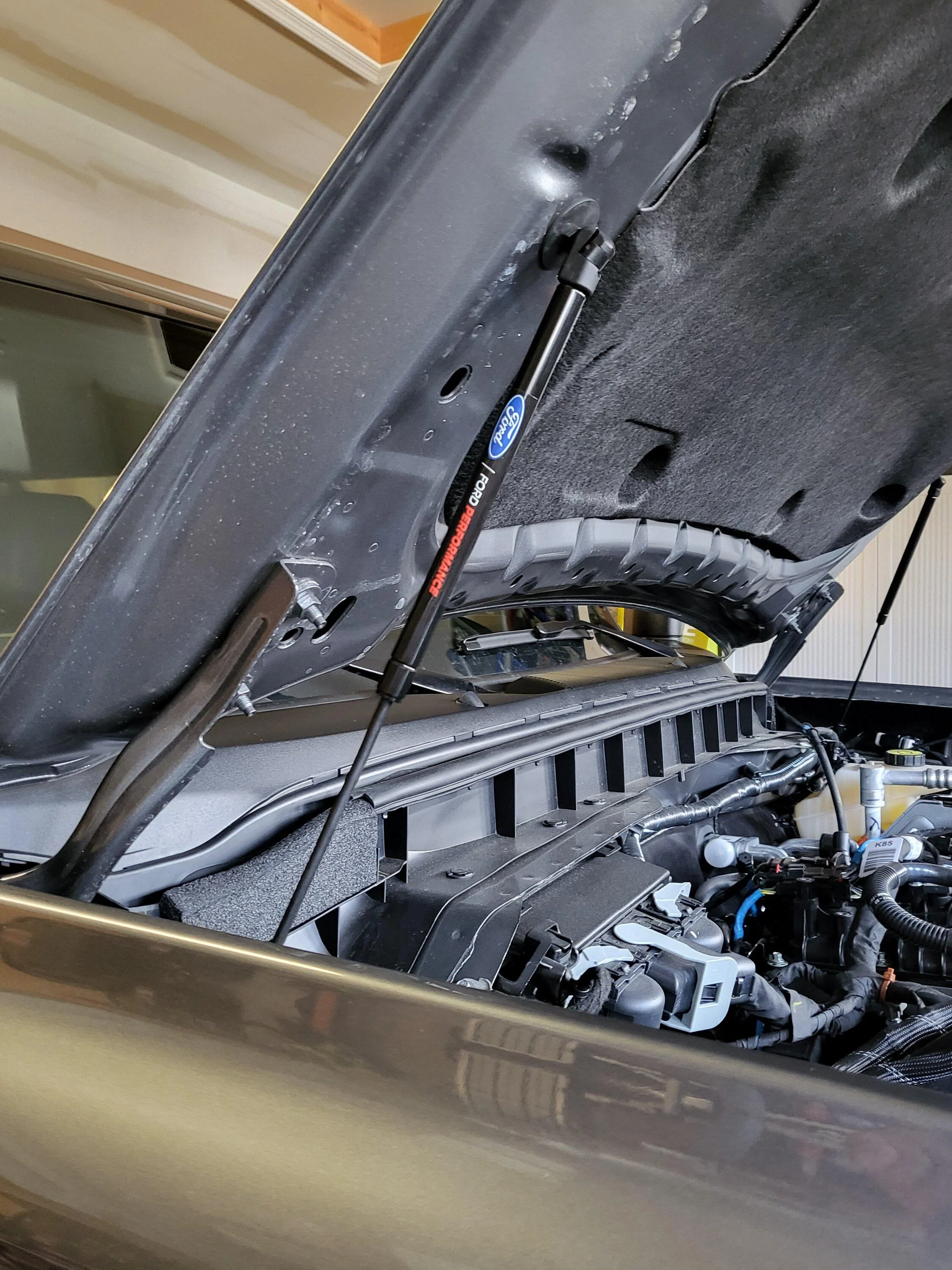

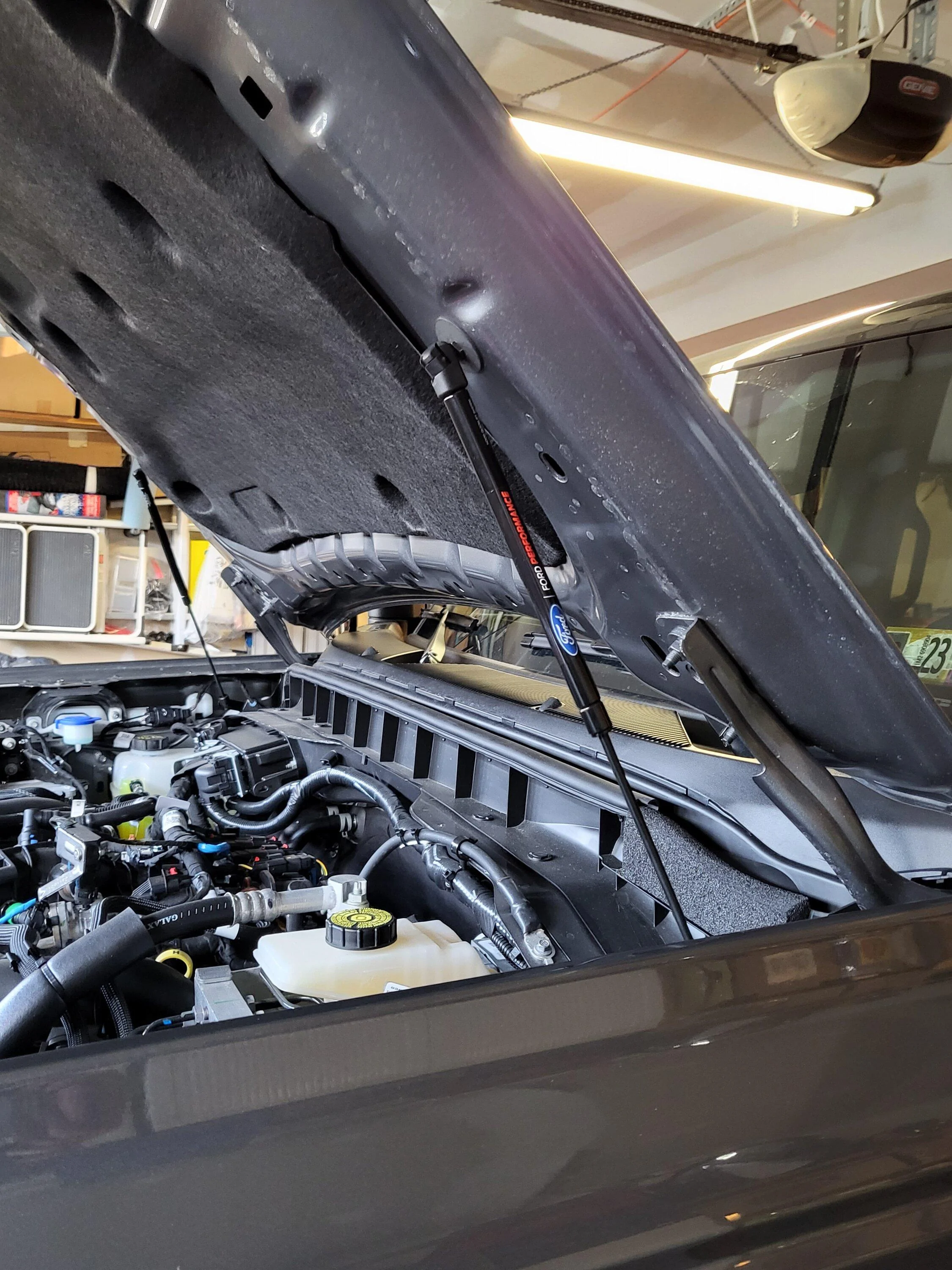

Just installed. World of difference. Easy install. Followed directions -- smooth. I'm 5'8" and I just grab the hood "hoop" as the guy in previous post. No problem
I'm guessing that the individual that could not get them to fit -- must have either been defective OR Maybe they put the wrong vehicle struts in the Bronco pkg. Since they make them for the Mustang, etc.
