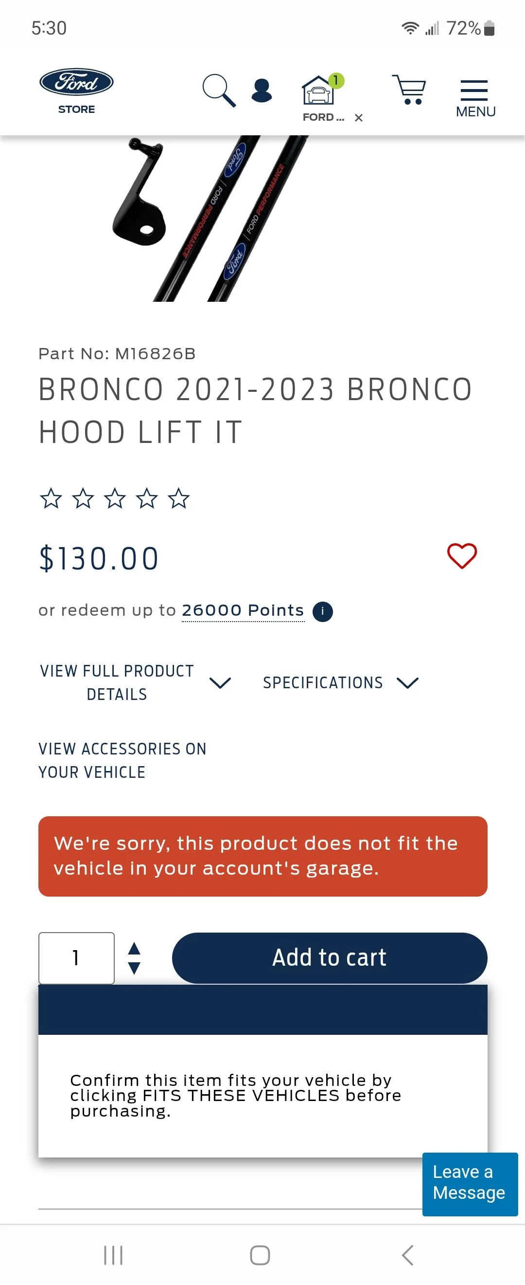

Same here but was getting the same non fitment warning. Says they fit all from 2021-2023 except Raptor and Everglades.
Don't forget the 15% coupon. Brings it to $110 and use free points, cheaper than buying from Redline direct.

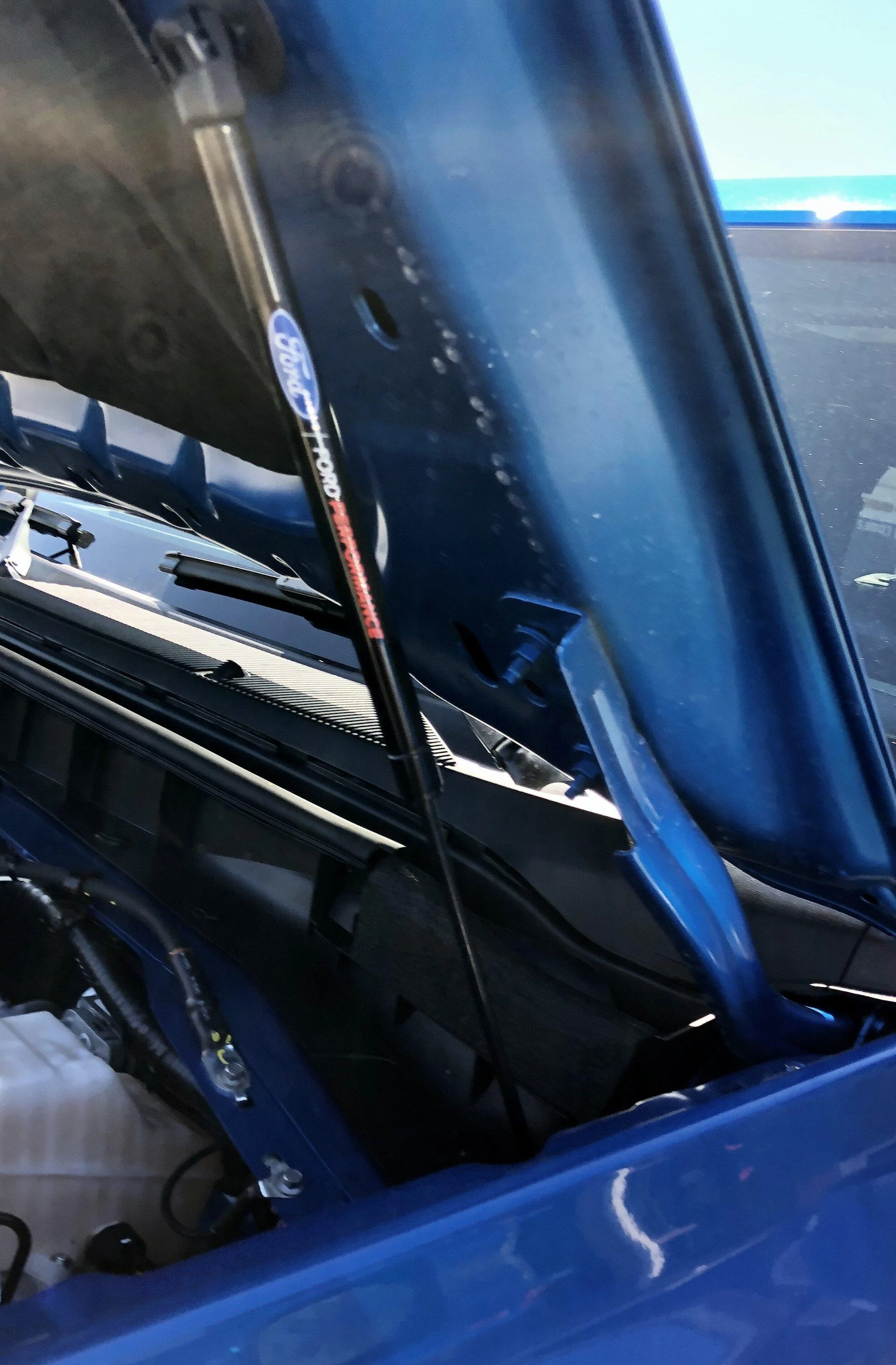

What is the best way to lift the hood high enough to install the struts?
joeb
Joe
Jan 28, 2021
43
456
441
Pennsylvania
FJ Cruiser
Just leave hood on prop while installing hardware on hood and in engine bay ( both sides). Then snap one bottom on then hold hood up and place prop rod down and grab the strut which is connected on bottom --- lift hood and snap the top part on the hood -- one side done.
