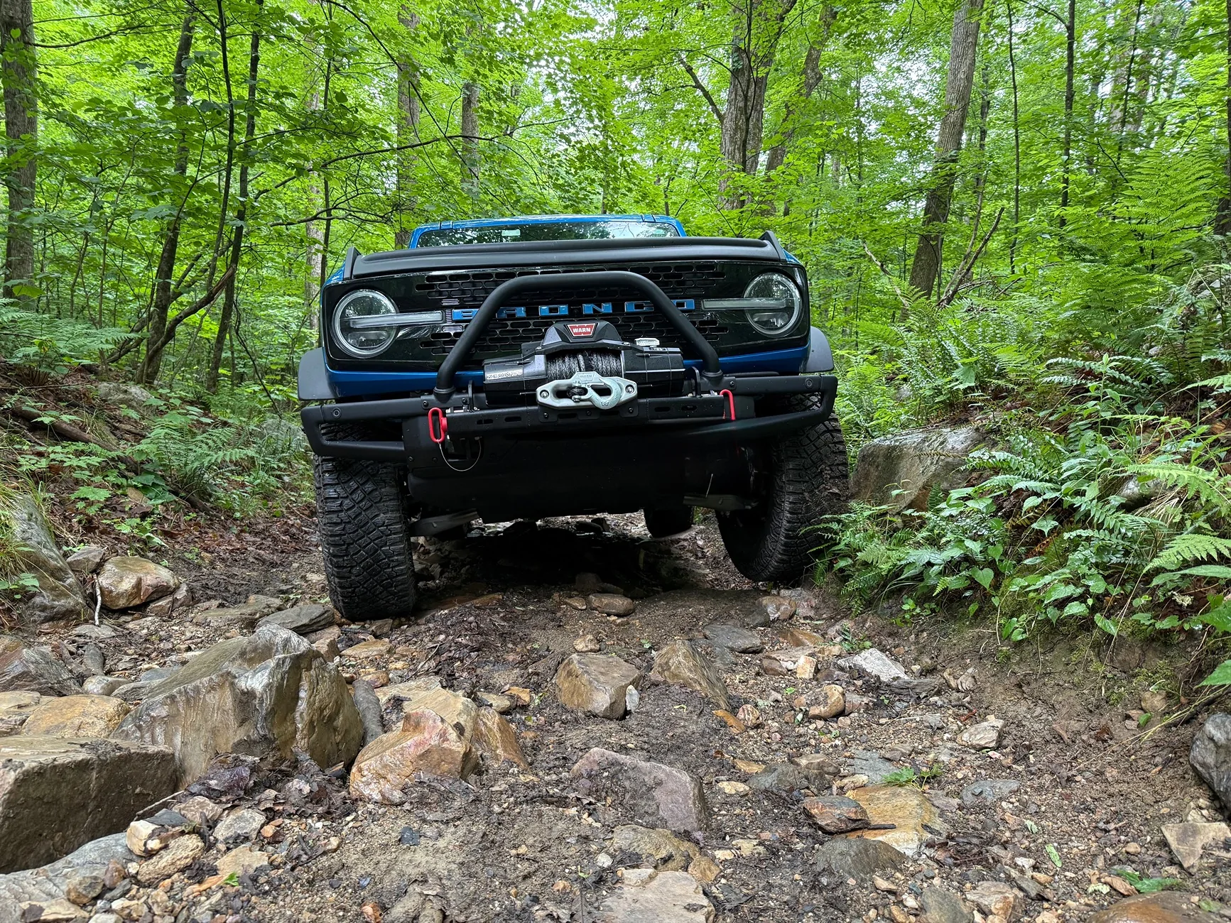

Have you considered a removable witch mount? My Bronco is my daily driver and I only go off-road a few times a year. I didn’t need a permanent solution with moving sensors and cameras so I went with Maximus-3. Once the brackets are installed, mounting and removing is power easy. The most effort goes into snaking the power into the battery, which I use a wire hanger to pull it through, but there are quick connect options available to make that much easier.
Ford Bronco Ford Dealer for Winch Install? 1754308750563-2l
