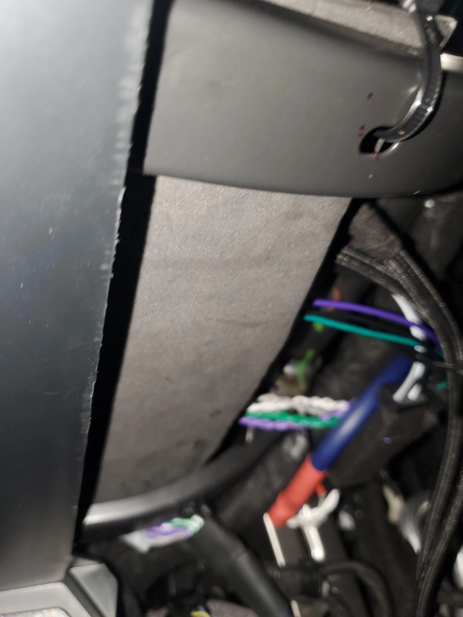

I went with the PnP kit for the AudioControl ACM 4.300. The Key 200 was out of stock and the ACM puts out more power. Mounted above the glove box on those metal reinforcement bars to a scrap piece of acrylic sheet with a layer of CCF glued on for cushioning and secured via zip ties. There was a bare metal bar directly to the left under the dash that appeared to have several ground points already and I used that to ground the amp. Even with the GTO signal sense on, I get some light popping through the rear speakers upon turning on and off. I'll probably re-run the ground directly to the battery when I run the wires for the sub amp which I'll probably do next spring. I'm running Morel Maximo Ultra Coax 402 in the dash with 47uF bass blockers and Morel Maximo Coax 6 in the kicks with the factory speakers in the back. Plan is to move the Coax 6 to the back with Mabett speaker pods and install the Ultra Coax 602s in the kicks.
Sub plan right now is an Alpine S-A60M for amp and an S-Series 12 inch sub in a sealed box, but I'll see what JL does for a Stealthbox and then probably use whatever JL amp is recommended.

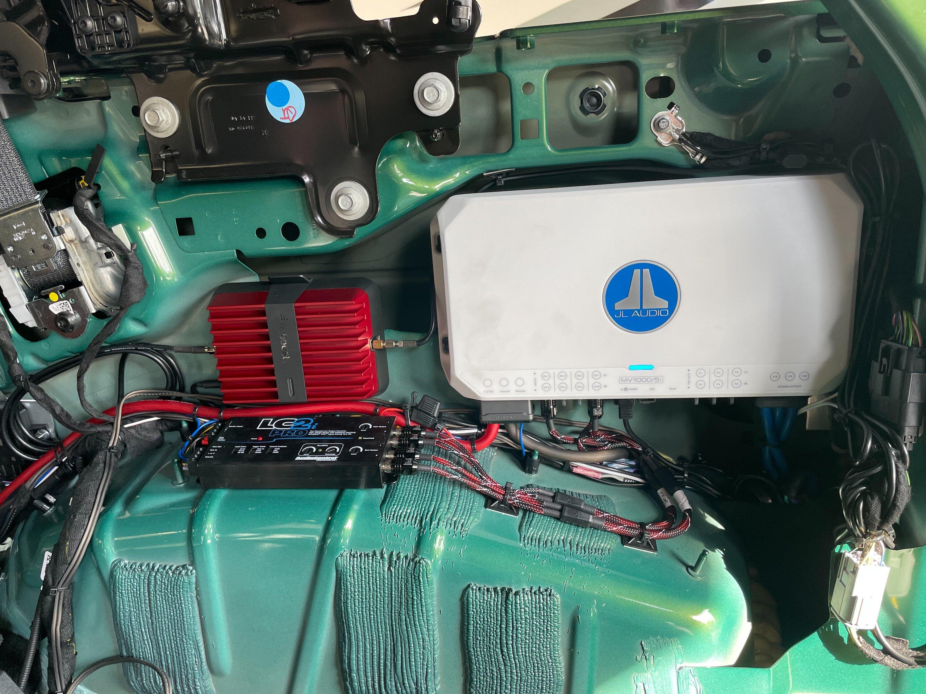

JL Audio MV1000/5i amp

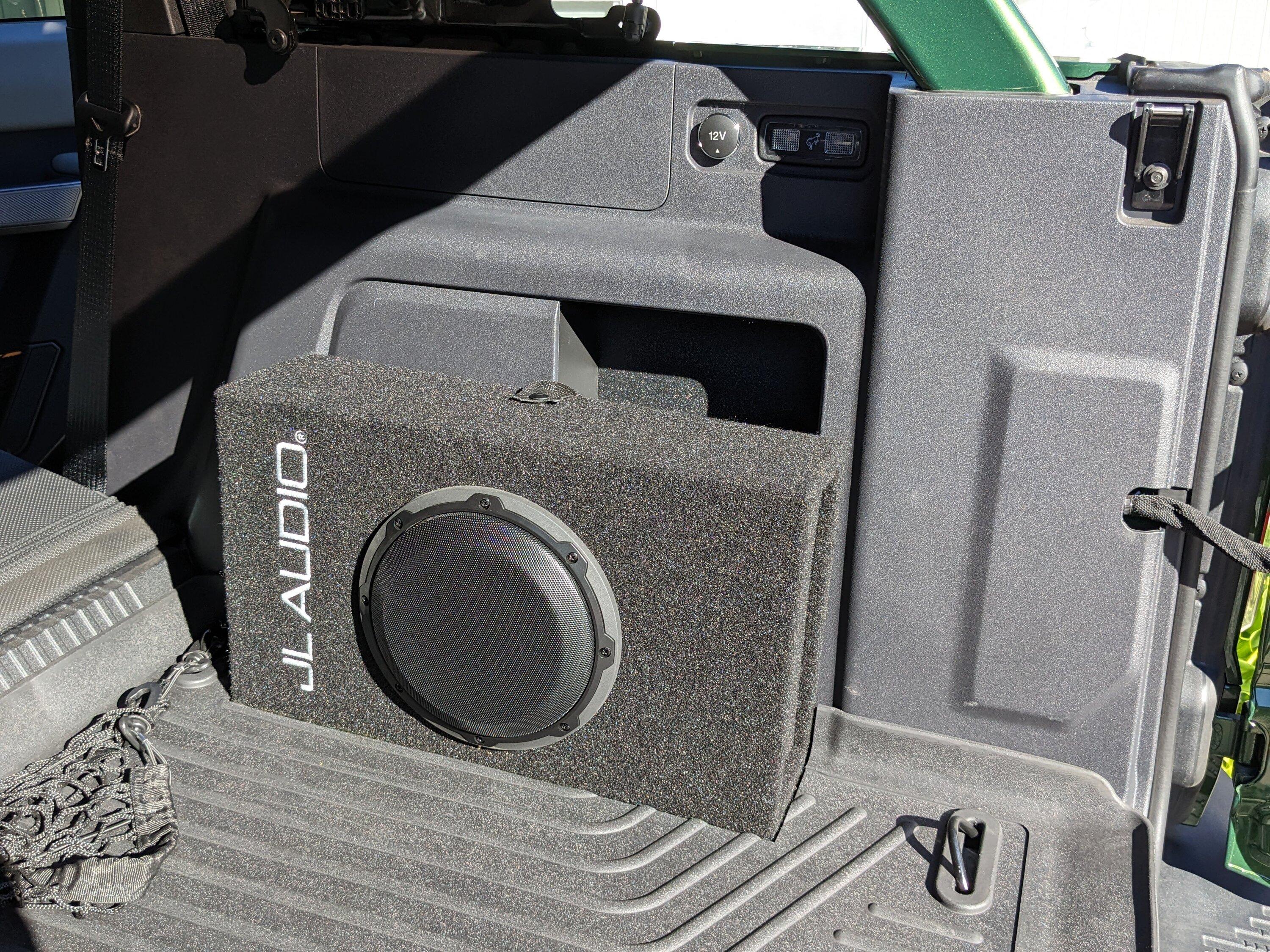

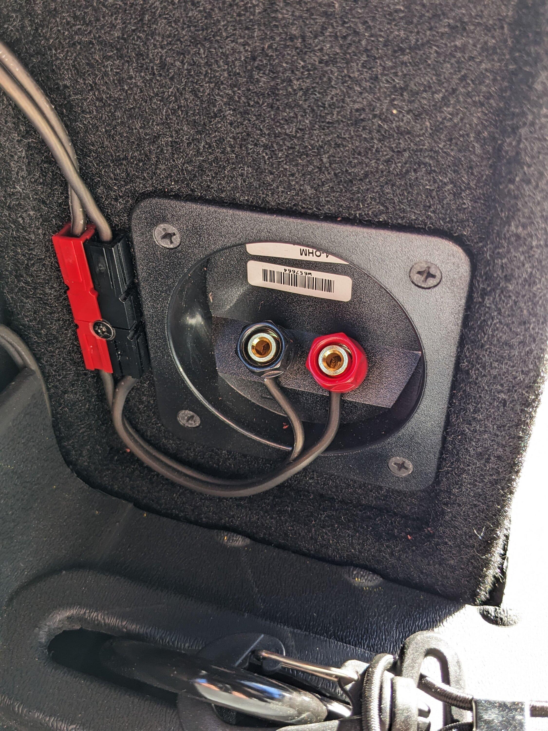

JL Audio CP108LG-W3v3 sub, wired to an Anderson connector behind the rear seats for easy unplug and removal when I need the full cargo area

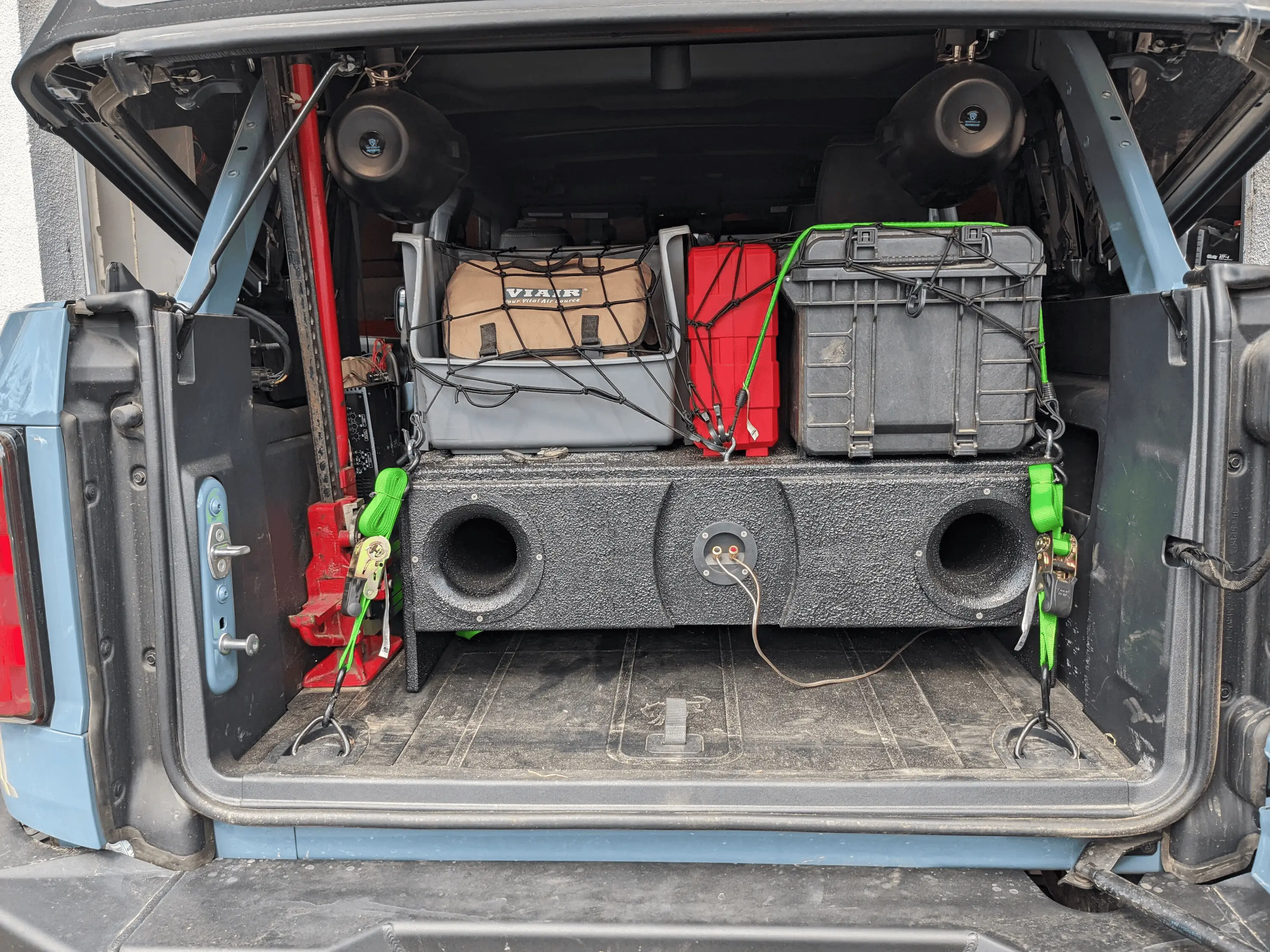

Skar M5001-D (500w Monoblock) powering a custom enclosure with two Skar 10" Subwoofers, Kenwood KAC-314 powering two Rockville RWB65B Wakeboard Towers in the back. Front is un-amped, Focal Auditor ACX100s in the dash, and stock Kick Panel speakers.
