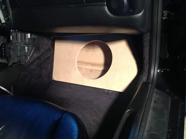

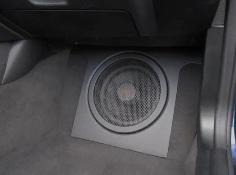

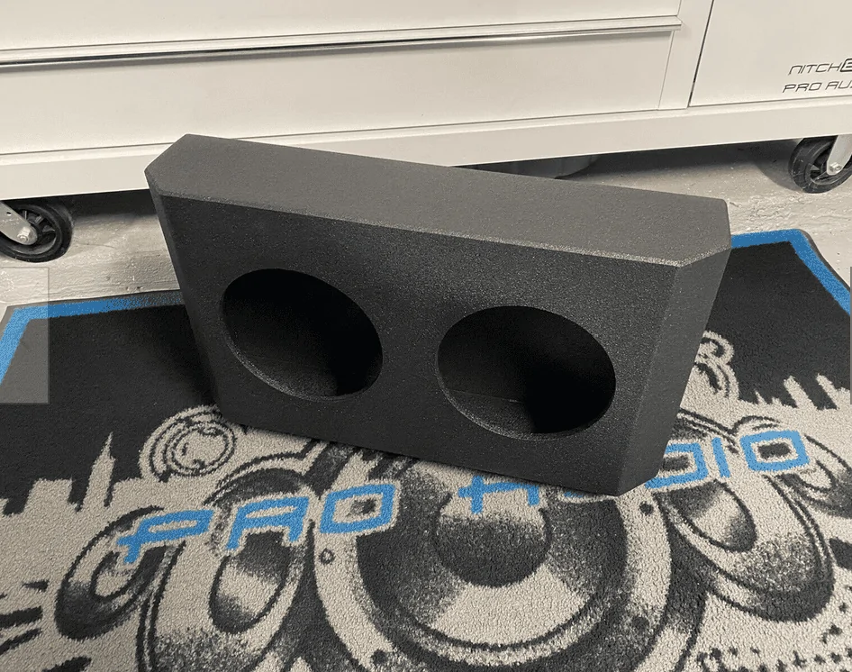

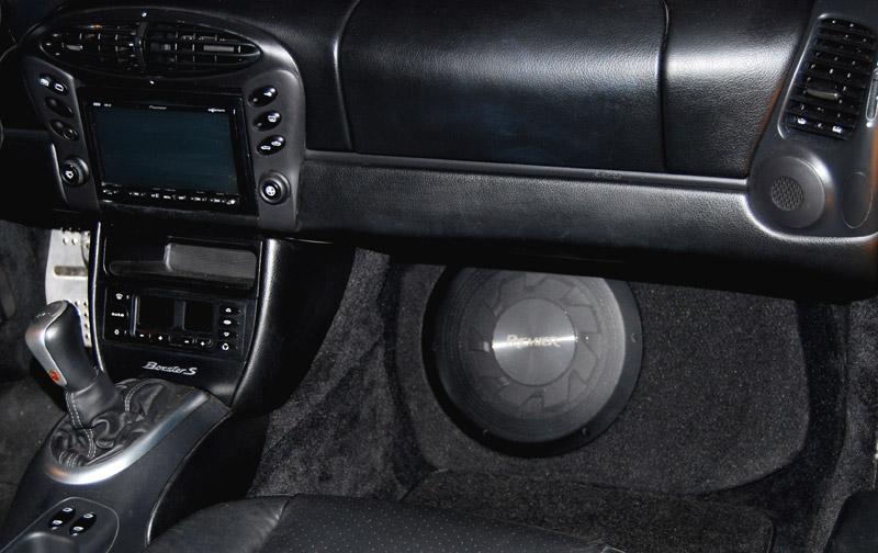

Has anyone done a footwell Subwoofer on the front passenger side footwell? If so, can you share pictures?
I think there is enough room to get an 8" or 10" custom enclosure built and installed and sacrafices minimal to no leg room. Thoughts? Concerns? Pictures are.for other makes and models.

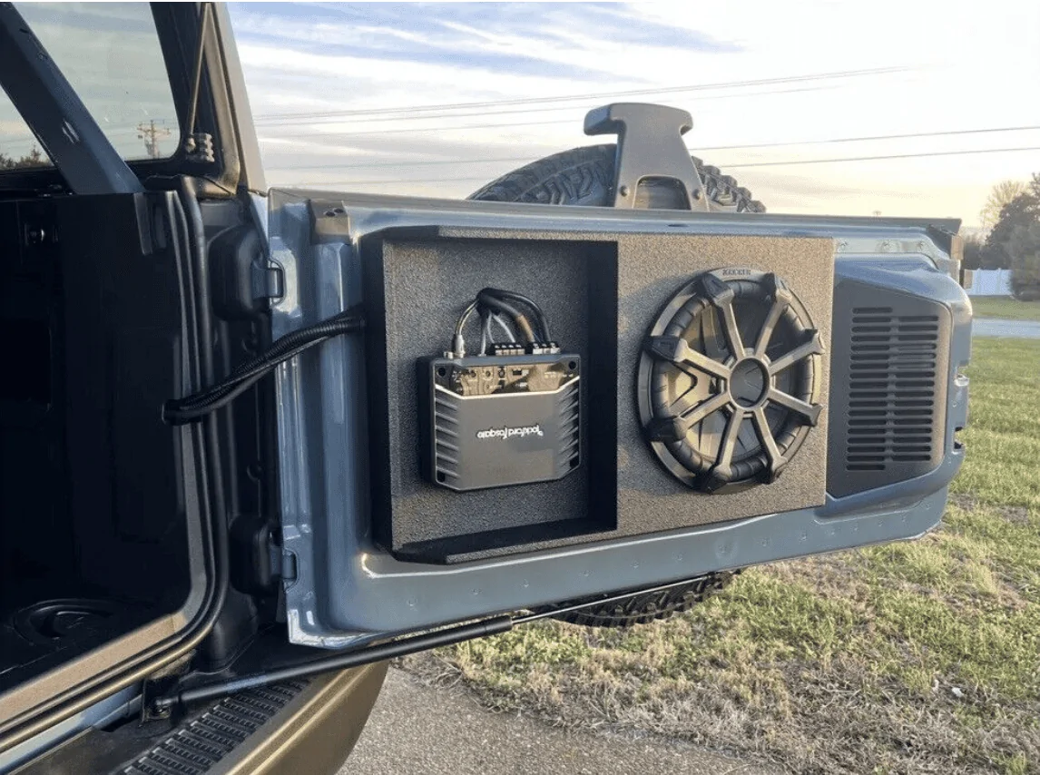

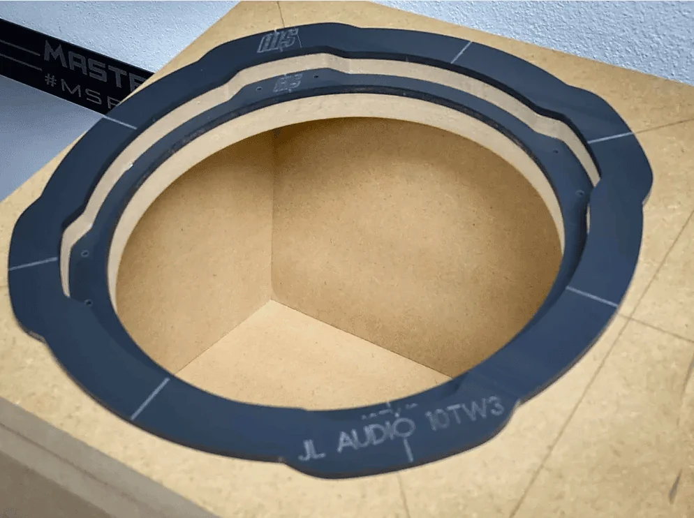

I got tired of waiting for JL to come out with a Stealthbox, and for the price I think I can do a little better. I asked Jeep Pro to modify an existing box they offer with the 10TW3-D4 recessed template.
I can wire the two Subs to 1 ohm and run off of my Kicker Key 500.1. Later if I want to upgrade the sub, it should more than handle the upgrade. I don't really think I will need to as I am not really a bass head. All in I will be paying about $1266.
I will post a picture once installed.

It will be a tailgate. I had read that people were having a difficult time putting in a better speaker in the Stinger Tailgate, and its a single phoenix gold.
I had already tried a kicker downfire in the trunk, but it took up too much floor space. I had considered hanging it on the tailgate, but it only comes in 2 or 4 ohms. I wanted two 2 ohm speakers I could wire to 1 ohm for my amp AND I wasn't against a tailgate sub, but I wanted a little more quality speakers.
It is probably just in my head, but the heart wants what the heart wants. I was never going to fit two 10" subs behind the panels. =/
Edit: Not sure which seat you mean. There is no room under rear seats and the largest anything you can probably fit under front seats would be maybe an 8, but it really isn't enough room. Trunk or rear panels, that's about it. He has a variety of versions. I wanted something lower profile (Thinner) than the stinger. This box is made for low profile subs maybe 6" total in depth. About the same thickness as the Kicker 12" downfire.
