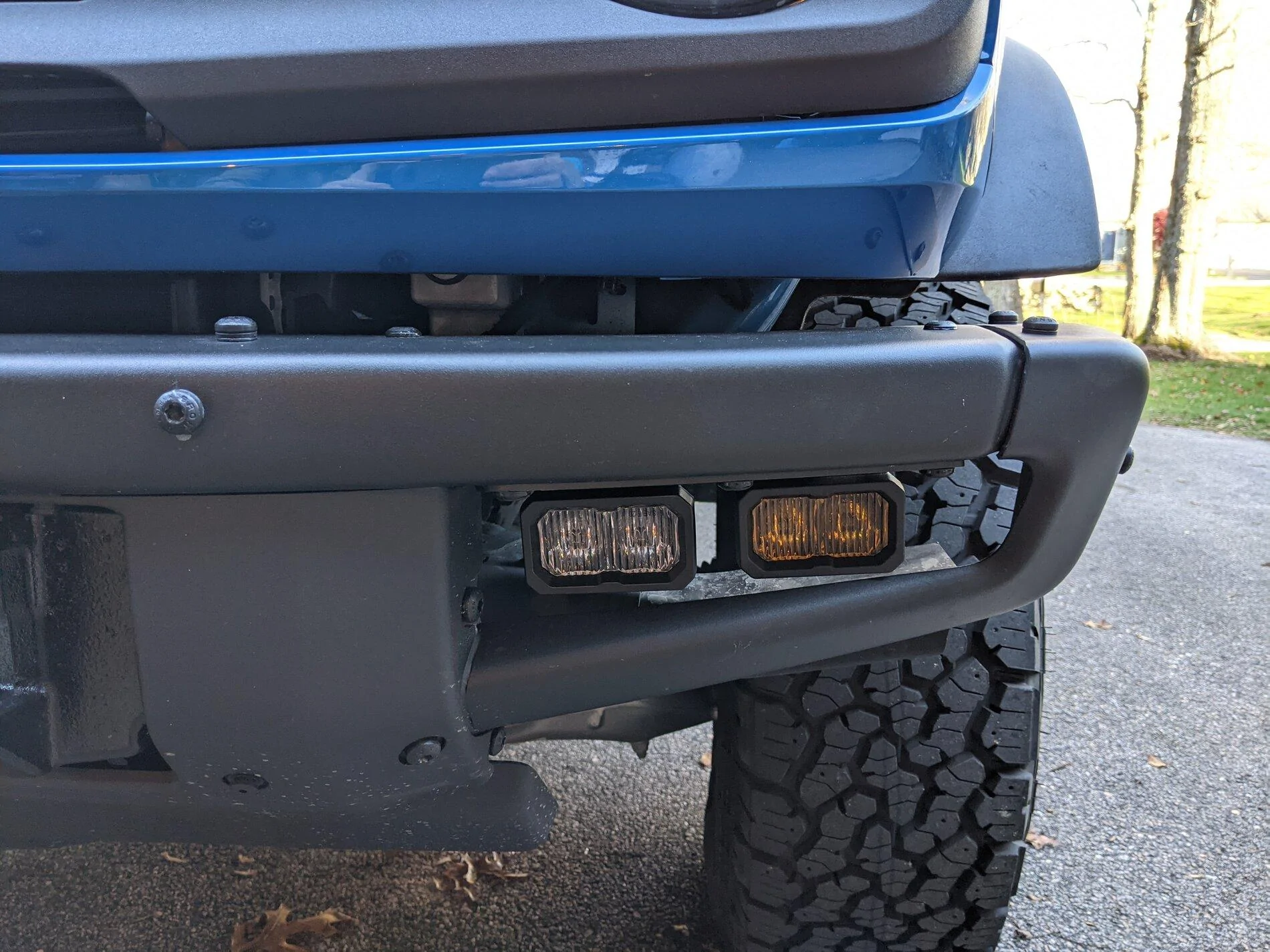

I ordered the fog light pocket kit from Diode Dynamics with 3 all clear lenses for each side and with all 3 having amber back lights. It's up to you as an individual to chose your preference. (I used the bigger SS3 and 2 each SS2 units as my preference)
( See @Bigmoose's nice clean 2 light , 2 color install above as his preference)
It's a little daunting at first . I called one supplier and they told me: " read the website, that's what it's for" . VERY RUDE,... so no issue at all....I spent my money elsewhere. Chris or the Diode folks will be happy to help you. Bottom line.....
You can get any backlight color and any lense color, mix and match in the size light that you prefer. Additionally, you can select from multiple brightness outputs ( candelas) to get brighter and BRIGHTER and VERY MUCH BRIGHTER. Read this as $, $$, or $$$$.
Wiring them up is really straight forward: Your back lighting gets spliced into the factory running light wire with no need for using an AUX switch. Fog lamps will either use the factory switch if you have the LUX / High package option. If you do not have this option, you will use an AUX switch . Which aux switch?........ it is based on amp draw of your chosen lights.

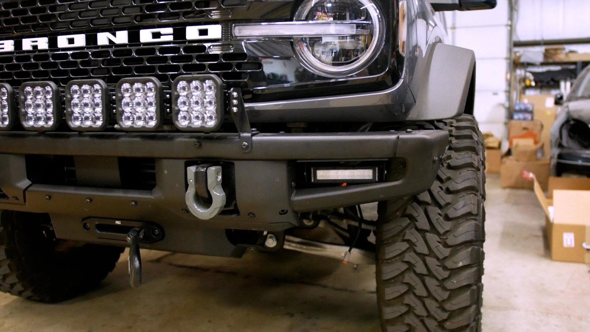

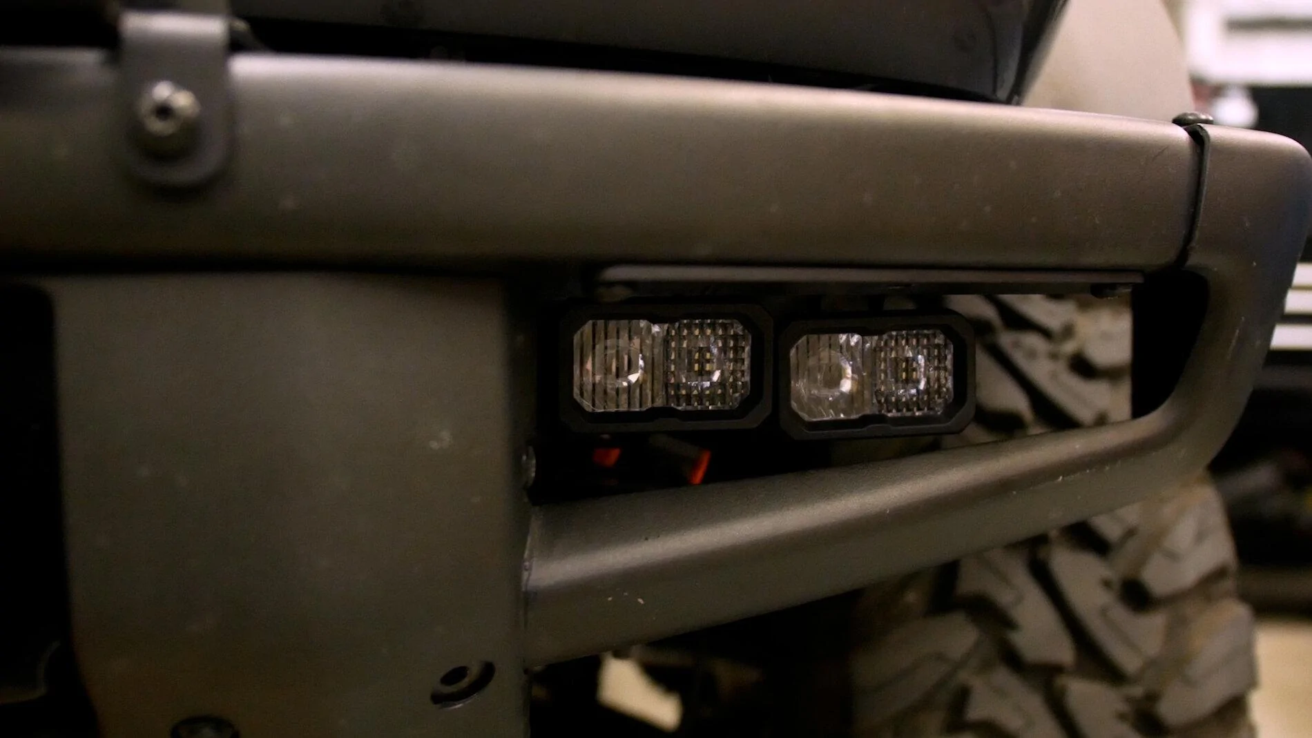

With the release of the @Diode Dynamics Fog light pocket kit, we knew it would be a winner! In this video we show you that standard kit, along with some other custom options to fit any need or budget! Check it out!
What winch system do you have installed in this video? So that just mounts flush below the factory bumper? Like the look of that and your lights.
