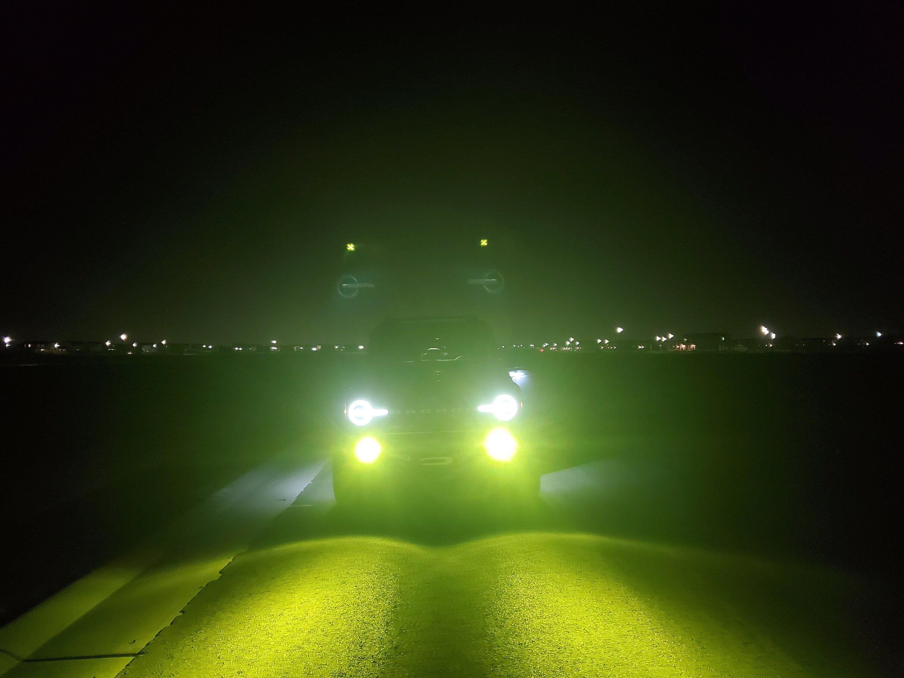

Yup they sure did. And what was really nice is that they came with a little bit of that non-split wire loom. So after I cut off the male plugs and soldered & shrinked the wires to new fogs, i slid that wire loom over the patch job and boom!
Note: they can plug in either way and still snap..so If your fog light doesn't come on, try reversing it. I can also take a picture of which wire the red should go to.
Stock Fog Plug Adapter... $8
https://www.amazon.com/dp/B00TXRWOPA
And in my case, cheap Fogs.... $23
Amber LED Pods Light, ACEC SHOP... https://www.amazon.com/dp/B0978TLJSW
Ford Bronco Fog light plug part number? 20221222_174338
