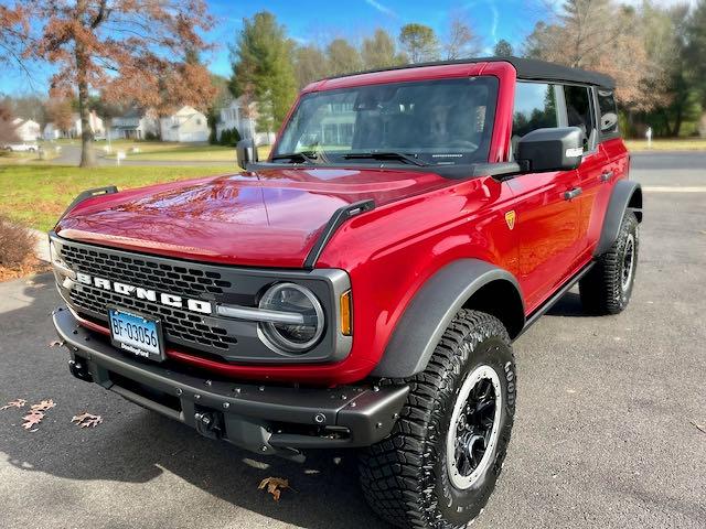

I picked up my beauty the other day and I saw my dealer put plates on the front of my car because state law in CT requires two plates. When I removed the front plate I saw two gaping holes where the front bracket was installed. Now I have a dilemma of leaving the plate off with two holes or putting the ugly thing back on!
I don't want it on, but I hate seeing the holes! Do any of you have a quick solution without the trip to the body shop? I am so angry that they put it on without asking me!

Sadly many of us are in the same boat. In order to have it look correct, you could take that valance off, sand it, filler, level and then paint, or just order a new valance, and wait for the backorder process, then paint it, Also possibly get an aftermarket bumper that requires that valance to be removed. Any way, its a good amount of work. I never liked those plugs, its a reminder that holes are still there. In the end, It is your rig, so you do you. Good luck on the process

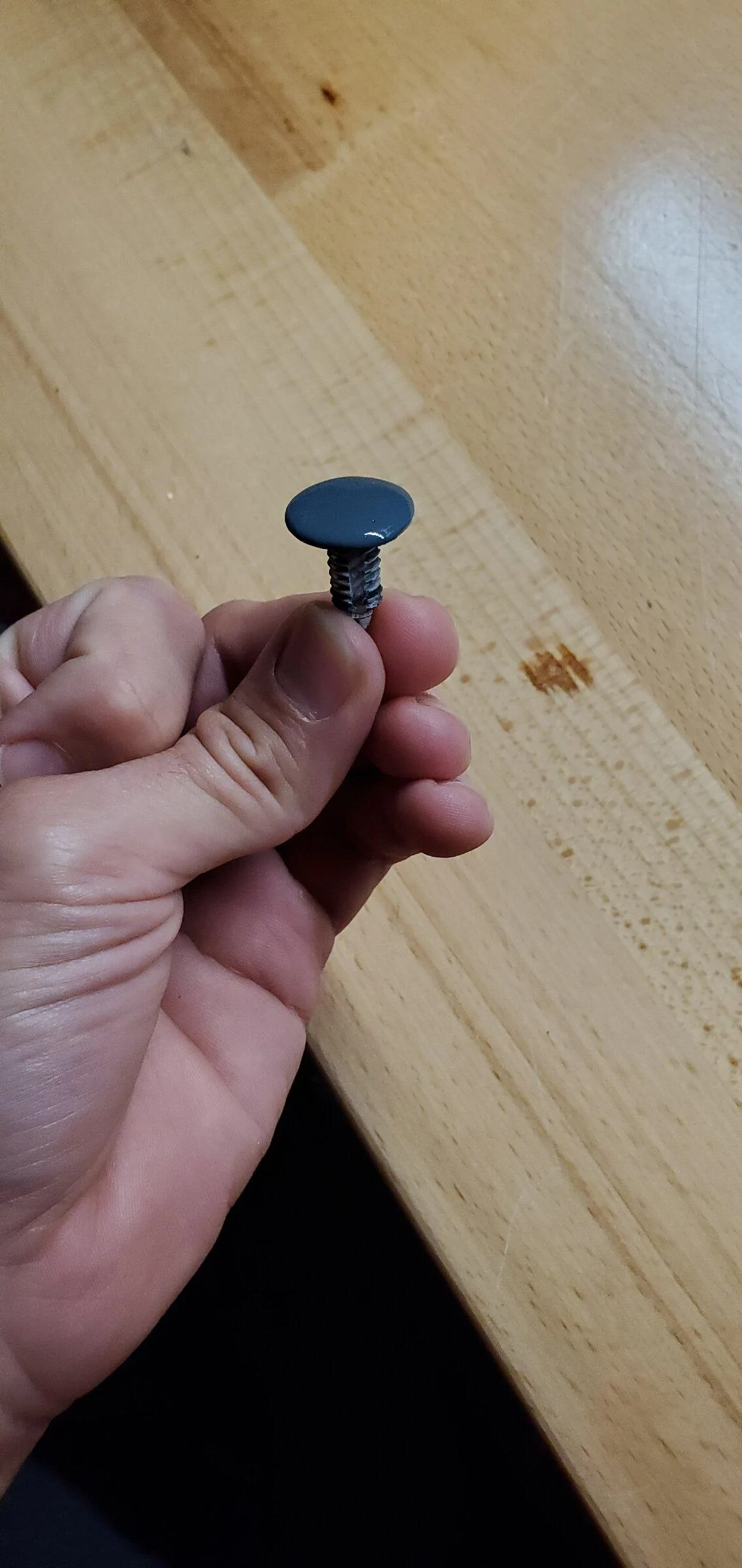

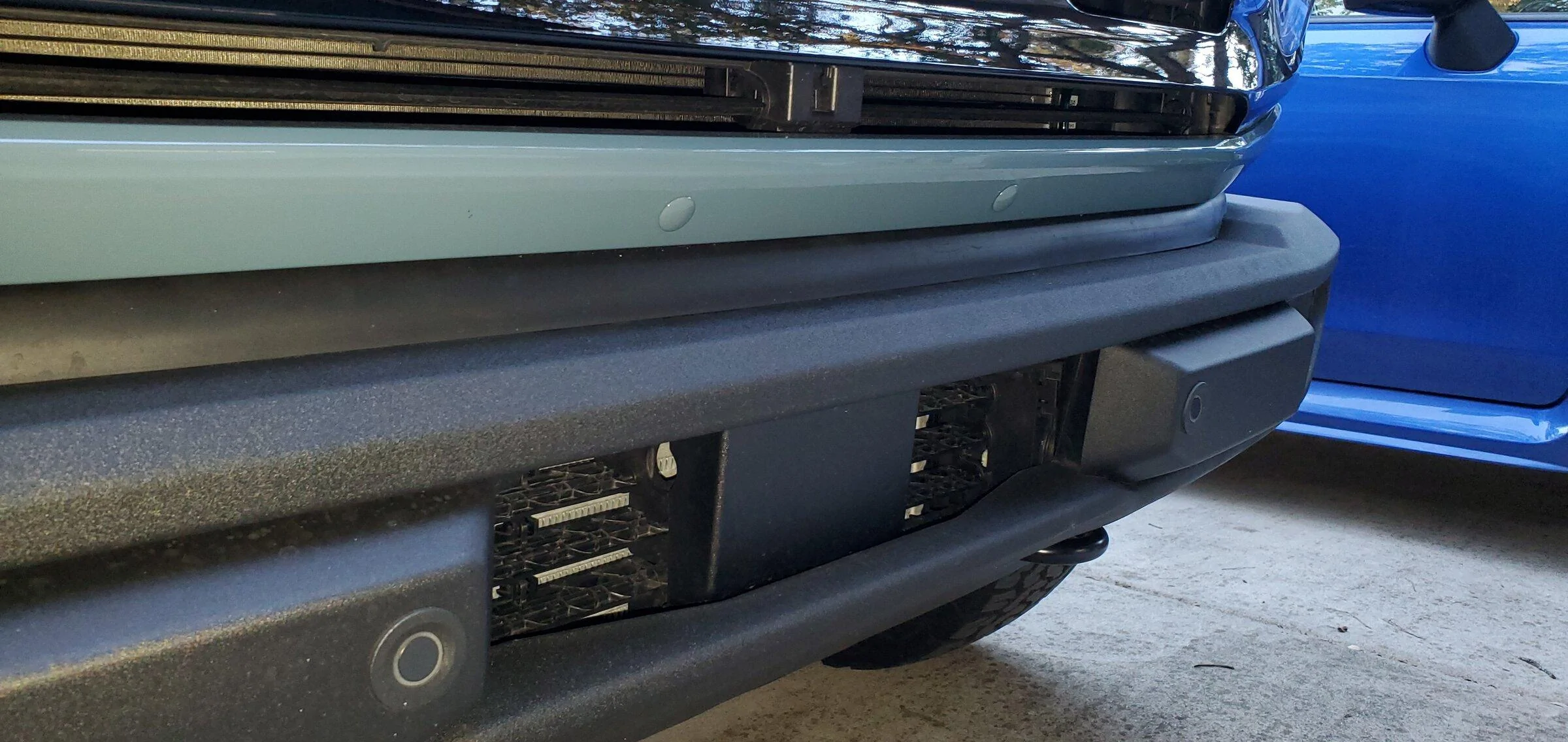

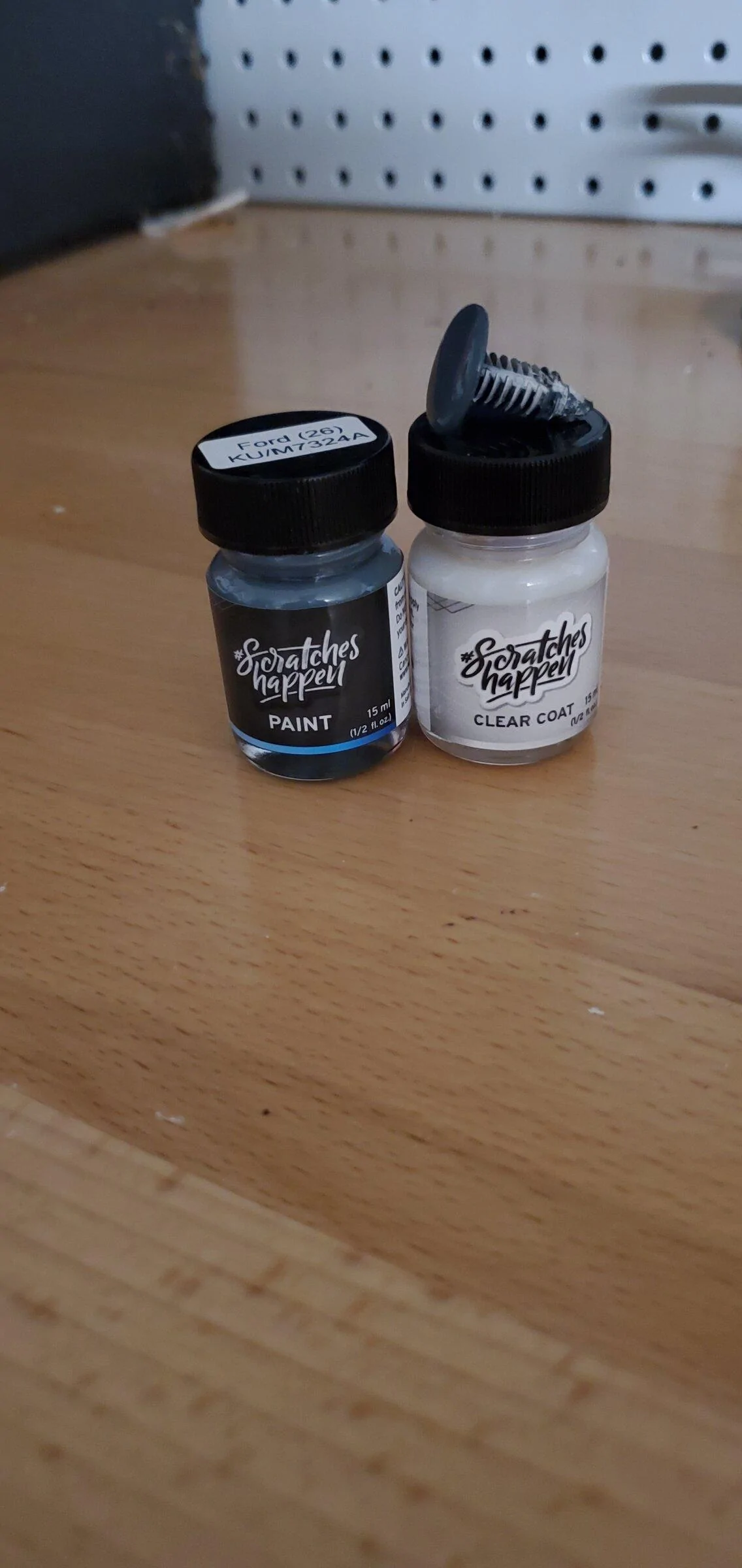

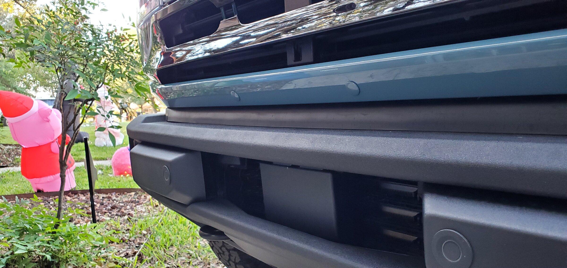

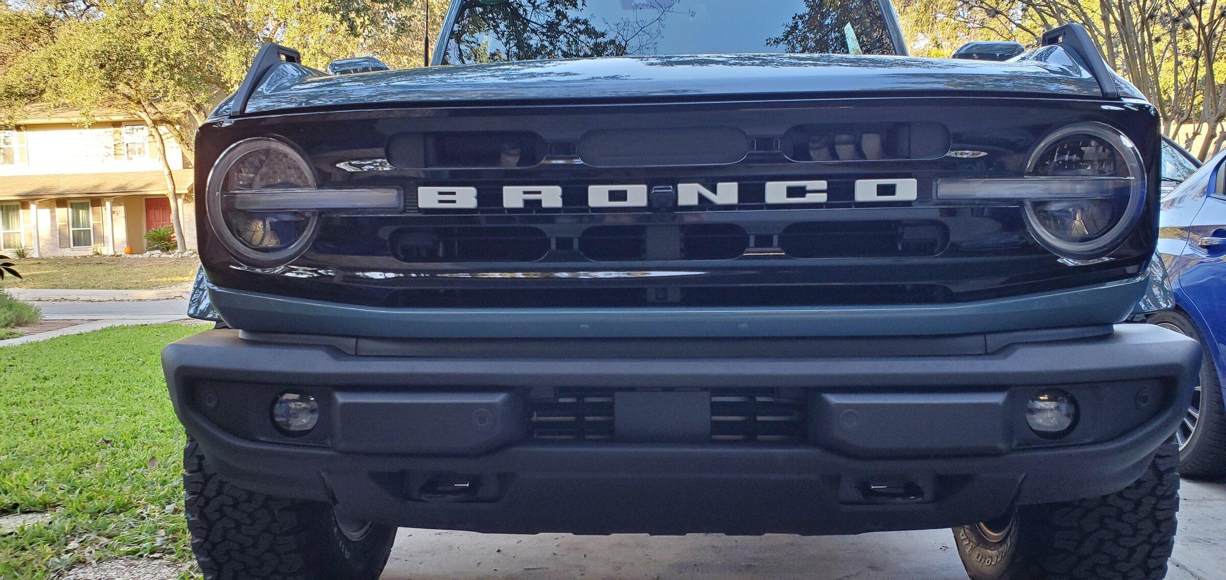

There was another thread about it, but this is the solution I did. Got some cheap 1/4" bumper fasteners, touch up paint, and plugged the holes.
