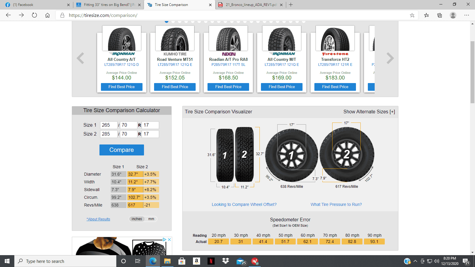

Will the Badlands Factory Wheels and tire fit on the Black Diamond without modification? There are going to be some takeoffs from Badlands available. Vice versa takeoffs from Black Diamond too.
Ford Bronco Fitting 33” tires on Big Bend? Screenshot (321)
All signs point to yes right now. That's what I'm doing with our BD. I'll be putting BL take offs on the truck once i can get them.

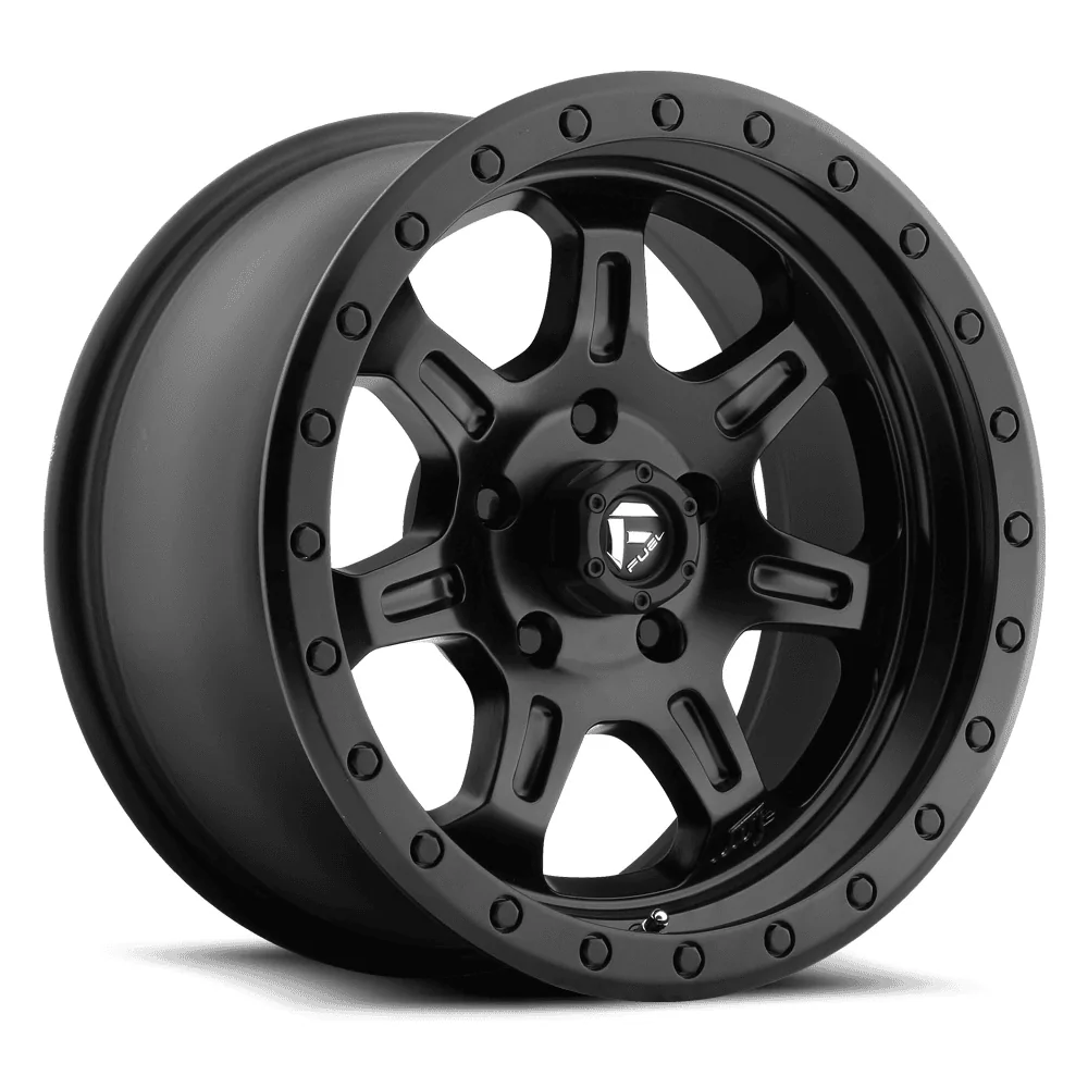

these look pretty nice. Needs 6 bolt pattern, and verified for Bronco though.
Ford Bronco Fitting 33” tires on Big Bend? 1607914693038
