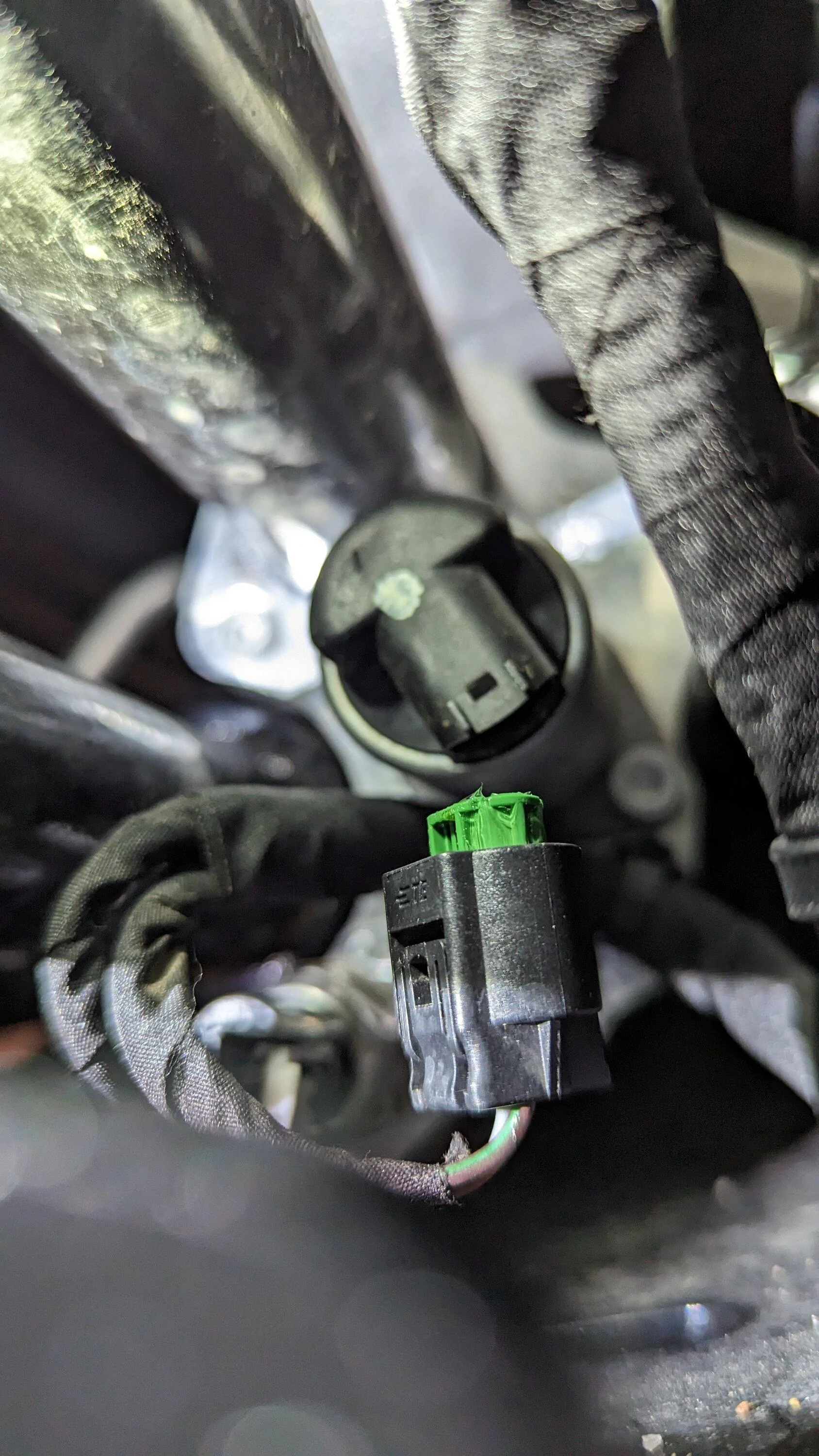

now that all the wetness has dried off and i am not laying in a puddle. i found a very lose wiring harness that fell off as soon as i touched it:
Ford Bronco first minor issue (service sta-bar) - possible easy solution PXL_20230206_165216775
i plugged back in, started up the bronco, but the warnings are still there.
so i'm pulling the battery negative for 20-30 minutes to see if that clears up the issue. i have a feeling this wiring harness didn't get clicked in from the factory, and snow pushing up there after getting stuck put it at enough of an angle to lose connection to the sway bar module.

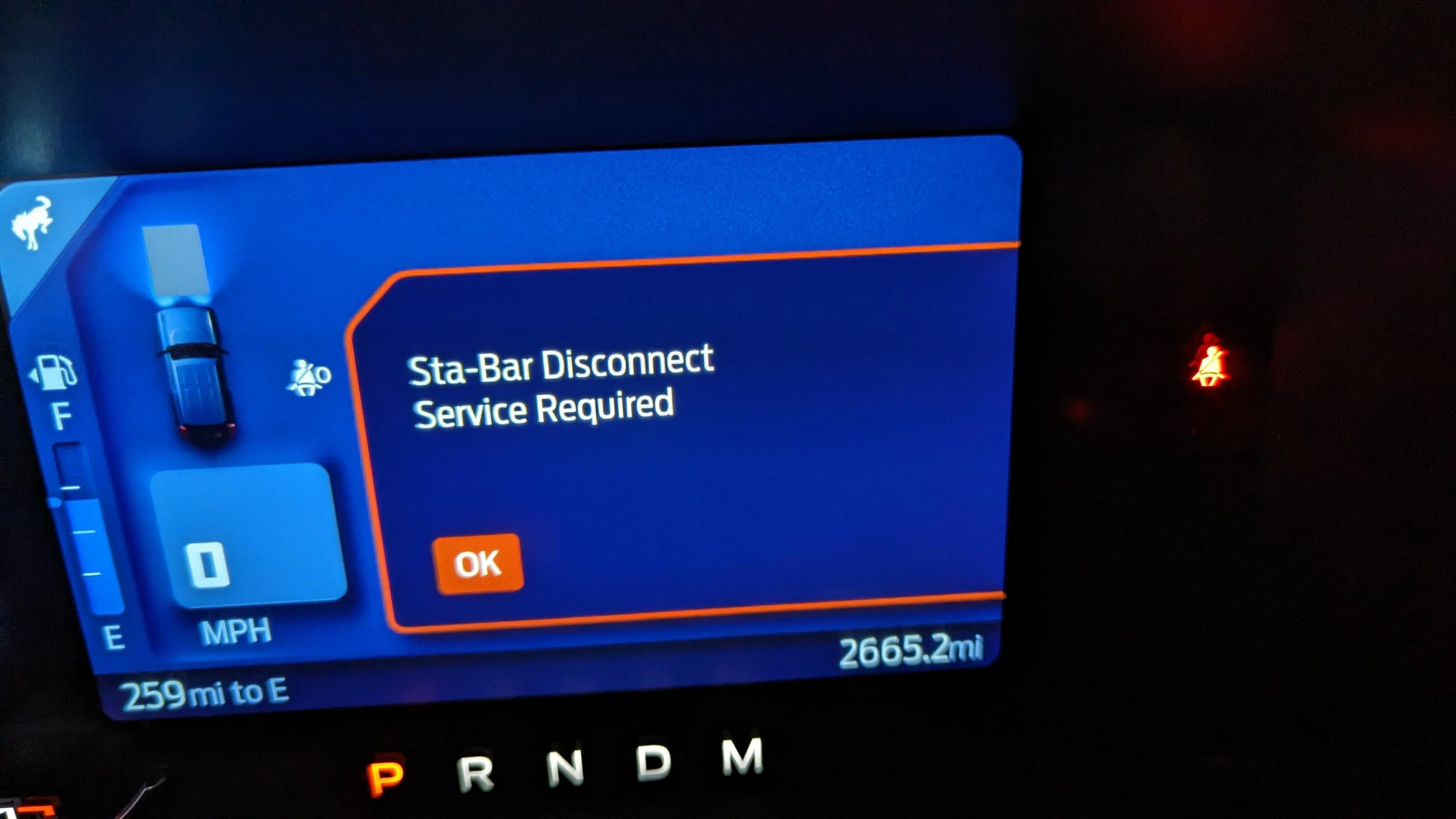

Ford Bronco first minor issue (service sta-bar) - possible easy solution PXL_20230205_180839131
will report back if this fixes my issue, or whether or not i have to run to my dealer for service.
