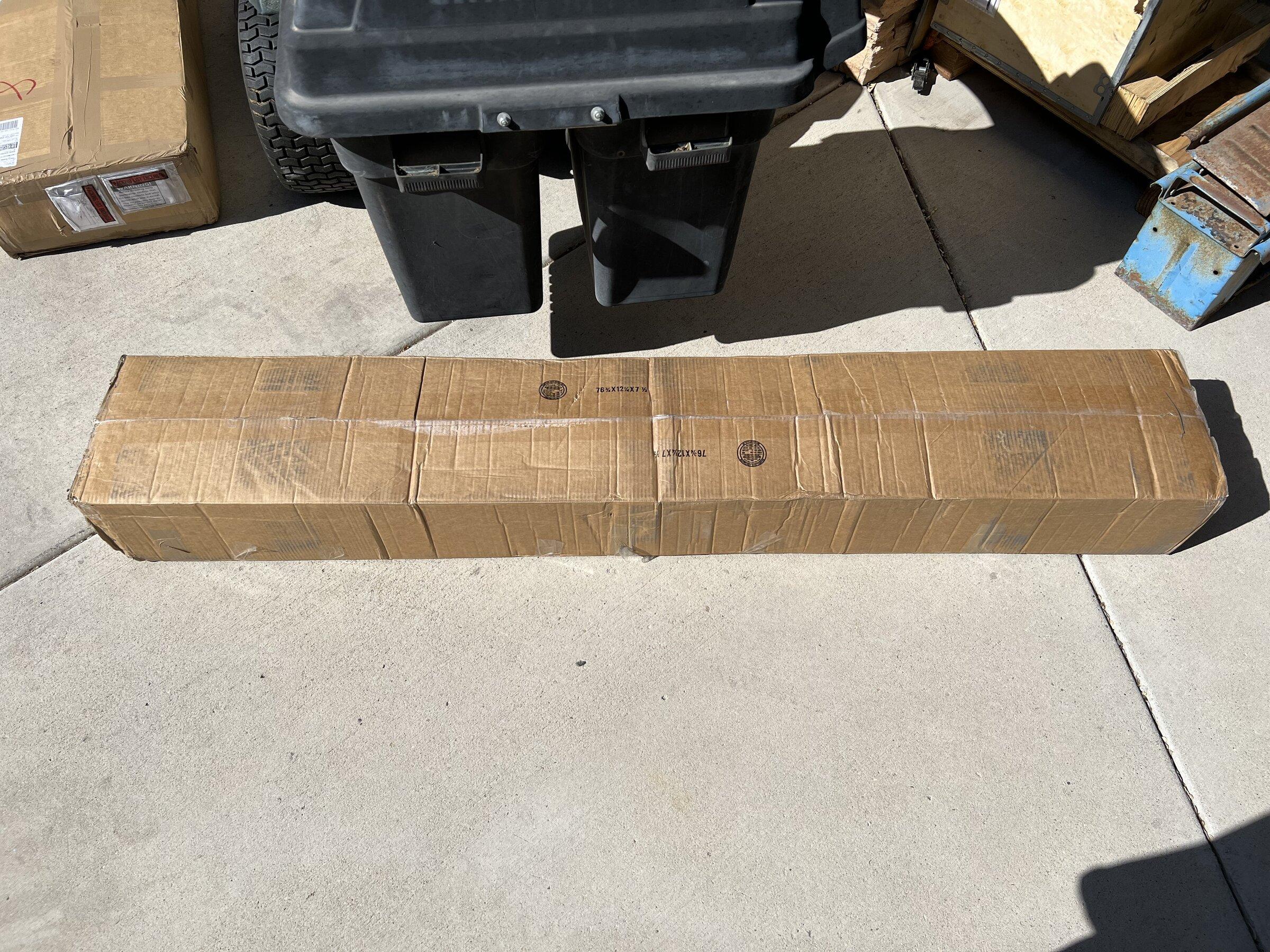

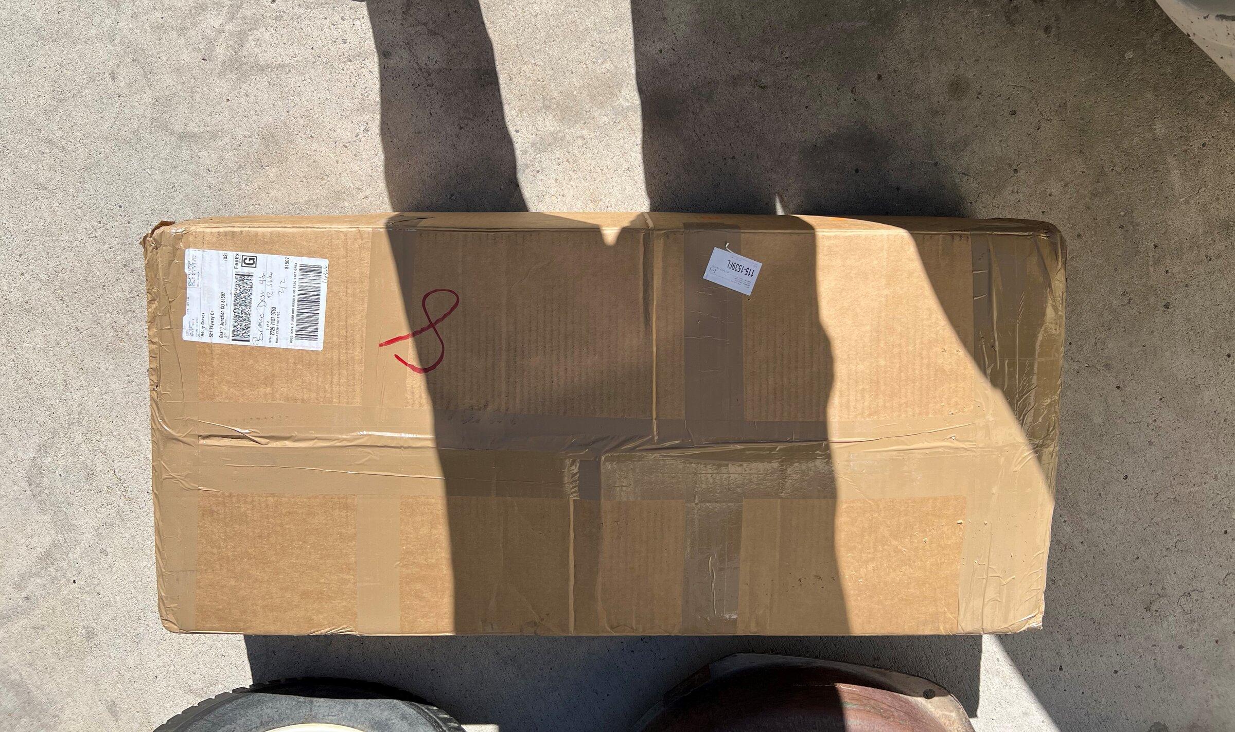

THEY ARE HERE!!!
Ford Bronco Finally Frame Mounted Sliders from LOD OFFROAD!!! Steps
Ford Bronco Finally Frame Mounted Sliders from LOD OFFROAD!!! Steps Hardware
I will unbox and post more pictures shortly. Unfortunately my Bronco is at the Dealership getting the new hood seals installed to stop the whistle on the highway.

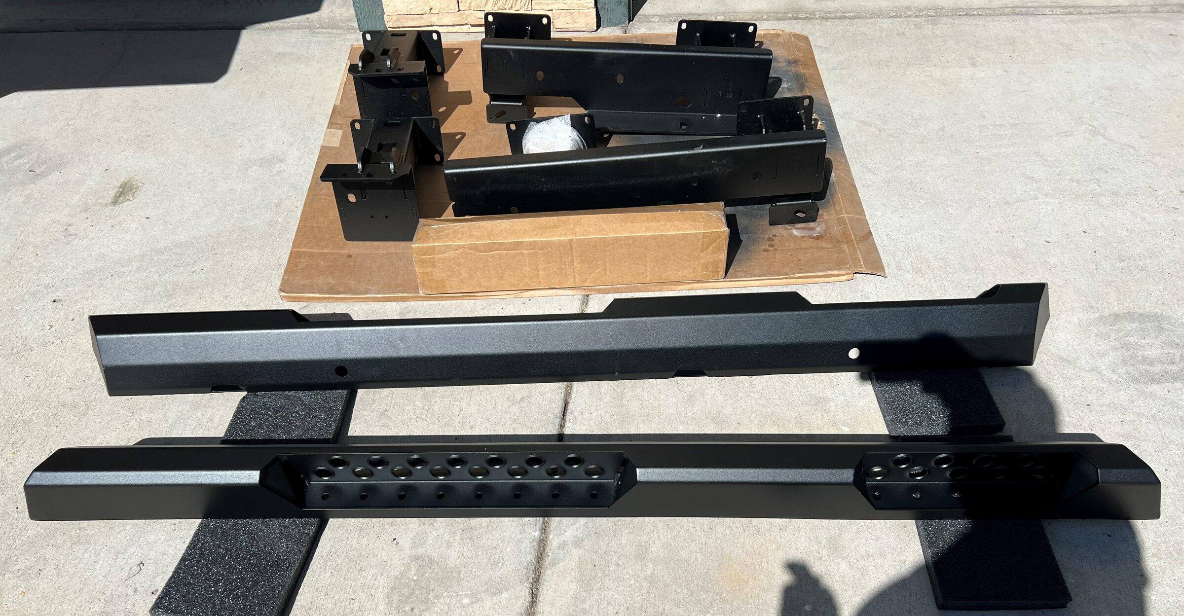

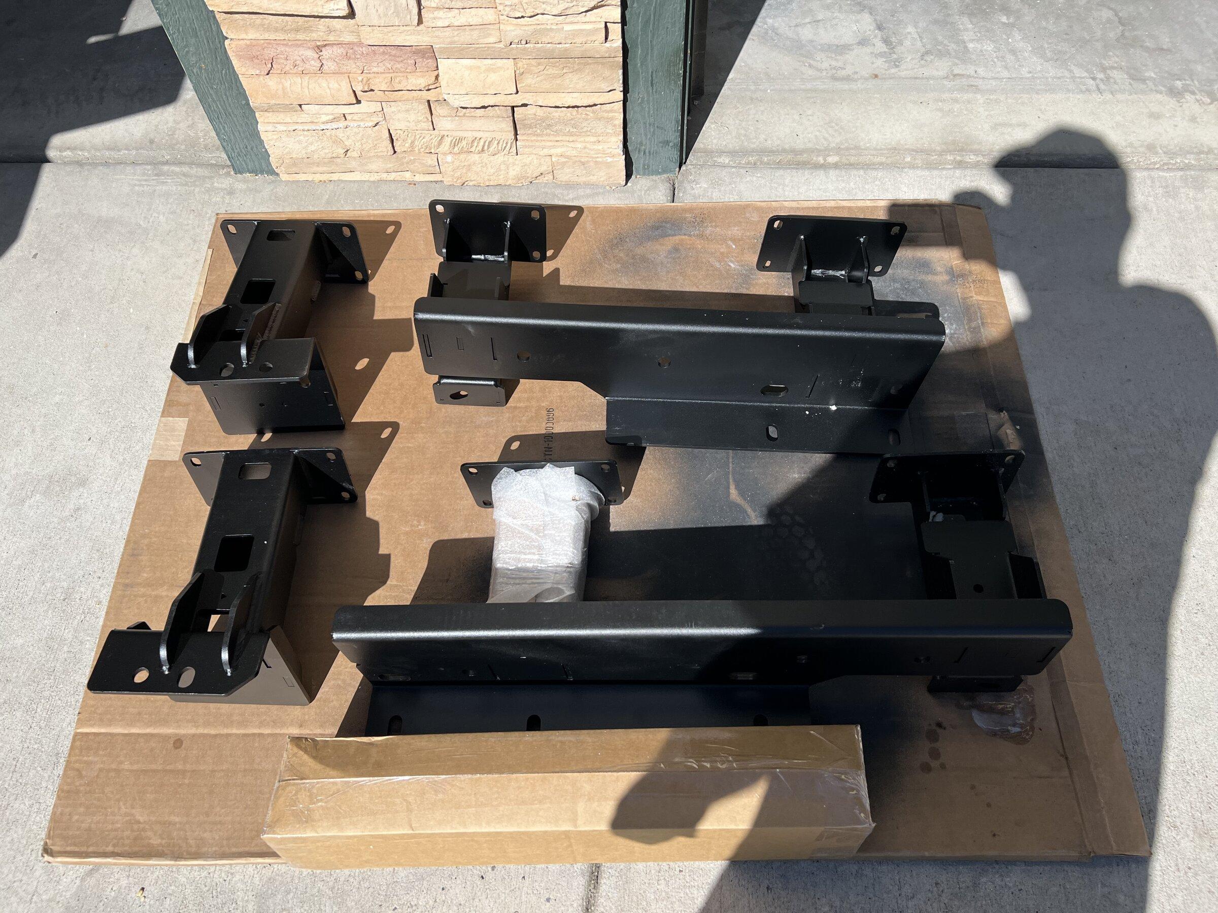

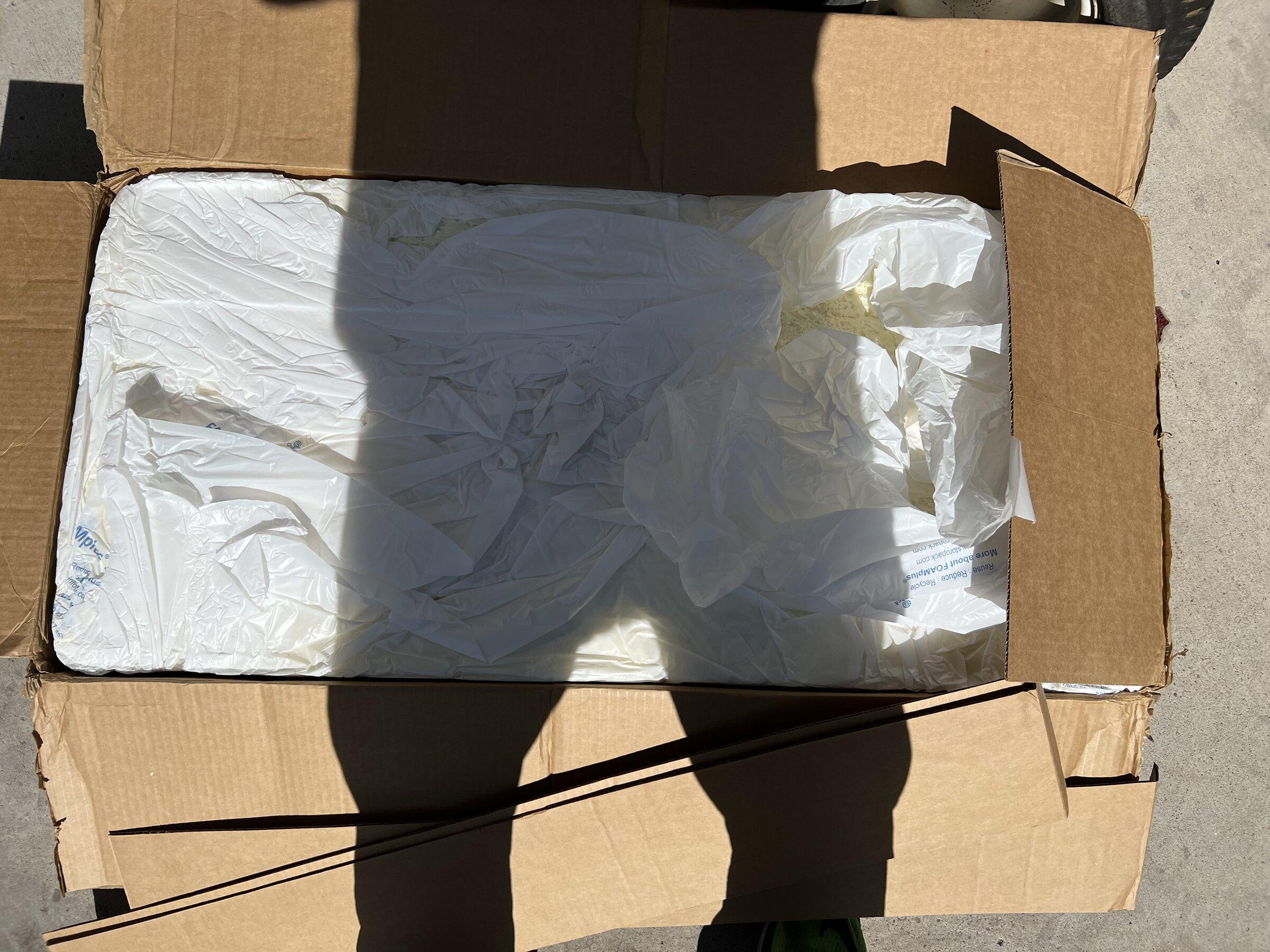

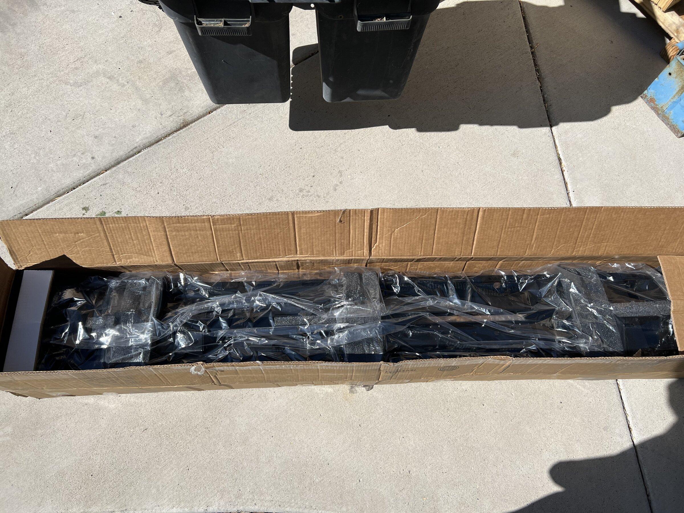

Here is everything opened and unboxed. Sorry for the shadows, the sun is directly overhead this time of day.
Ford Bronco Finally Frame Mounted Sliders from LOD OFFROAD!!! Steps Hdw open
Ford Bronco Finally Frame Mounted Sliders from LOD OFFROAD!!! Steps Hdw unboxed
Ford Bronco Finally Frame Mounted Sliders from LOD OFFROAD!!! Steps open
Ford Bronco Finally Frame Mounted Sliders from LOD OFFROAD!!! Steps complete
Everything arrived in excellent condition. LOD Offroad did an excellent job of packing and protecting everything. I don't see any chips, scraps, or damage to any of the pieces. These boxes were heavy and I am surprised they weren't more beat up by Fed EX.
Now I just need to get my Bronco back so I can install them!

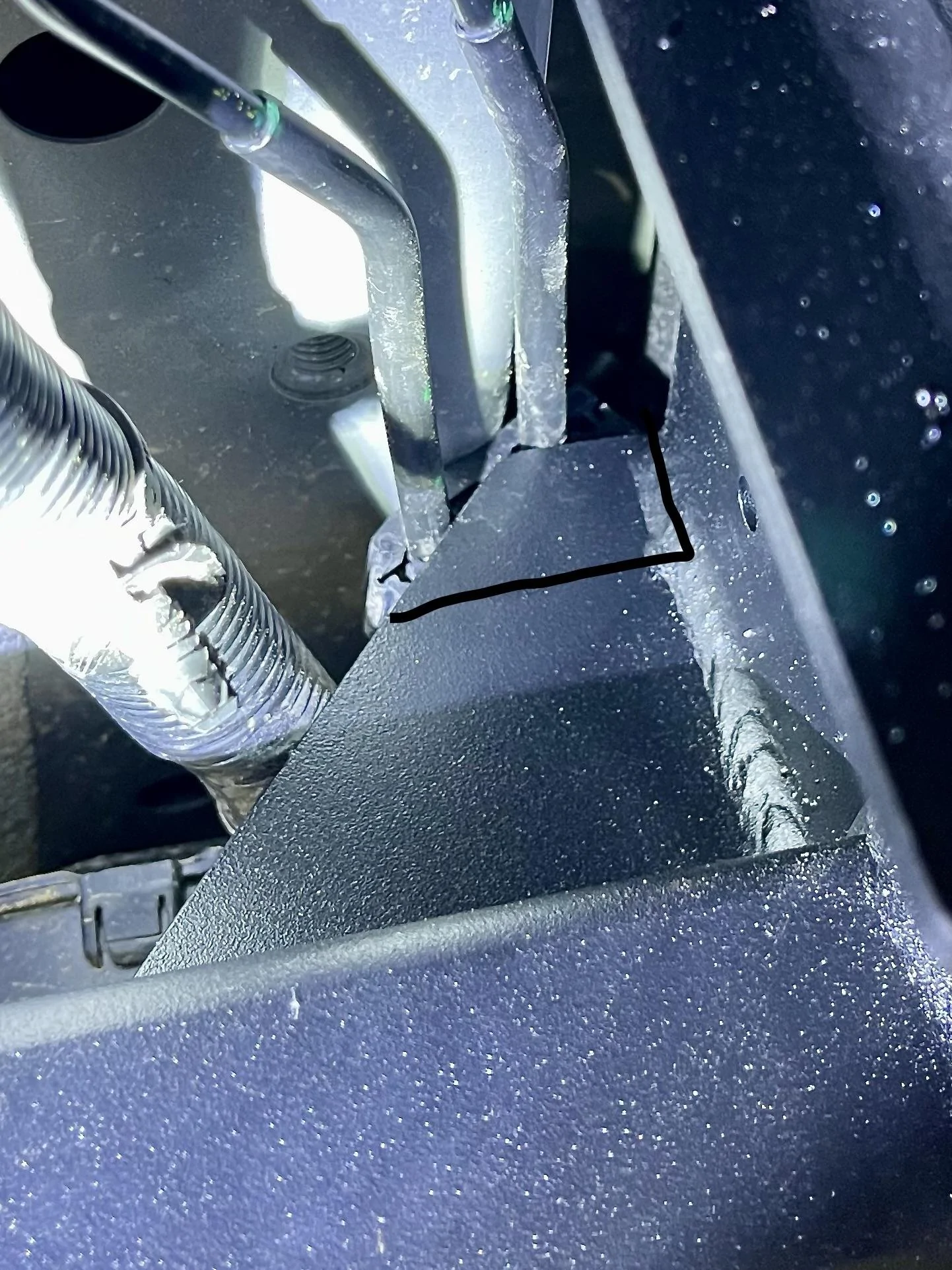

Maybe I installed it wrong but whatever I do the brake lines rub that bracket and the bottom of the tub. It has extra insulation on that part of the line but I'd like it better if it wasn't touching anything. Im going to notch it out a little, shouldn't hurt anything it's gusseted really good.
Ford Bronco Finally Frame Mounted Sliders from LOD OFFROAD!!! 53350E1C-7286-4516-BD8A-001FB0E8578A
