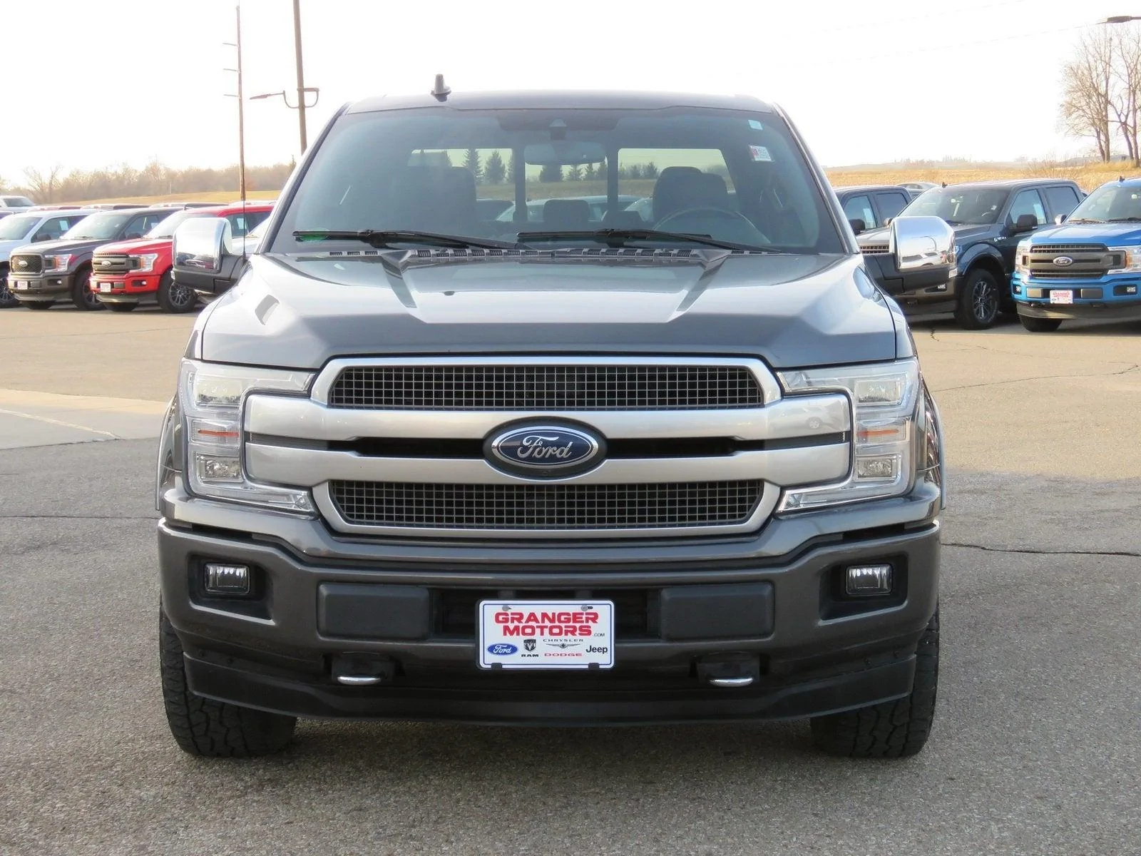

I have an F-150 Platinum with ACC and it is in the mirror stack...I have no sensor in the front of the truck
You see those two plastic squares next to the license plate? That's your ACC radar on the drivers side.
Ford Bronco Factory winch - front sensor line-of-sight blockage solution? 7ZNeGHV

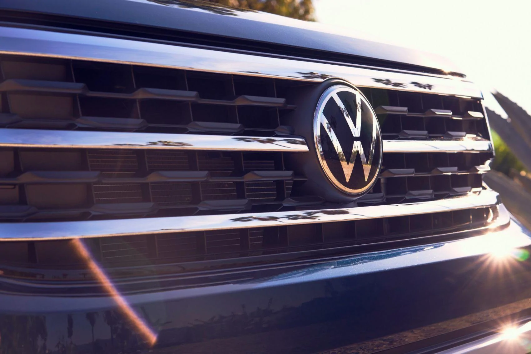

Other vehicles like VW and Mercedes-Benz have them actually hidden in the emblem. They are always 2D like my Atlas.
Ford Bronco Factory winch - front sensor line-of-sight blockage solution? 2021-VW-Atlas-4

I'm not 100% sure what is on the Bronco, but pretty much all modern Fords have a camera up by the review mirror for Lane Keep Assist and Forward Collision Warning/Automatic Emergency Braking. The radar for the ACC is usually in the bumper area. For example, in the F-150 above, it is behind the plastic cover to the right of the license plate. My guess is that the lower mounted winch is for those Broncos without ACC, and the winch mount on top of the bumper is for those Broncos with ACC. But again, I'm not 100% sure.

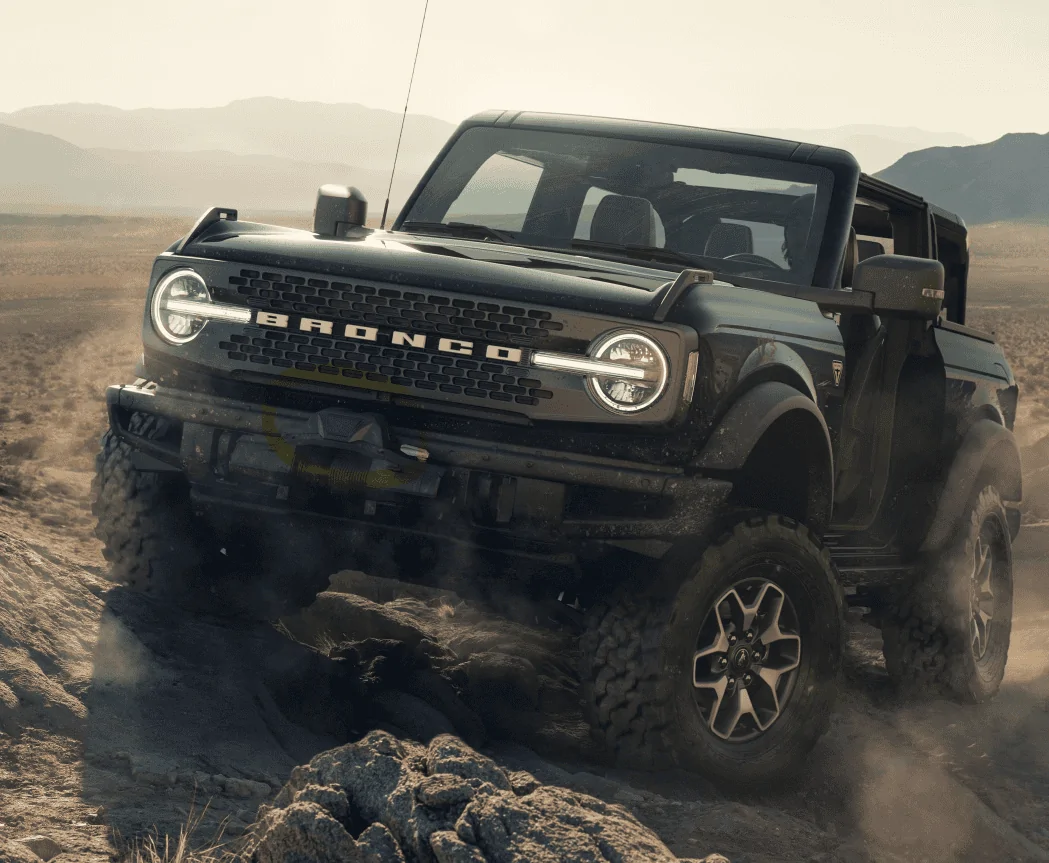

Read a couple comments on other threads noticing the available factory-optioned winch on front bumper (rugged steel one) covers up the "window pane" for the forward-looking collision avoidance sensors. That really surprised me since I made the same observation on a cursory look. However, in this photo, wondering if that pyramid shaped protrusion on top is either a relocated sensor or maybe some kind of "pariscope of mirrors" allowing the sensor to project over the top of the bumper mounted winch.
What do you think? I mean Ford isn't going to just abandon all the safety features (speed-sensitive cruise control, collision avoidance) for sake of having a winch. Especially not one that is factory optioned to be mounted right ahead of the stock sensor viewpoint.
That pyramid-shaped box sitting on the winch is the control box for the winch itself and independent of any vehicle systems.
I prefer the winch location shown in this pic much more than the higher one shown covering a big portion of the grill.
My guess is the panel in the bumper is for the Forward Sensing System that comes in High pkg+ and the rearview mirror sensors are for ACC system in Lux pkg+.
I don't like the compromise this suggests - if you need/want a winch but get high package you have to mount it higher or potentially disable your park assist. If you get Lux+ and want a winch you can mount it low and disable park assist or mount it higher and block the trail assist camera. Either way one might be faced with losing a valued feature when getting a winch.
...Or it's moot if you stick with mid package and below.

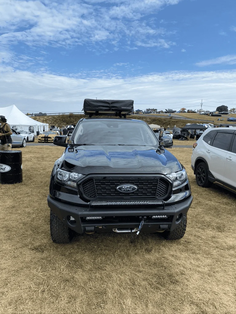

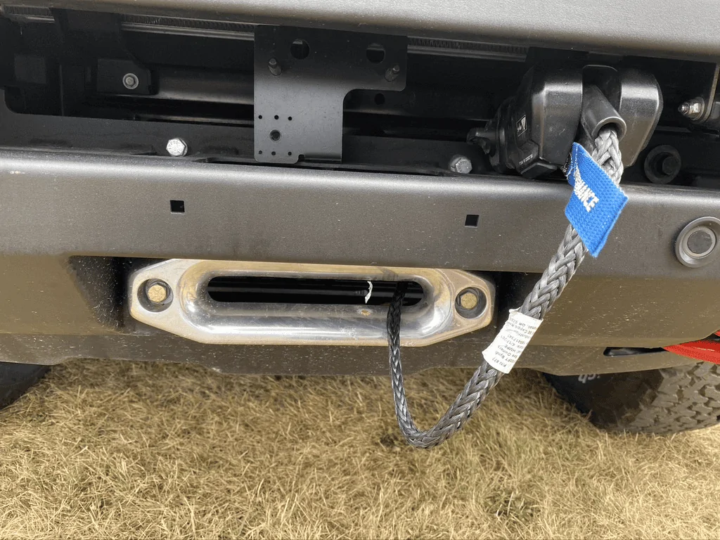

I went to the Carlisle Ford Nationals this last weekend. No new Broncos, but Ford Performance had their Ranger there with an installed winch. Not sure if this helps or does nothing to answer questions, but here are the pictures I took.
Ford Bronco Factory winch - front sensor line-of-sight blockage solution? 1596493526146
Ford Bronco Factory winch - front sensor line-of-sight blockage solution? 1596493545033

Wow. $256 bucks plus a bumper change. I need to drop more change in the jar every day! LOL
If you moved the location of the radar you would almost certainly need to have the ACC re-calibrated /aligned at the dealership which costs about $600 on a VW after a 1" lift, for example.

Still researching this, but found this article where Ford Performance worked with ARB to develop a bumper for the Ranger. Looks similar to the number I saw at Carlisle. Article says number is compatible with all of the ranger safety systems:
“That means the bumper is compatible with all Ford factory components, including the safety systems and sensors in the Ford Co-Pilot 360 suite like Adaptive Cruise Control and Forward Collision Warning”
it is available late this year. Maybe I am giving the designers too much credit, but I think they have solutions to the sensor issues already.
