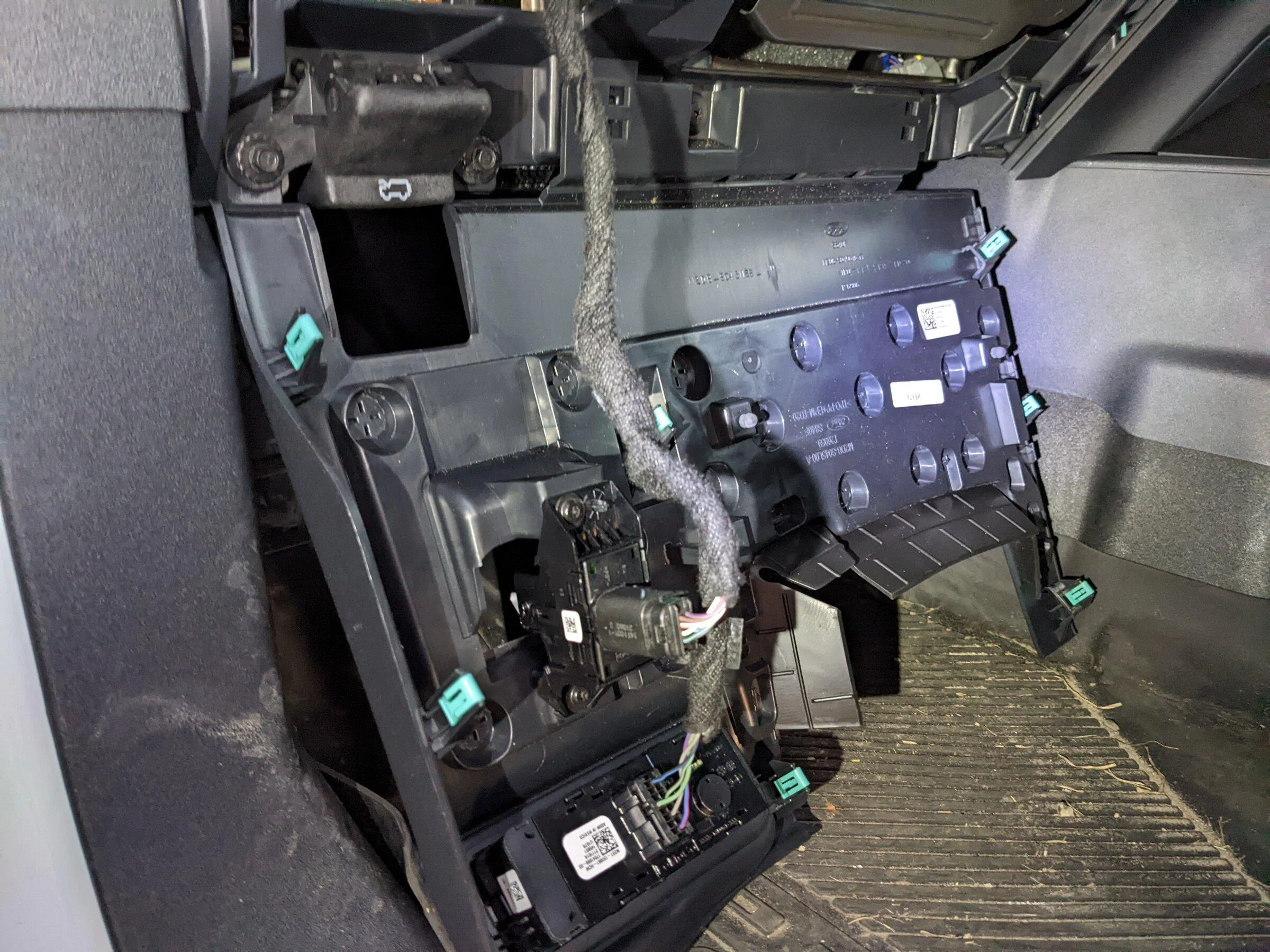

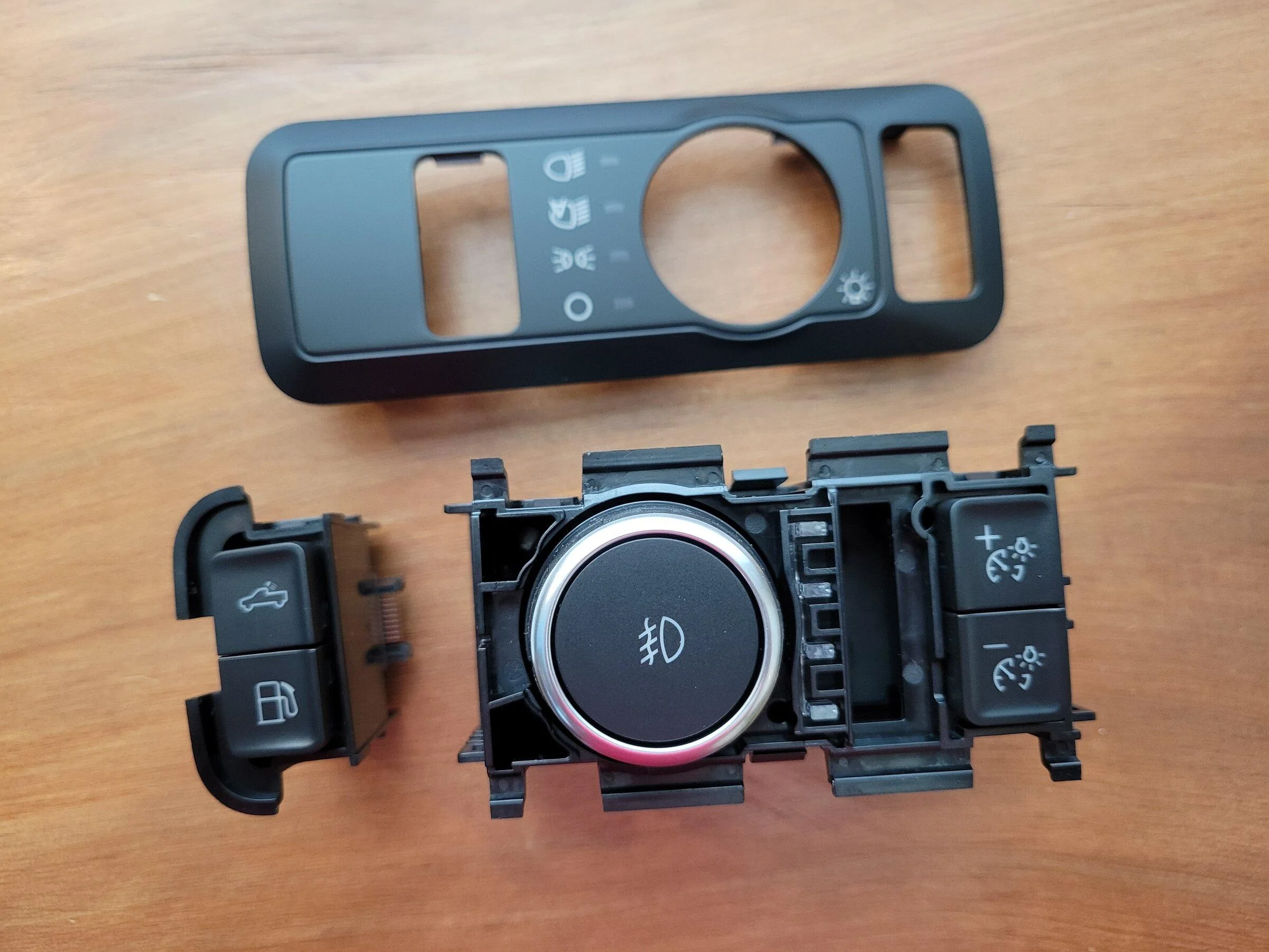

I got it apart but now I just need to see if I can get the old switch out of the Bronco.

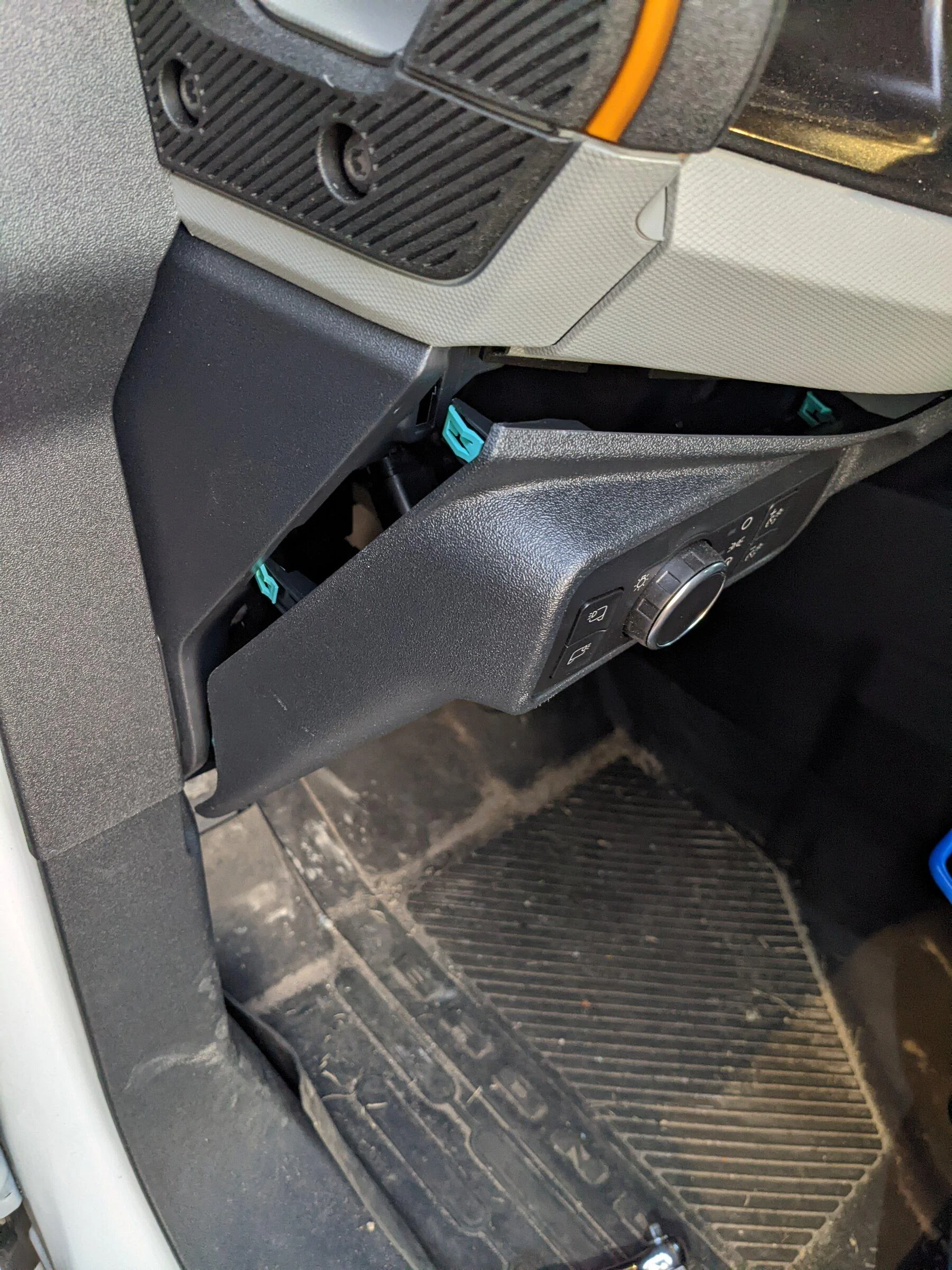

Ok I received my ML3Z-11654-DA. So, what is the easiest way to get the switch out of the Bronco? Also, to swap over the puddle light switch? There are tabs all over this thing.
Pull on that panel underneath the steering wheel...to the left of the steering column
Oh, so the switch doesn't just come out with the tabs? You have to pull on the panel?

Pry it loose on the left and then pull on it on the right side

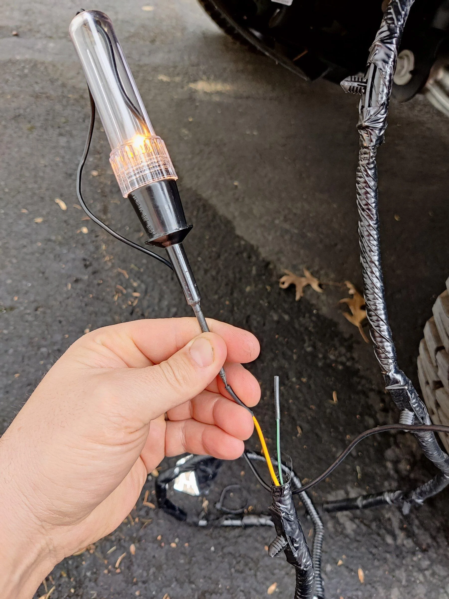

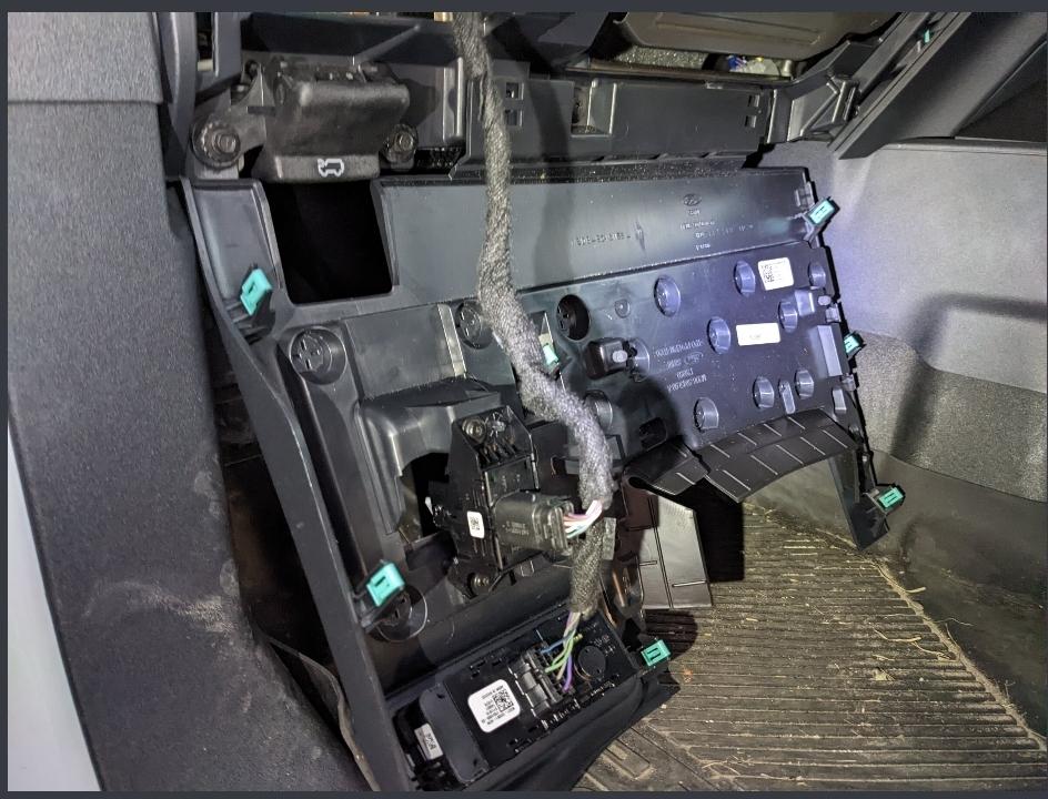

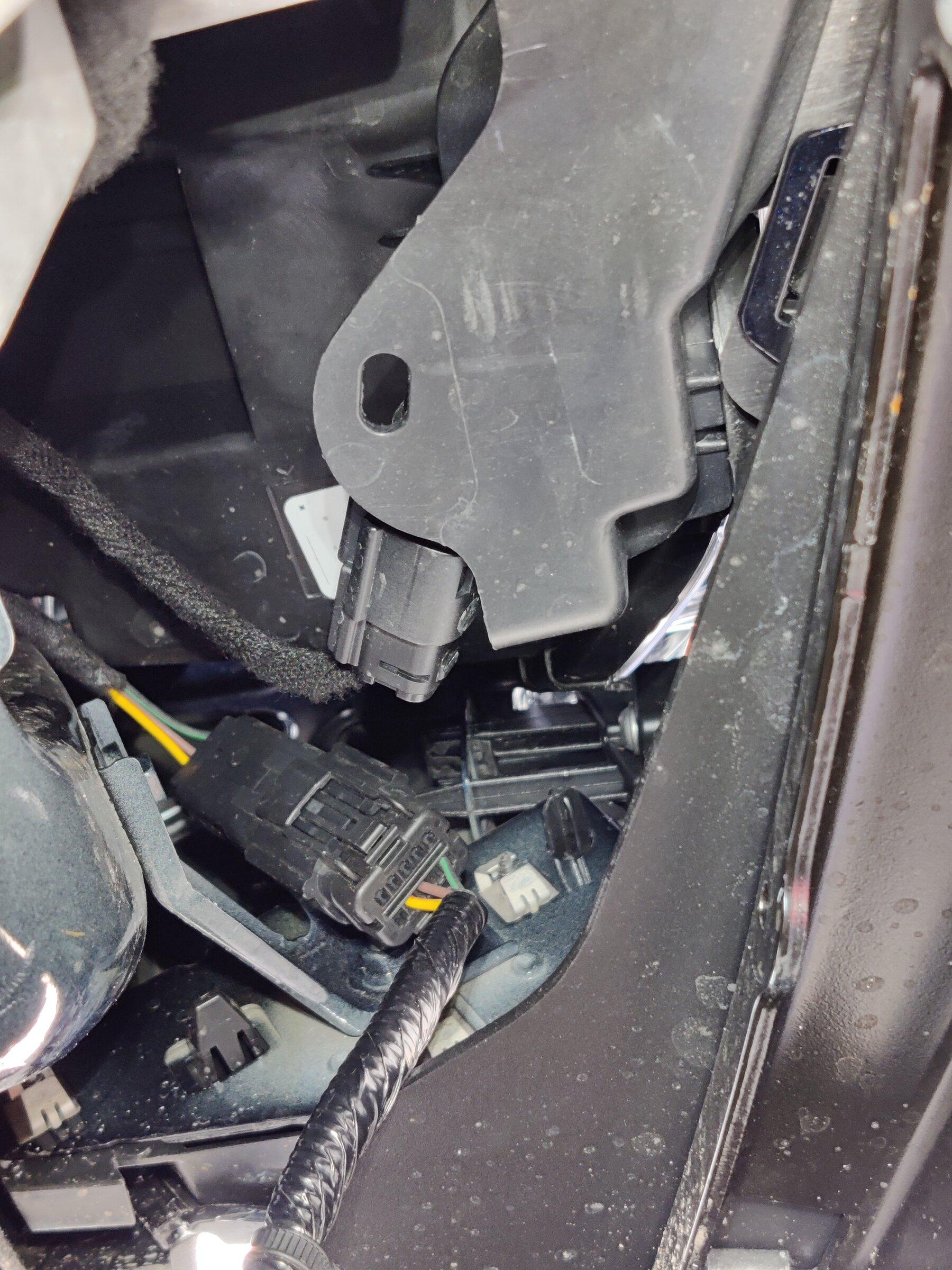

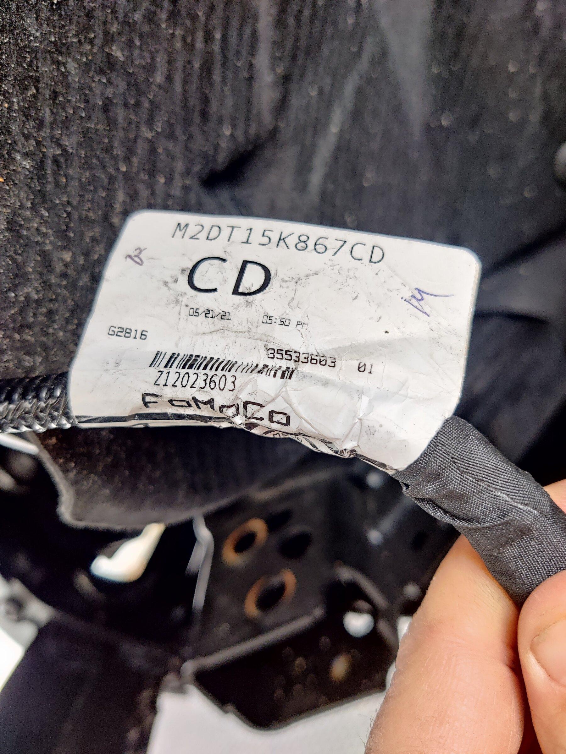

I have a big bend with factory fogs. But on modular bumper. Here are some picks of the factory wire harness for the fogs. Also what it's plugged into. Hope this helps some.

Quick question the is the black/green wire a ground? There is 1 yellow/orange wire and 1 brown wire. They both get power when turning on the fog light switch. The black and green does nothing, what's that wire for? Thanks.
That is the ground (-) wire.

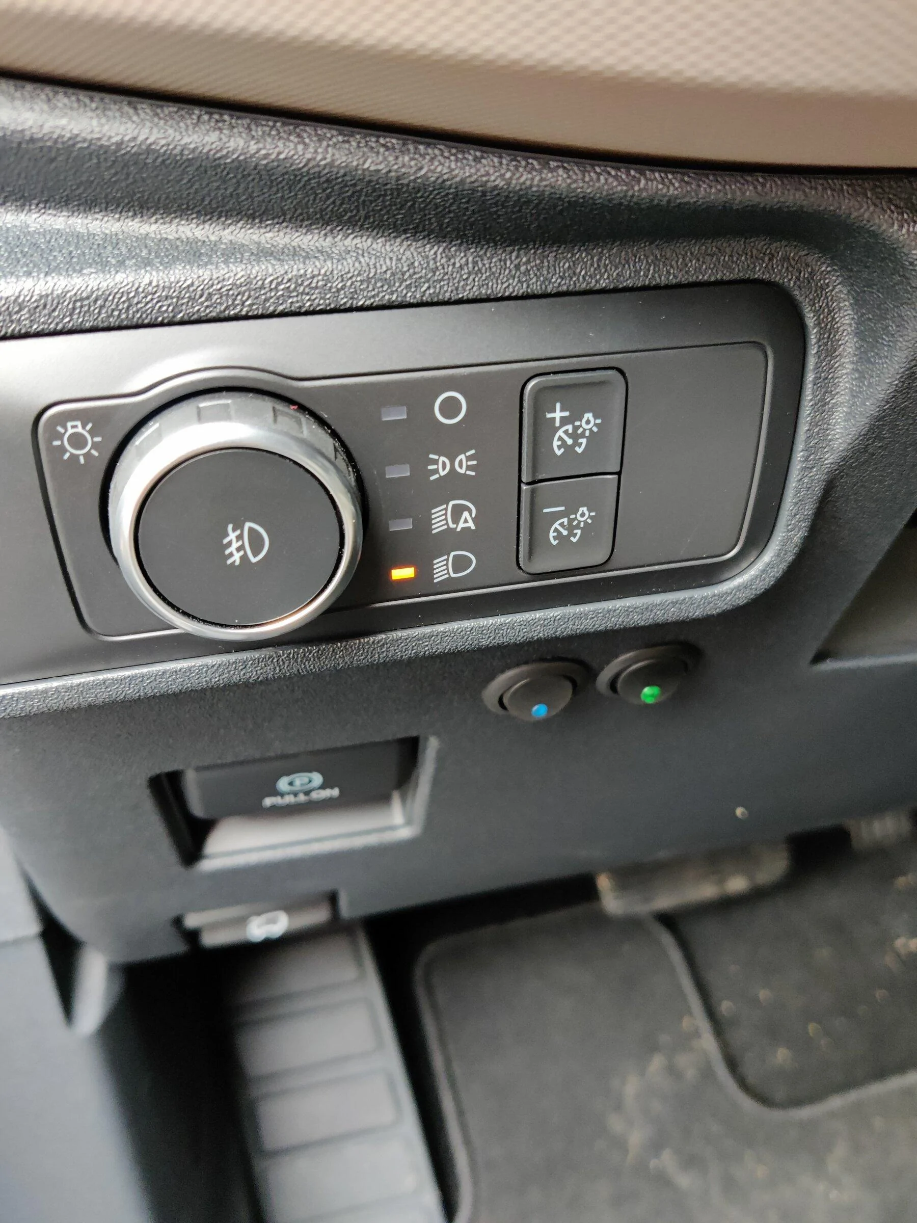

What do the blue and green switches do? You can't just post extra switches and not share =P
Blue is for A piller spot lights, and Green does nothing yet.

Could you please tell me what the part number is for that switch, that is the one I need.

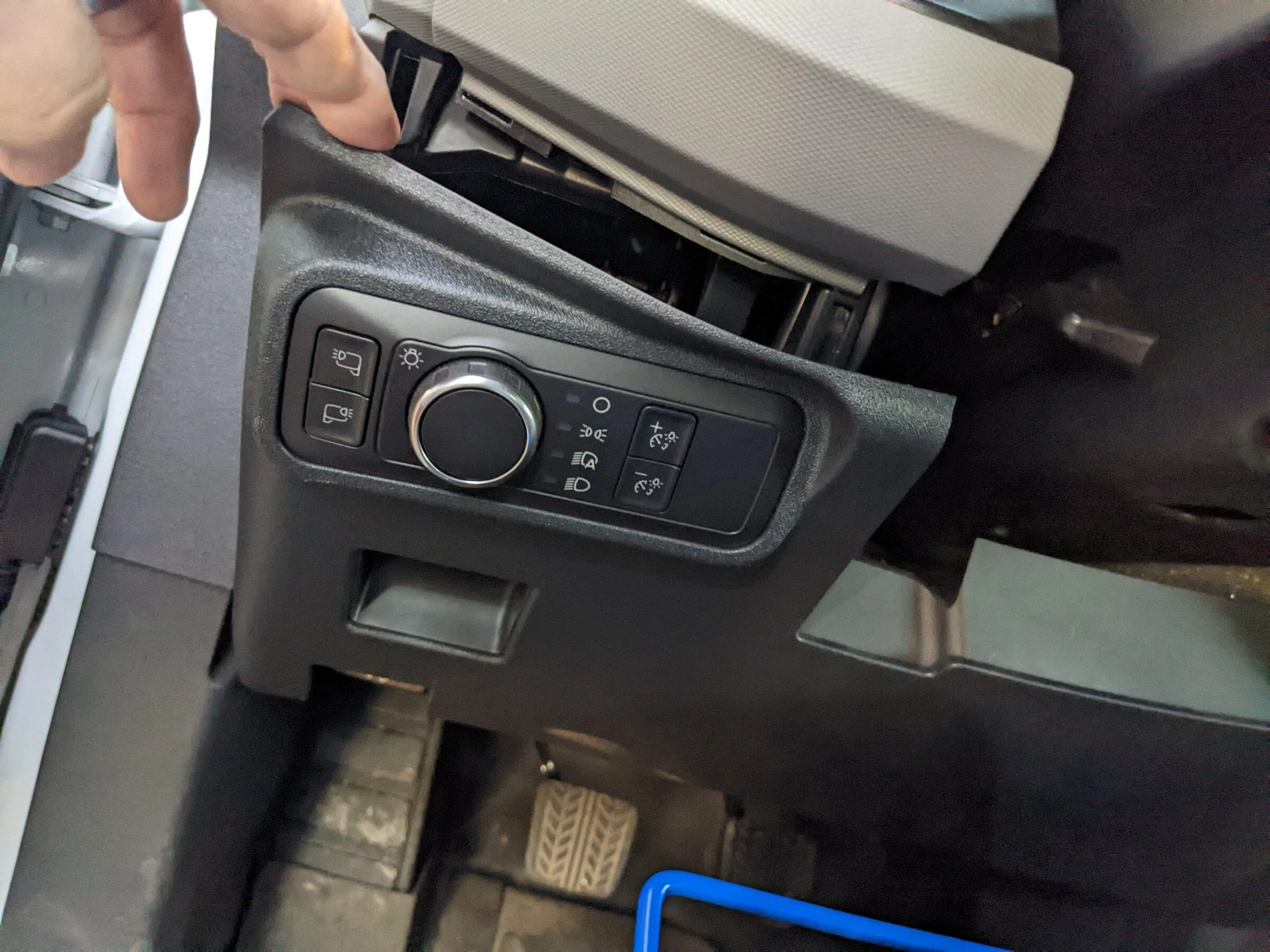

Here’s a single fog without puddle lights.....
Take note that it doesn’t have a connector to add the puddle module (at screw driver )
Could you please tell me what the part number is for that switch, that's the one I need?
