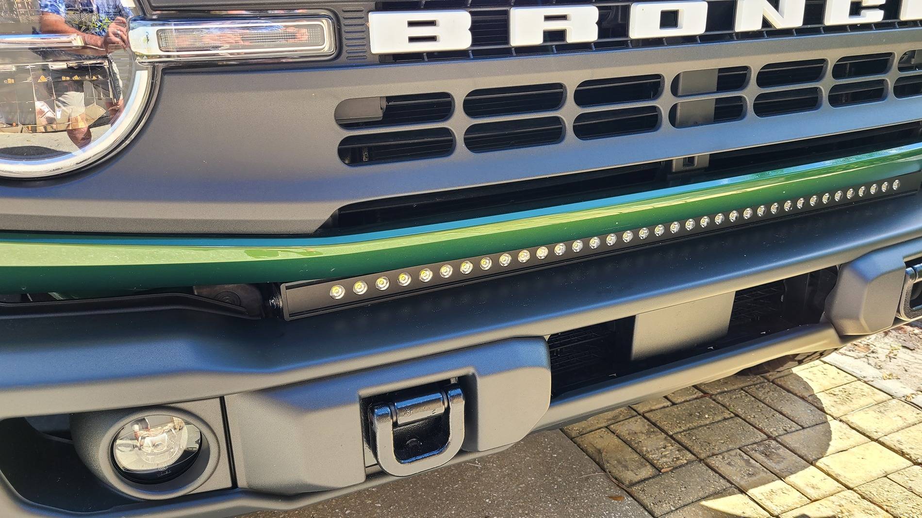

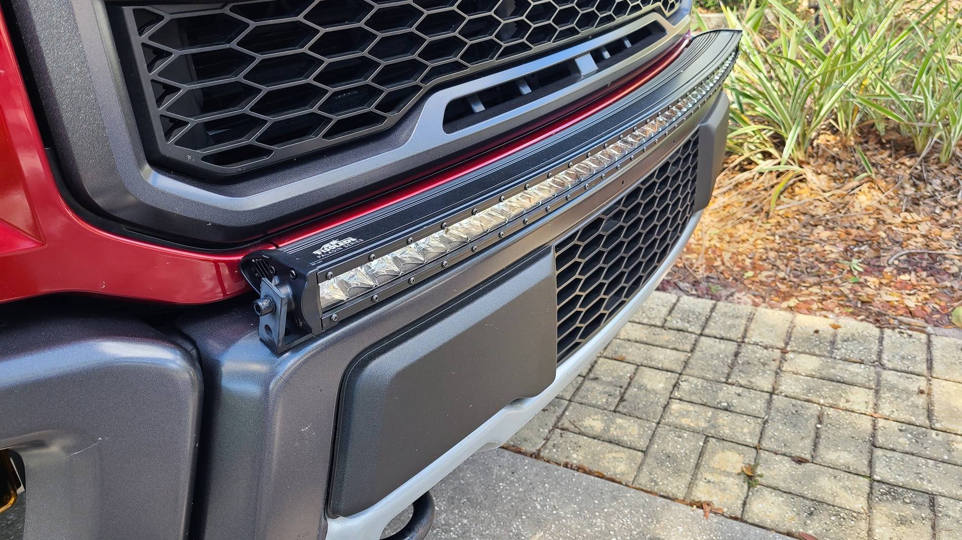

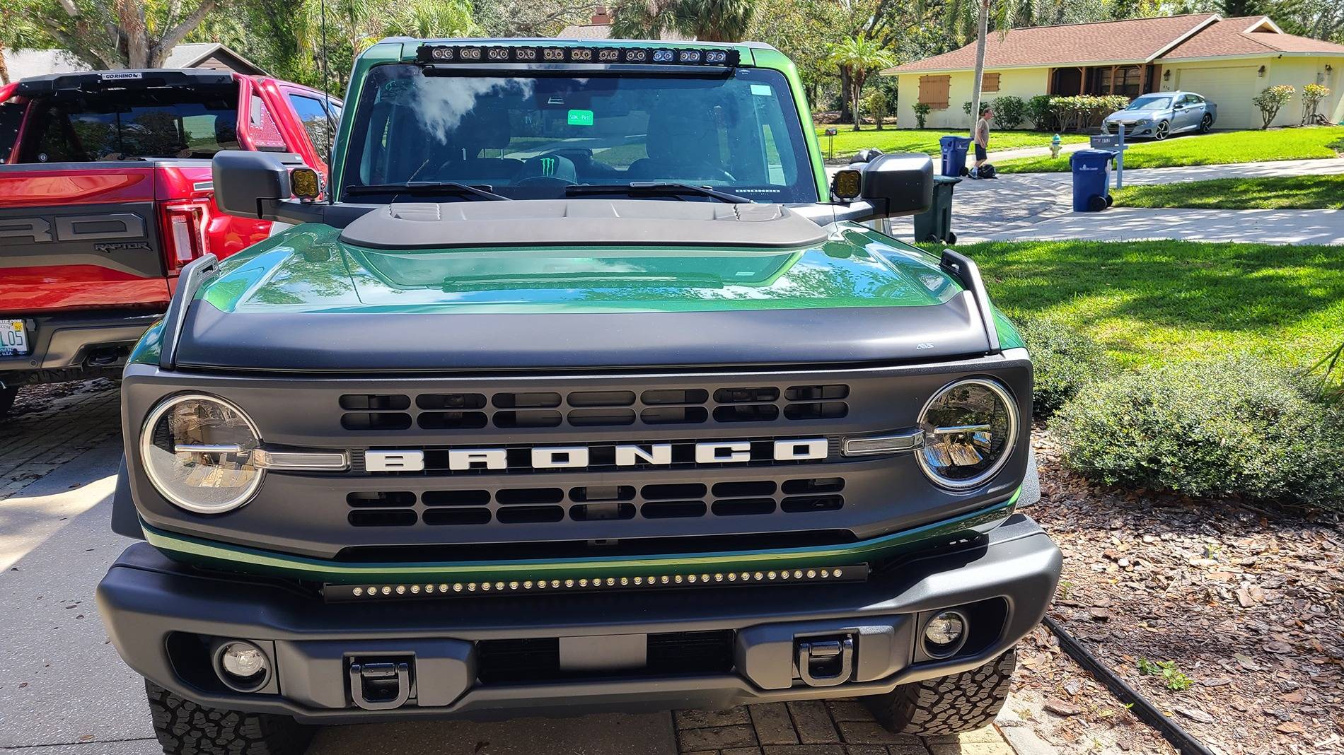

I have not put the 38" F150 Leds Paladin Curved light bar on my capable bumper, however I have mounted the 40 " on the front of my F150 Raptor. The F150 Leds light bar will require drilling of the Bronco capable bumper similar to the mounting on the F150 Raptor. I have mounted the M&R 40" straight light bar on my Bronco capable bumper which required no drilling. The M&R sit's back from the front edge of the bumper and tucks up real nice. The Paladin light bar may stick out beyond the edge of the bumper as it is wider than the M&R. I have had no issues with either light bar. The M&R was wired to Aux switch 2. For the Raptor, I used F150 Leds remote with relay wired to battery. I have attached some photos of each. I have also mounted the M&R 40" curved pro light bar to the roof which is wired to Aux 1 as you can see in the photographs. I like the M&R as both have the amber back lighting which I run on other lower amp Aux switches.
Ford Bronco F150LEDS Curved Lightbar on Capable Bumper? Bronco light bars
Ford Bronco F150LEDS Curved Lightbar on Capable Bumper? Bronco lower light bar
Ford Bronco F150LEDS Curved Lightbar on Capable Bumper? Raptor lower light bar
