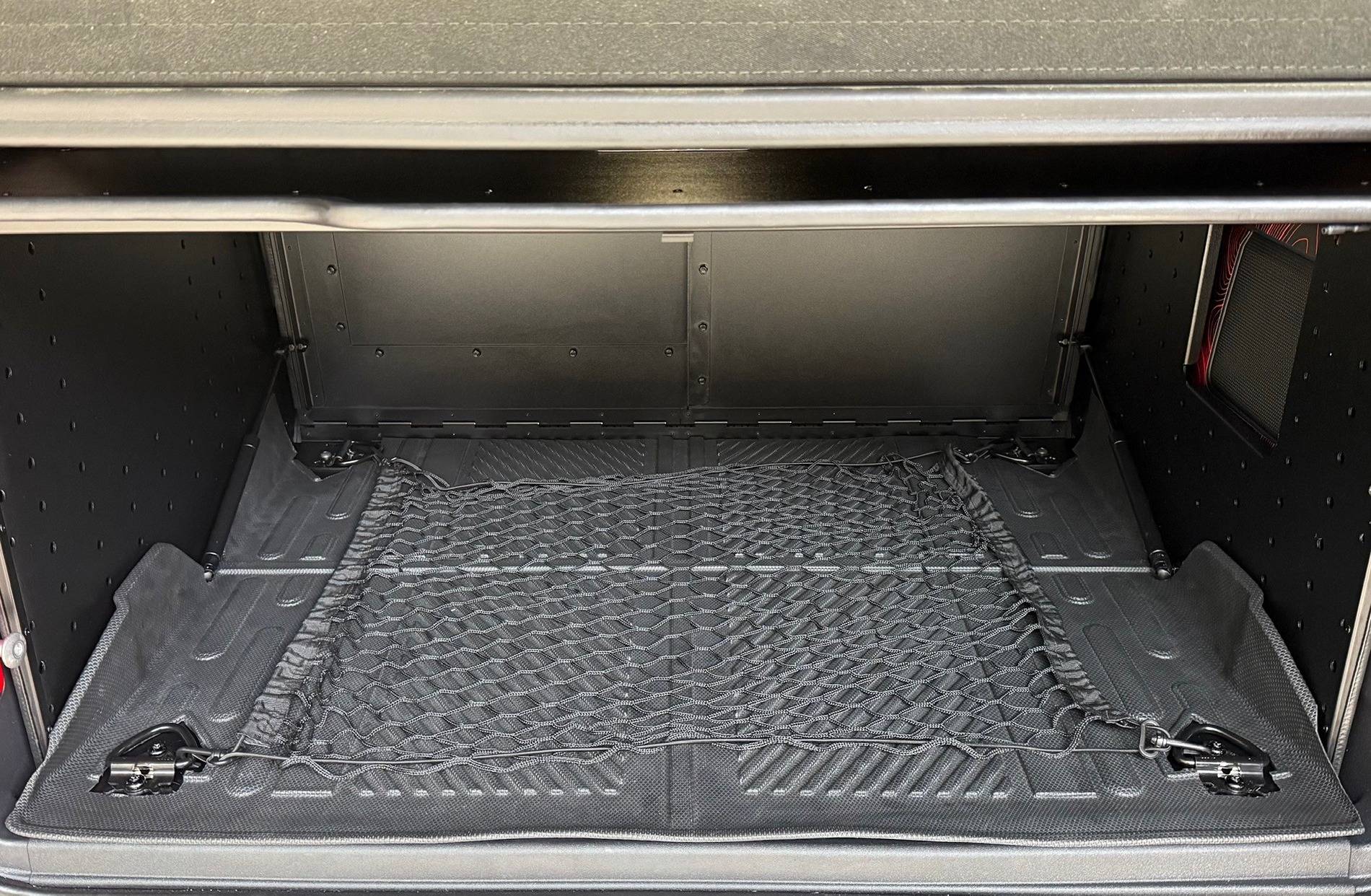

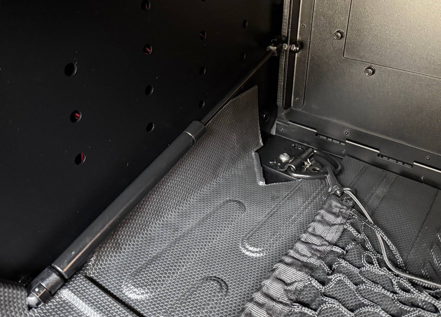

I received my trunk on Friday 03/28 (ordered it on 03/03). Did not come with carpet, but they have added gas struts to the setup (see pics below). It appears (I haven't tried one without it) to make it easier to fold up and down by holding the entire assembly up. Carpet is now available to buy separately on their website ($150).
I added the Ford tie-down rings so I could use my cargo net, so I purchased 4 additional bolts (they are allen key head and M8x50) from Ace Hardware to setup the tie-down rings. However, I found that in order to fold the trunk completely down, you have to move the back tie-down rings completely sideways (see my photo #2). So I only used 1 bolt on those two rings and I put the bolt through the back of the tie-down ring only, so it spins completely out of the way for the trunk to fold down. I ended up only using 2 additional bolts once I figured this out. I put plastic washers underneath the tie-down rings, so I can spin the back tie-down rings sideways or back straight if I want to. I was able to cut-up my Mabett trunk mat and make it work with the setup.

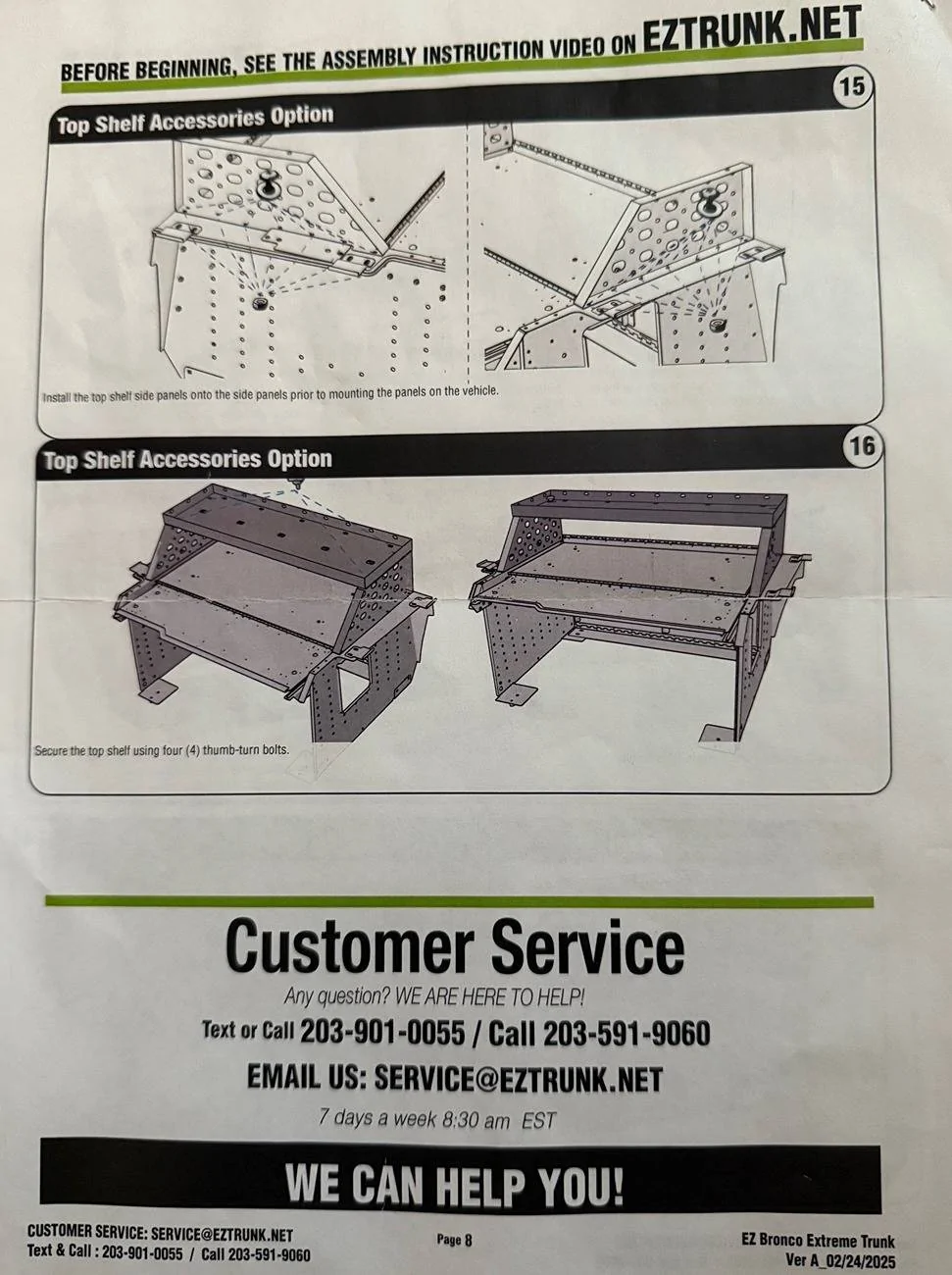

It appears they have eliminated consideration for the "molle panel accessories option" (you can see that in the instruction manual linked above), as that isn't included in the instruction manual that came with my trunk. My instruction manual does include the below "top shelf accessories option", which isn't included in the instruction manual linked above. The "shelf accessories option" (shelf inside the trunk) is still included in my instruction manual. It appears they are still reviewing/testing what options to ultimately provide for the trunk.

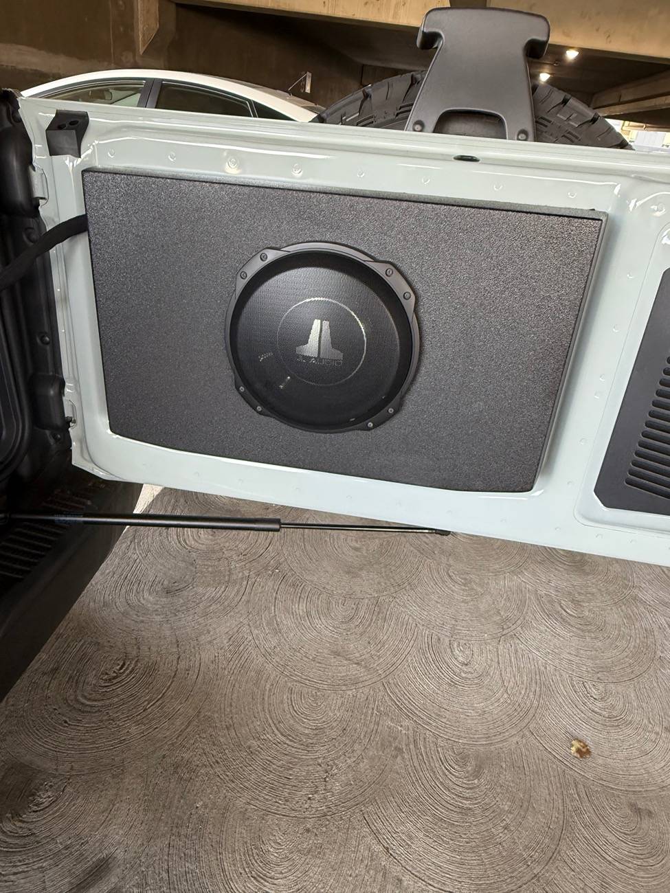

I just installed mine too and had the same issues with bracket placements for the soft top, and lowkey having a little bit of rattling when it’s folded down and driving around. Not sure if anyone else here is hearing any noise when driving over bumps and stuff.
Going to have to figure out how to make it work cause I do like it, but the other let down is that my subwoofer seems to cause major rattling when the ez trunk is up , but it lowkey makes sense given it’s a big subwoofer😅

If you figure out how to modify it to make it work I would love to know! I have a stinger sub enclosure mounted on the swing gate.

Tbh I think a molle style enclosure would probably work better to let bass pass through but when it lies flat not an issue at all, it’s just when the enclosure is secured

found ways to make it work and the team at EZ 4x4 have been extremely helpful in making sure I’m happy with the EZ trunk! Can’t thank them enough!
They suggested to leave the farthest panel back flip over and open and the rattle became obsolete for the most part since there’s space for the bass to pass through, not 100% full proof but going to keep making adjustments until it’s 100%
