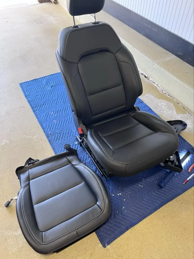

I picked a leather seat cushion from eBay for a 20-24 Explorer. I purposely got one that does NOT have the ventilation feature, so I didn't have to mess with the bladder thing that's on the bottom of those cushions. The Explorer seat foam is significantly softer than the Bronco's, enough that I actually sat lower because it compresses more. To the point I had to adjust the rear view mirrors. I removed the cushion and added some thin padding (the type you'd put under an area rug) to firm it up just a touch, still softer than the Bronco cushion. I also shaved the side bolsters down a bit using a 90* grinder and working slowly.
The plugs for the seat heater are not the same, but they both have 4 wires. I bet somebody smarter than me could figure it out.
The straps for the Explorer seat all have a home on the Bronco seat base, but they aren't as snug. They got even less snug after I shaved the bolsters down a bit. But, they have not come off after about 2 weeks of normal use.
I consider removing the seat mandatory for this swap. It only takes a few minutes and makes removing and reinstalling the base cushion rather easy.
The leather is not an exact match, but very close. So close that it just looks like a difference in shadows. I picked up another cushion for the passenger side as well, that will be the next free evening project.

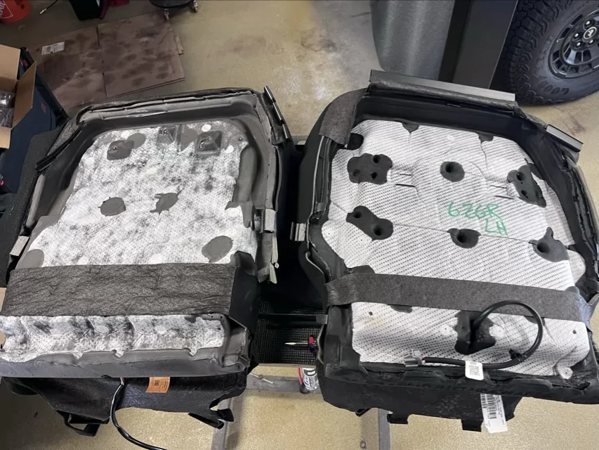

Bronco left, Explorer installed on the right.

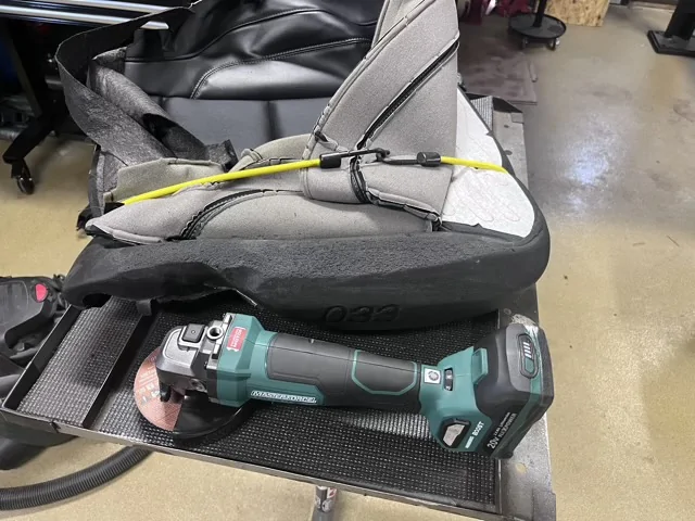

Shaving the side bolsters a bit, left the cover on for this at first but was worried I may accidently damage it.

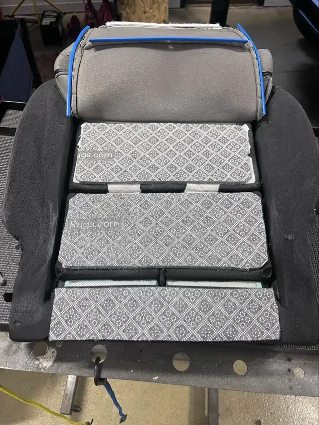

So I removed the cover by releasing the plastic clips (no metal hog rings). Finished shaving the bolsters, and added some thin padding.

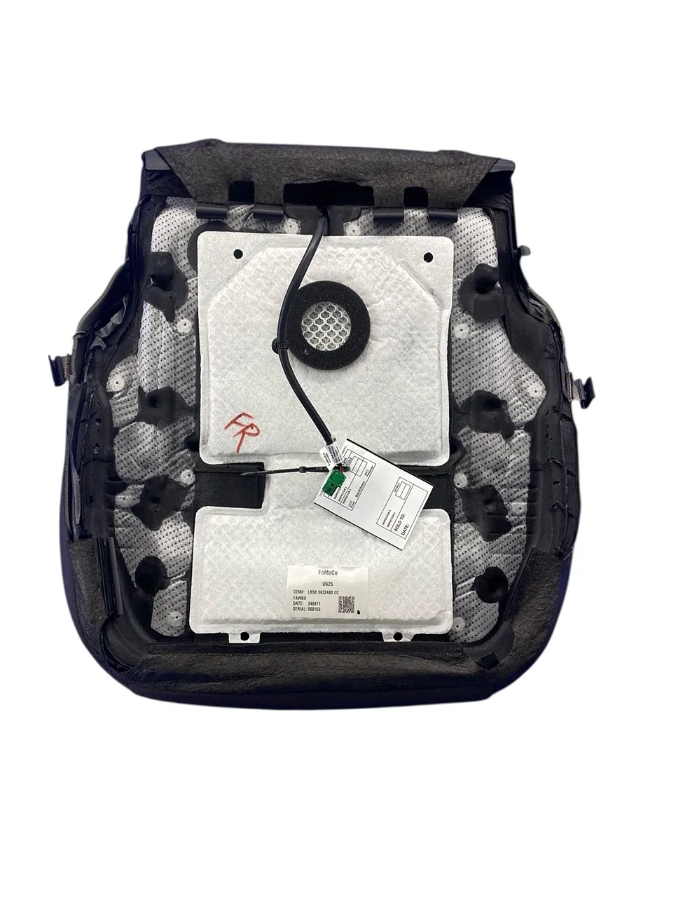

This is the ventilation bladder thing that I avoided. If you want to really experiement, you could get one of these, along with the fan, and wire it on a seperate circuit.

Bronco left - Explorer Right
