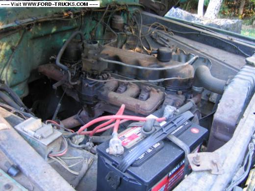

Block heaters usually replace a freeze plug, and warm the coolant prior to starting. As the engine does not require warm coolant to start, and the viscosity of the coolant does not change significantly with the cold, it mostly ends up speeding up personal comfort. Warm oil is the primary engine longevity item versus warm coolant.
Truly effective heating is applied to oil bearing areas, oilpan, trans sump, t-case, and battery. You'll see often see "Fairbanks" style heaters in Alaska, where heating pads are adhered to the battery, OEM engine block heater and oilpan/trans pads and all wired to an odd looking receptacle box under hood, something like this:
Ford Bronco Engine Warmer - How many people use it? 1738106666547-t0
Long streaks of negative temps, I'd plug it it in, some benefit is better than none, but you could be doing a bit more for engine longevity with a pad heater (though you might want to switch the Bronco to some non polymer pans first, heh)
Source: Alaskan.
