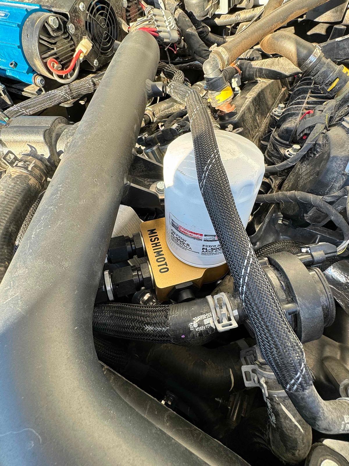

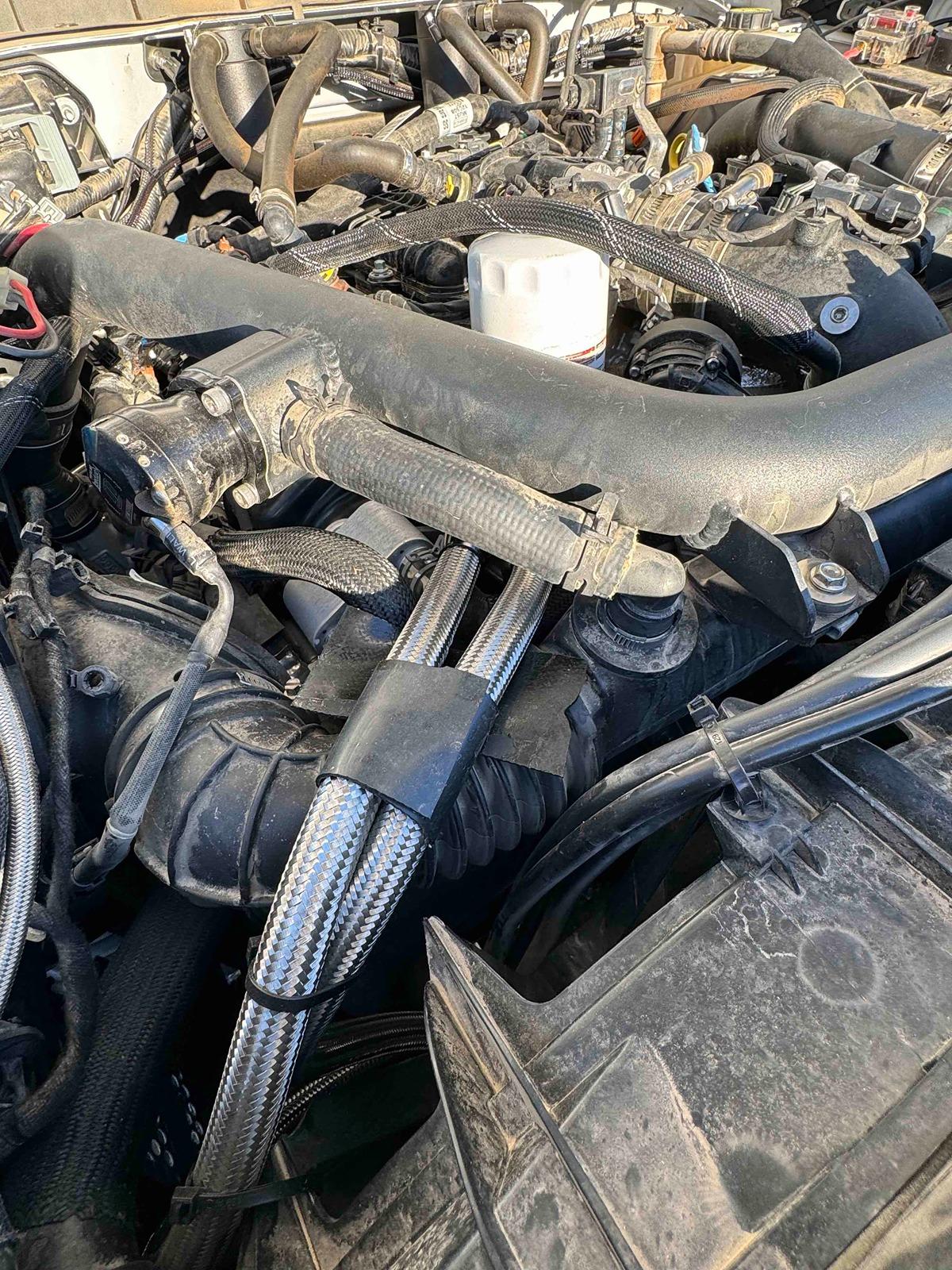

I run the B&M transmission pan, which holds additional fluid. I also run a Mishimoto oil cooler and their new radiator. I live in Arizona, and off-roading in the summer months pushes the oil and transmission temps up. I completed the upgrades at the end of last summer, and the Mishimoto radiator was recently installed. The real test for me will be in July and August, but as of now, I have not seen any spikes in temps while pushing it hard in the desert.
This is the part needed to add the oil cooler.
https://www.baxterperformanceusa.co...t-fs-101-bk-cartridge-to-spin-on-adapter.html
Ford Bronco Engine overheating sandwitch
Ford Bronco Engine overheating Mish.lines

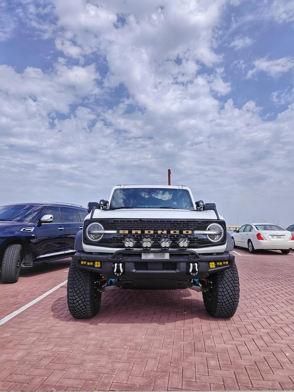

Let's see a pic of the front of your ride, maybe something you have added is causing issues, I know blocking the airflow is a big no no with the Bronco, but you should see lowered fuel millage before you have overheating issues.
For some reason, I have experience the opposite effect haha. Everytime I have the AC on (cooling) there is a significant drop in temperature engine oil temps.. Without AC it will sit idle at like 97 degrees, where as with AC cooling ON its about 87.
Here is a pic of my ride.. However, its not just me, many owners here have the same issue when pushing the car hard in the desert, in soft sand and climbing large dunes.
