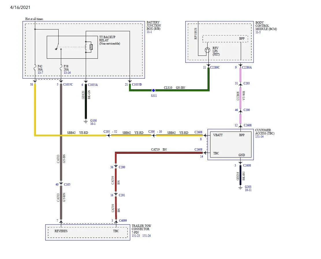

Can anyone confirm what voltages reading (range)should be feeding into the brake controller.
My assumption is/ was that it should be between 0v-13.8v ish (nominal system battery voltage) depending on the position of the brake pedal.
When I measure between ground and pin12 (violet/white) with a meter it reads 0v or13.8v. (on/ off)
nothing in between.

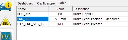

I pulled up the reported value on forscan, and the vehicle does see the brake pedal varied position, the voltage output though does not change.
I am not sure how proportional breaking is accomplished without it.
anyone have any insights?

What are you getting on Pin 14? BPP I think is Brake Pedal Pushed, which is an all-or-nothing output for the brake light. Not sure we are seeing all the wires in the diagram you have posted - 7 pin connector to the trailer obviously has more than 2 wires going to it, it's missing the ones from the standard 4-pin.

What I'm talking about and referencing is the electronic brake controller (Redarc Tow pro) which would connect @ connector 2608.
My question is specifically about the expected input voltage. ( Pin 12)
The output voltage, pin 14 goes directly to the 7-pin connector.
That can vary based on what I have the setting set to.
The issue I'm having, not being able to put the brake controller into automatic, looks like it's not getting a varied signal.
Automatic mode, should be equal to the brake pressure applied, which can be fine-tuned.
Currently it looks like the input is on/off, which to me makes proportional breaking impossible.
That's why I'm asking what should the voltage range, what should the input be?

That... is a good question.
Might not be a proportional signal - just "brake pushed, send voltage according to trailer brake sensitivity", and it would tend to be a bit grabby if you just feathered the pedal as opposed to mashing it.

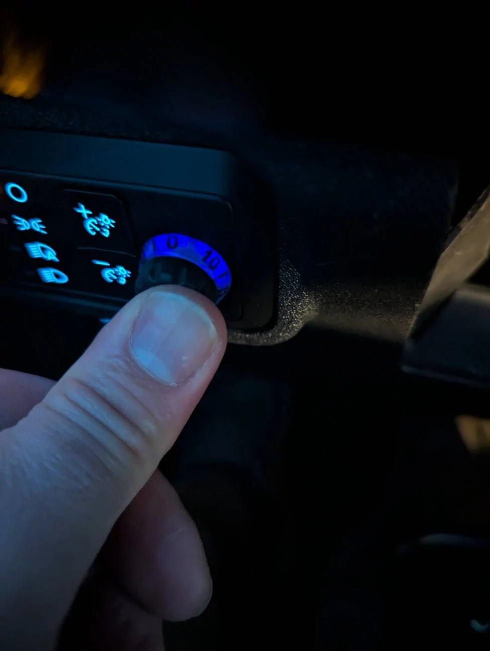

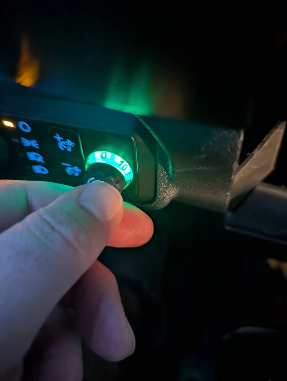

I was able to get it to change modes today.
I did remove power from the unit (unplugged it). And then restore power after about 2 minutes
After that I was able to recalibrate it.
I was able to verify that with a 7-pin trailer tester I made over the weekend.
It utilizes 10 w loads for each of the outputs.
(Leds by themselves will not properly replicate what is expected by the brake controller, or the tow module)
So it looks like it all works.
