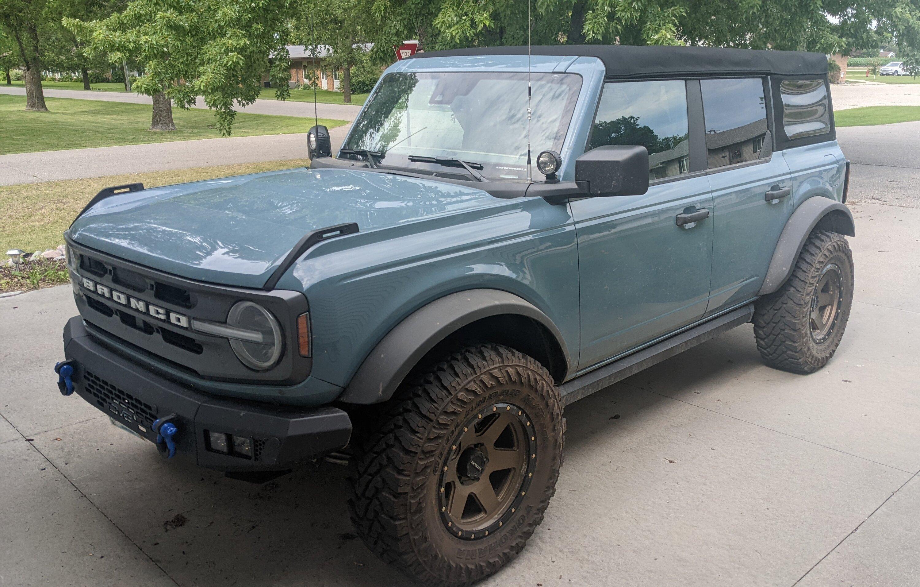

I'm severely underwhelmed and amazed how bad my BB stock shocks handle gravel roads at even moderate speeds (like 45) with my 35's.
My King 2.5's can't get here soon enough. 😎
Say more! Did you put 35's on new, heavier wheels on a stock BB Suspension without a lift? Sounds like your King 2.5s are needed! I wonder how much the added wheel+tire weight added?
The stock wheel&tire combo were supposedly around 72# and the current package is closer to 105#.
I just have a Fabtech leveling kit up front.
Nice touches, front shackles, cowl lights, ham radio antenna, fenders, new tires and wheels, King shocks on the way . . . I understand that the main concern with putting larger tires in our standard, Non-SAS suspensions (BB, OBX), is the possibility of premature wear generally and possible component failure (there's been alot of tie rod failure with 37's) if its heavily used! I like your King shocks for that reason. Some have said beefier UCA's are in store if I lift mine too much or do serious off roading. Right now I'm working on the 33" tires, wide for beach sand, Badlands style with a 1" lift and maybe beefier shocks. Good luck.
It's also got SAS diffs and e-lockers w/4.7 gearing. 🤣
I'll be going with aftermarket UCAs and probably doing something to beef up the tie rods.
I want the extra travel and better damping for running lakes in the winter. Think of it like Baja but in the snow. 😁
