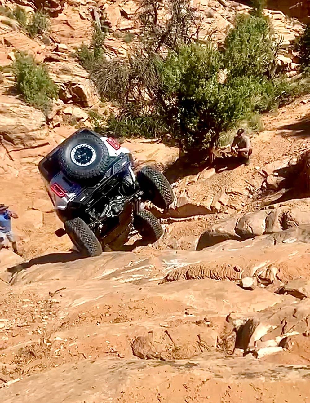

Luckily the bumper itself has no provisions to promote using it to hook a winch/rope to.
Then there are people that further hack the bumper to run a winch line through it while also accommodating a frame mounted spare tire carrier.

Good view in that pic. Bet that was some pucker!
She throttled out of it and set it down nicely, so in real life there was enough time to say “go go go go!” and “oh shit!” Before the pucker fully set in 😂
