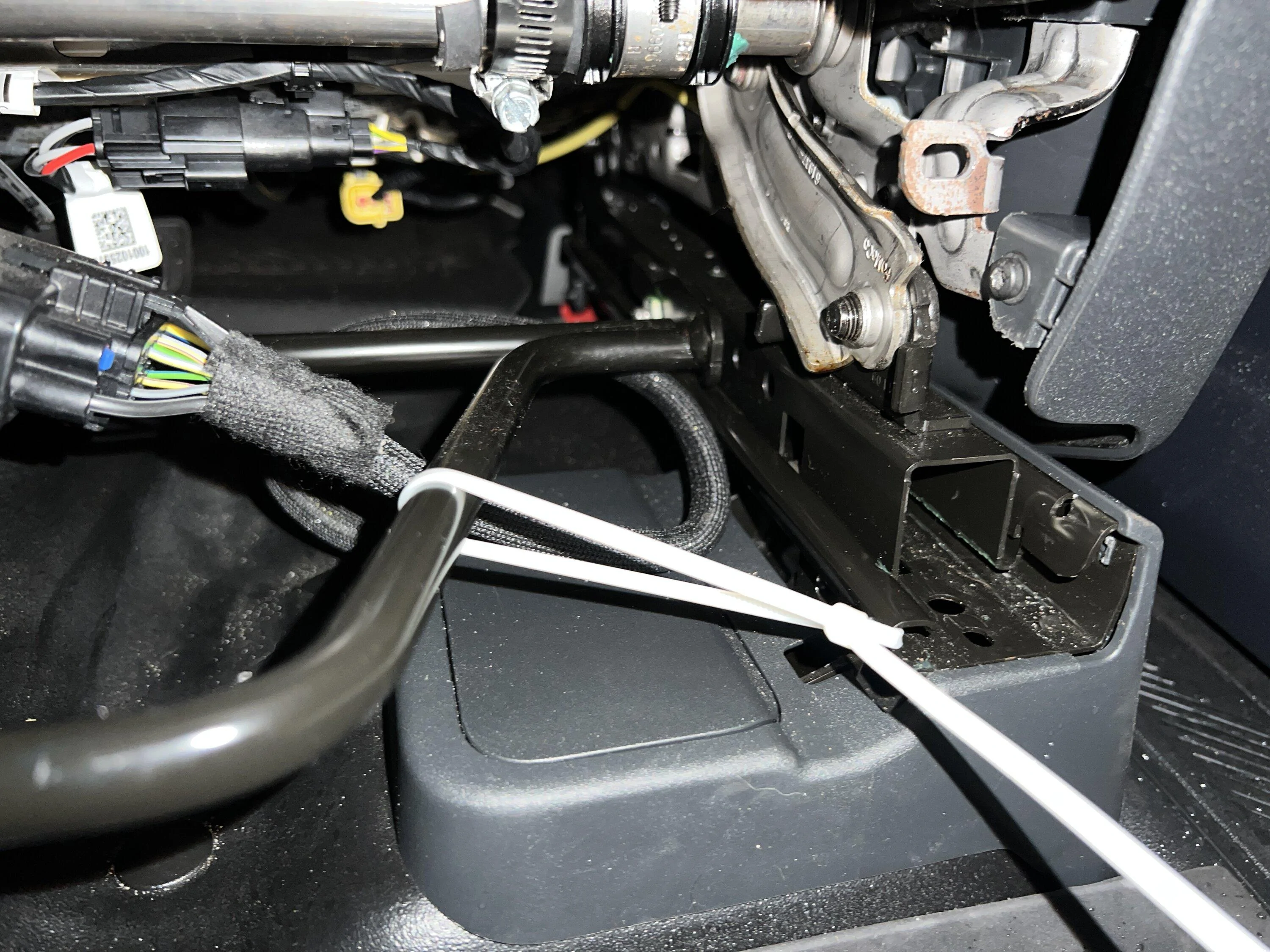

Anyone else experience a clicking noise / light thump every time you accelerate or hit the brake pedal?
seat is a manual leather trim seat in case that helps as powered seat was not available.
dealer has looked and tried to fix via one TSB but it still happens and they say it’s normal.

I have no clicking in my seat, this doesn't sound normal to me

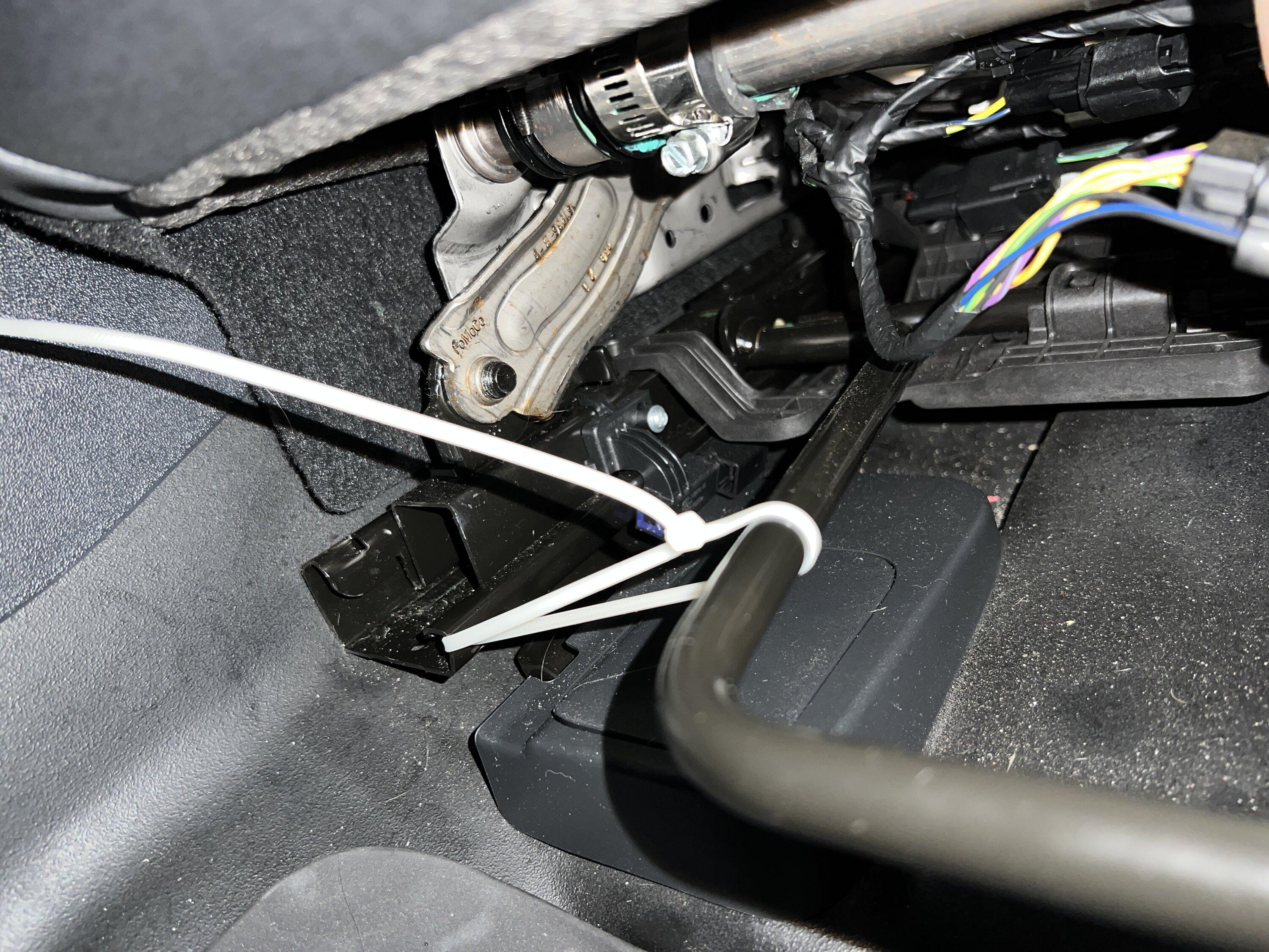

I think it’s the manual lever to actuate the forward / back seat adjustment. I zip tied it down to hold the track and lever in place and noise is almost gone
