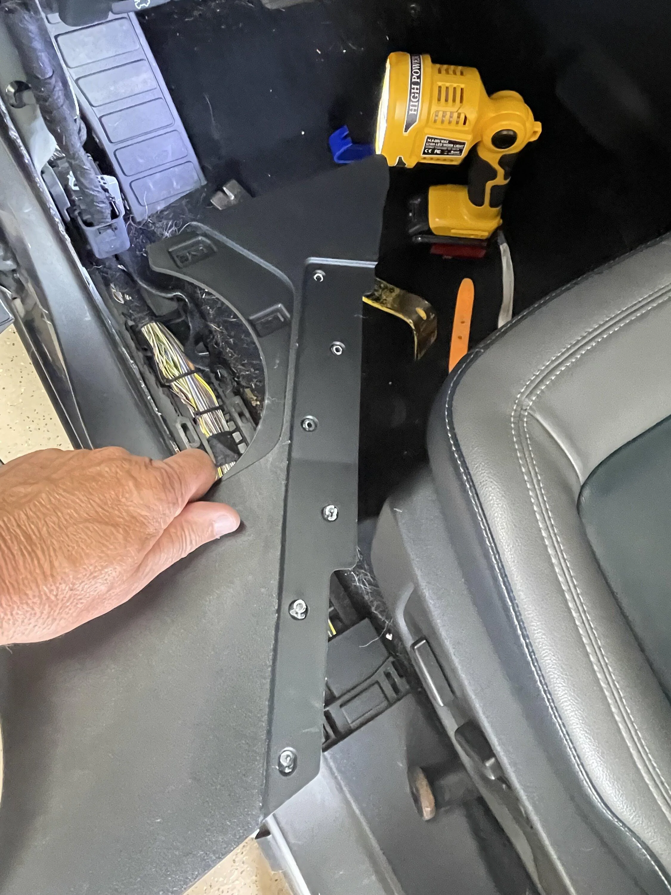

Hey all,

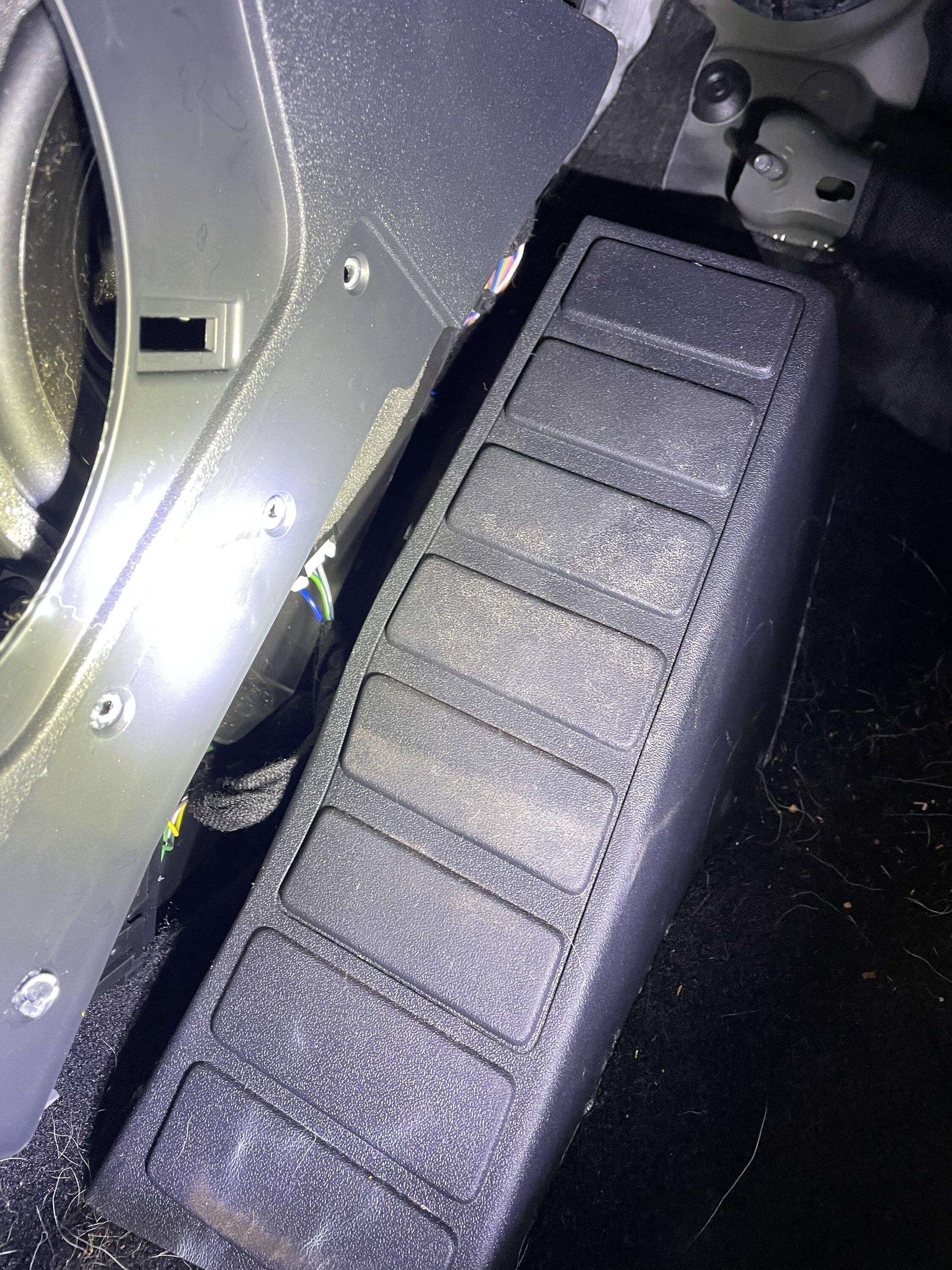

I couldn’t find anything about removing the driver side kick panel. Due to the foot rest it just didn’t want to budge and I really didn’t want seriously bust anything. Well I figured out a way to get the kickpanel out while leaving the foot rest in. Just a simple process of busting the welds between the two pieces of plastic, this will allow the kick panel to be reinstalled and you won’t know the difference.

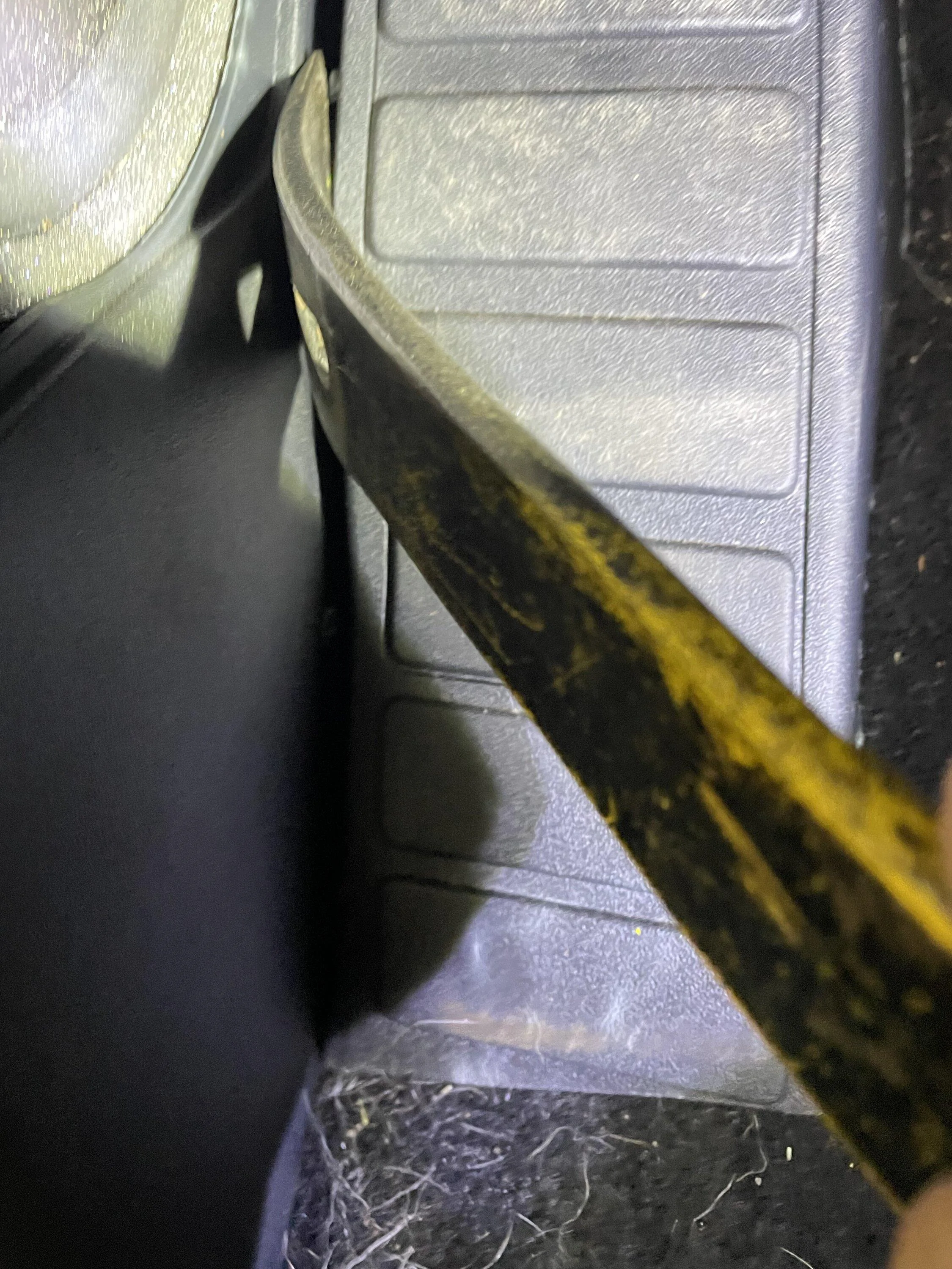

Slip a pry bar between the two pieces of plastic working your way from the bottom to the top and snap the welds.
Ford Bronco Driver side kick panel removal IMG_1825
easy

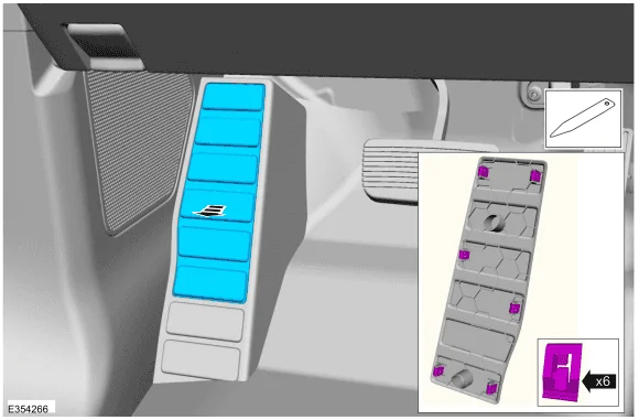

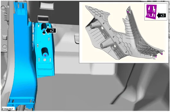

What manual do you find these in? They are a great help when doing things?
These images are out of the actual Ford workshop manual.
