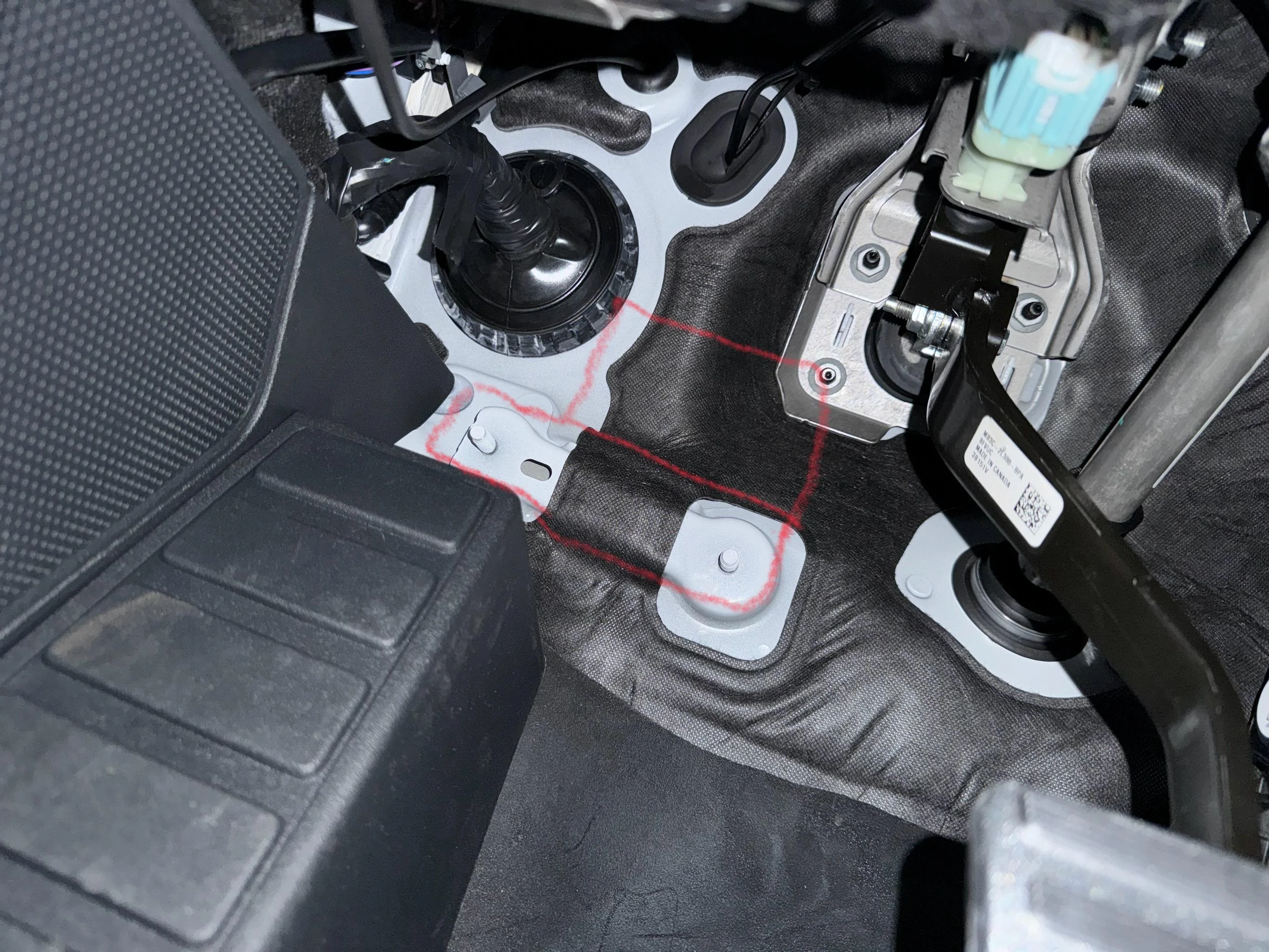

Does anyone know the thread size of the two white bolts in this picture?
Ford Bronco Driver’s Side Bolt Size IMG_0678

I’d guess m8 1.25 since that seems to be the size of most of the bolts but can’t say I know for certain.

They are apparently the mounting bolts for a clutch pedal assembly. They are definitely metric, M8 sounds right. Nuts are cheap (unless you buy them from Ford) and you can always use them elsewhere-so get some M6 through M10 nuts and use the ones that fit.
I cut a ~4x5”plate to fit over the bolts and mounted a Yaesu FTM-400 radio base unit to it. Fit is perfect. You have to mount the base at an angle to avoid interference to brake pedal bits. Regrets to you MT owners who don’t have this option 😁

Thanks! That is exactly what I am doing for a Yaesu FTM-6000R head unit. 3D printed bracket.
