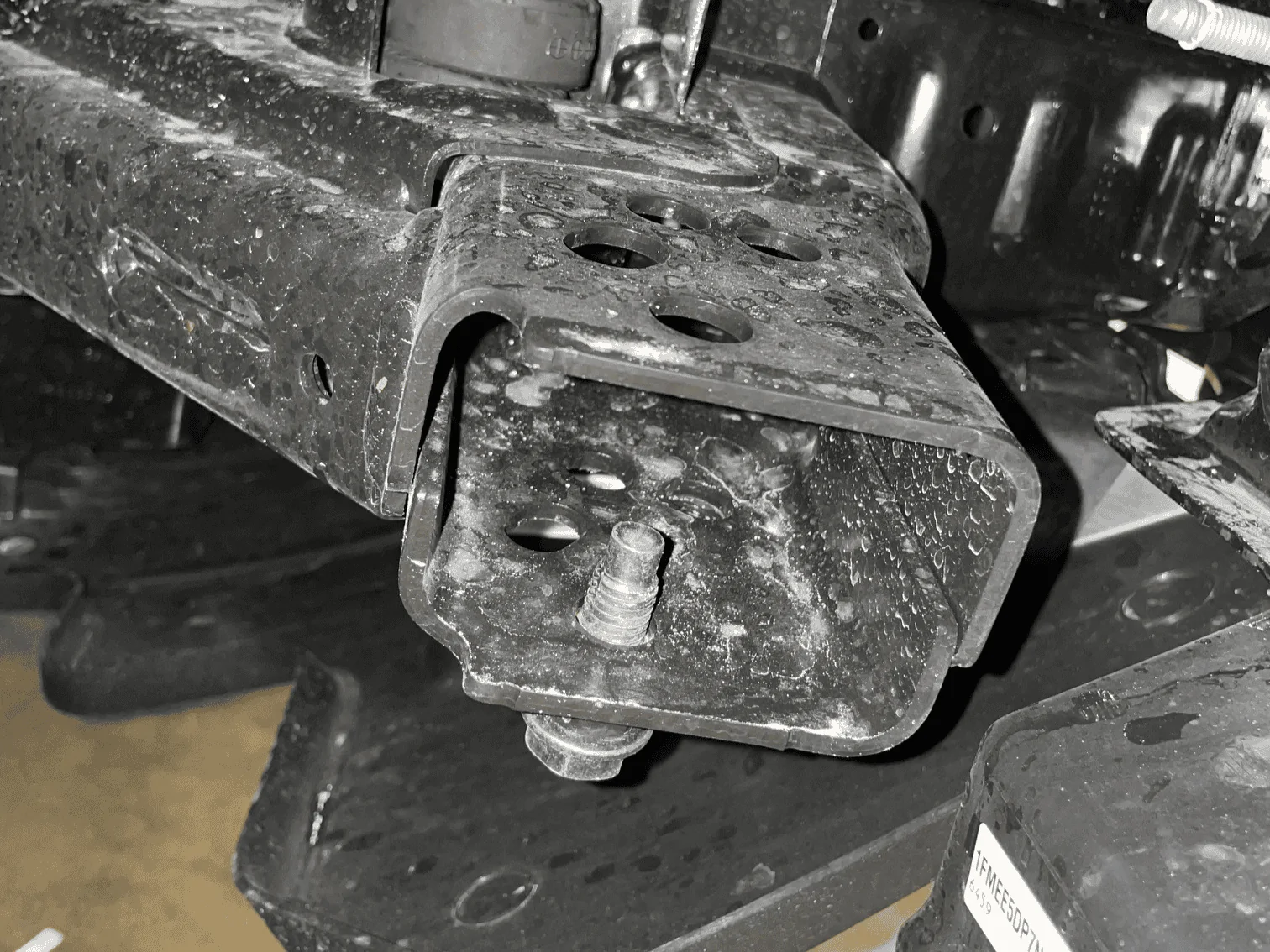

My 4/4/22 blend WT came with some variety of bolts, but they were far too short to engage both the top and bottom surfaces of the crash bar "socket," and only one bolt was present in each position:
Ford Bronco Crash Bar Bolt Size? 1674853454754
Edit: Just a heads up to @BlankSpace when you install the proper bolts, they go in from the top. If you can see, the two halves of the crash bar "socket" aren't welded, when you bolt through it is compressing the halves around the crash bar. Also why the crash bar kits come with bushings, you want to compress the frame socket closed but not displace the bar itself.

Thanks all for the responses. Really appreciate the tips.
Mine also came with the stubby bolts affixed up through the bottom. and with the clearance, looks like I’ll be breaking out the torx soon.
